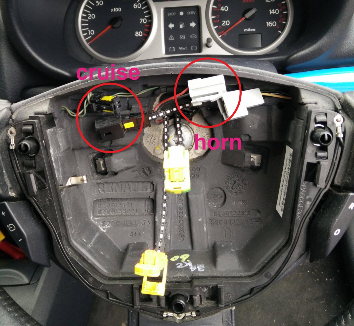

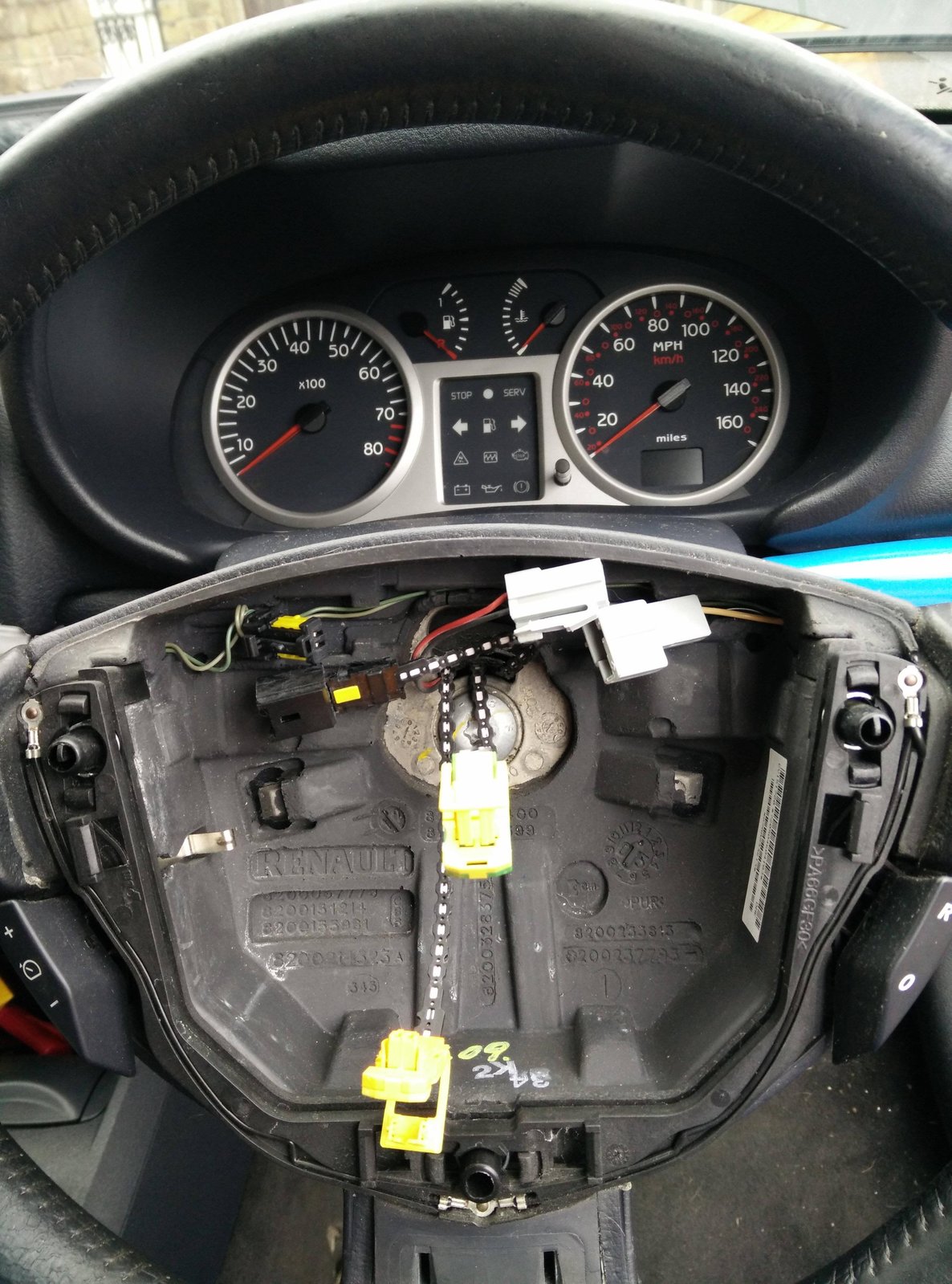

also, which one is the horn?
welshname
The angle sensor is that black curve shaped bit sticking out just above the bolt. Try and keep that on the top and don't let it spin either way, needs to stay central at the top

Wires: I have no cruise control so all I have is 2 airbag wires and the horn.
To remove airbag light you will need 2 x 3.9ohm resistors. 37p each from maplins.
Place resistors in either end of airbag connectors (see vid above)
Tape them up well. You can connect the battery now to see if the resistors are working. If not, they need to be pushed in all the way so double check.
Black and Red wire is the horn.
Depending on what wheel you go for will determine what you do with the horn.
Mine had a horn button so I connected the wires to it.
If no horn you will need a PH1 stalk.
