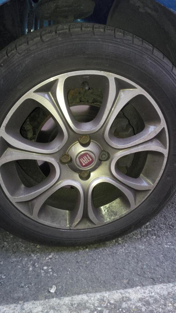

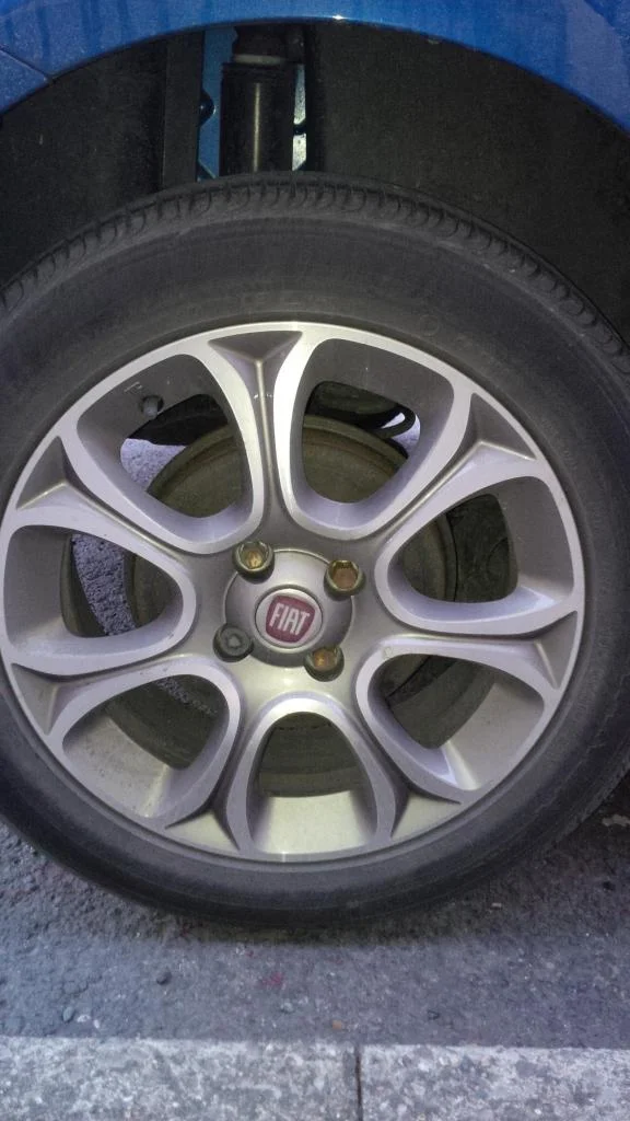

T'other halfs Punto has these alloys on. The fronts are a diamond cut finish and the inners a rough/pitted surface(quite normal) Would Iron-X/Trix or the equivalent b****cks up the Diamond cut front? I want to get them back to clean/new as it does detract from the look of a 10plate car!

Rear(How they should be)

Theres 30k miles of burnt on brake dust underneath salt on the fronts!. They have a horrible brown tinge even after a good wash.
Ah didn't realise you had already cleaned them once.
As said, that little lot mixed together should shift it bud

Im no chemist but I wouldn't want to be mixing chemicals together.
I'd be hitting it with a gentle wheel cleaner such as Autobrite very cherry wheel cleaner and then go at it with iron x, then have a go with a tar remover, clay, polish, IPA wipe down then either Gtech C5 or cquartz to seal all your hard work in.
Gally
Yeah that's not a good idea nor is recommending G101 on diamond cut wheels. It can be used but i'd never recommend it.
You need ironx anyway and it's PH neutral. Maybe something like AutoFinesse imprerial and you'll need a decent brush to get to the inners. :)

I haven't got round to washing the cars yet. I'll go with the gentle approach this weekend.
