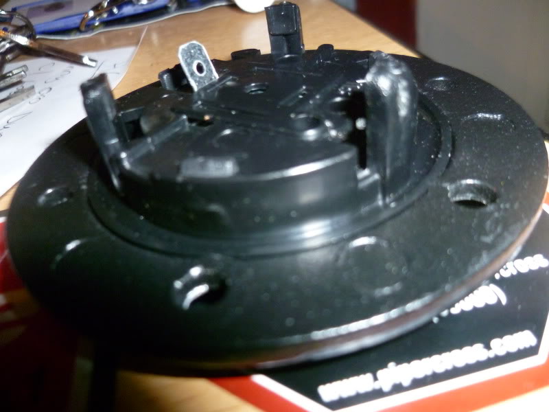

Right ive searched but to no avail on what i really want... ive bought an aftermarket steering wheel, the centre horn piece has a + lug to connect to but their isnt an earth on it? any ideas on how to wire it all up correctly as i dont want no fires :rasp:

one mate, the button you push touches a contact point with a lug on it i presume this is + ?

Theres a pic of the one connection point, dont really want to change my stalks to be honest will

They are a PAIN in the ass to fit - they earth through the steering wheel
But the times I tried to get that to work on the clio it did actually result in fire LOL
You can get normal horn pushes off the net that have 2 connections - just measure the hole in your steering wheel and buy another - it's a s**t load cheaper than an auto electrician
