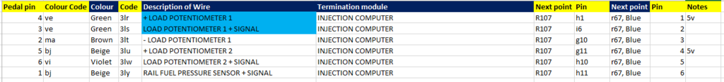

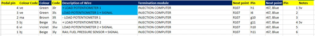

I saw a car with this the other day, the car is in limp mode and probably has the coil type light on the dash. The FBW throttle has two tracks which do the same thing but act as a fail safe, you need to know which track is not working and then go from there.
Hopefully this should help. Check for continuity at every point of the circuit, starting with 5v on pins 4 and 5 of the pedal plug.
