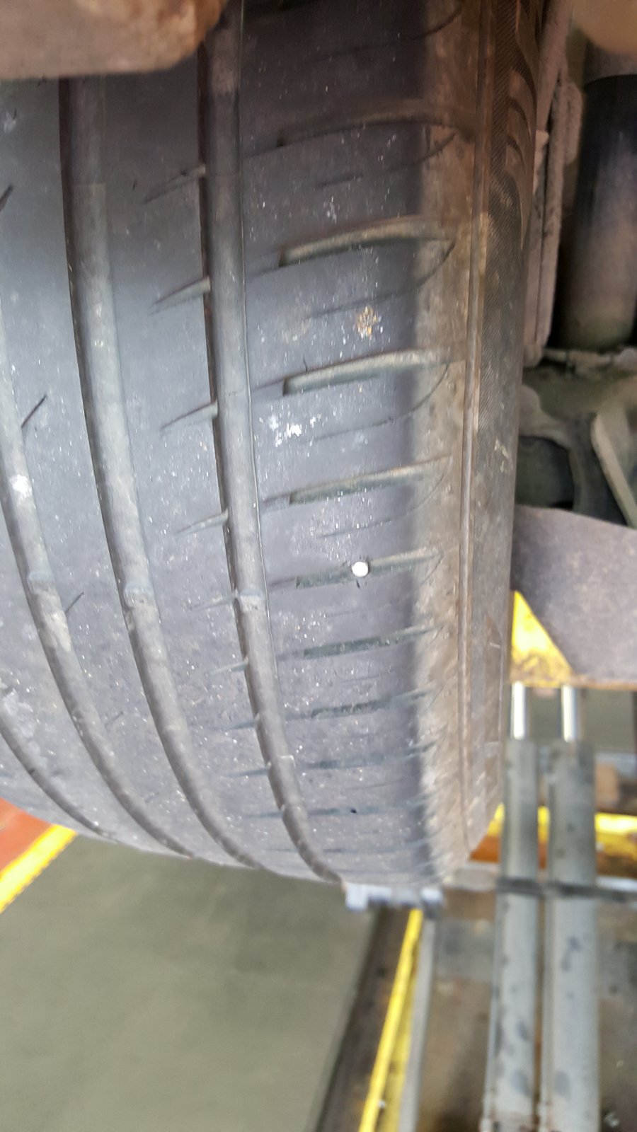

Would you say this tyre puncture is repairable?
Can this tyre be repaired?

As per title really. Apparently it's too near the edge to repair...I call bullshit...but tell me what you think

It's difficult to say. I think it probably is repairable. Has it went in at an angle and potentially hit the inside of the outside if you know what I mean?
Don
  182 & LY Clio 220 ed
Nope, straight in. If I was to say it's Kwik s**t you'd probably say it's fully repairable but they want me to pay out (it's a lease car but it is the principle!)

Pauleds
  Merc Dueliner sport
Most places won't touch punctures on the corners as quite often they still leak.
  182 ff/ 5 gt turbo
Too close to the edge to repair, by rule a tyre should only be repaired if the puncture is in the central 3/4 of the tyres tread.

Fair enough gents, I just thought Kwik s**t were taking piss in their usual manner...
