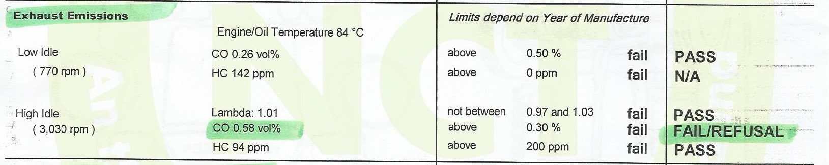

My shitbox failed the irish version of the MOT yesterday on emissions. It failed the high idle CO @ 0.58% above 0.30% = fail.
It got new oil and filter, air filter, spark plugs and fuel filter earlier in the week. It got a new cat last year for the test at 155685 miles. It now has 170588 miles
does anyone have any idea's as to what could be the problem?
