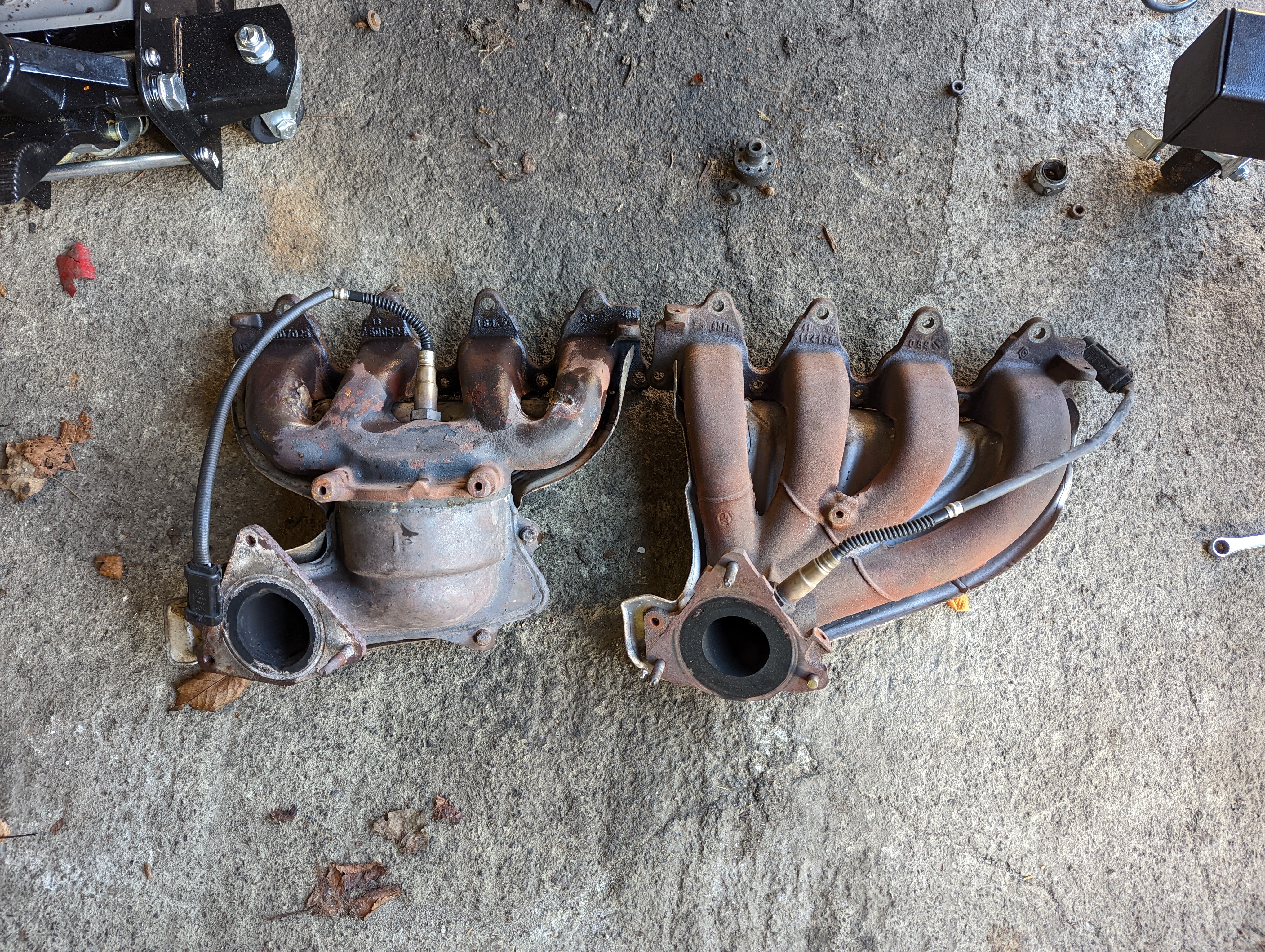

Staying NA and 1.6 there is a few options for cheap ish gains albeit small ones.
Megane exhaust manifold with no cat (clio one has a cat)

Mine is standard apart from the Megane manifold and in a light MK2 PH1 goes really well.
