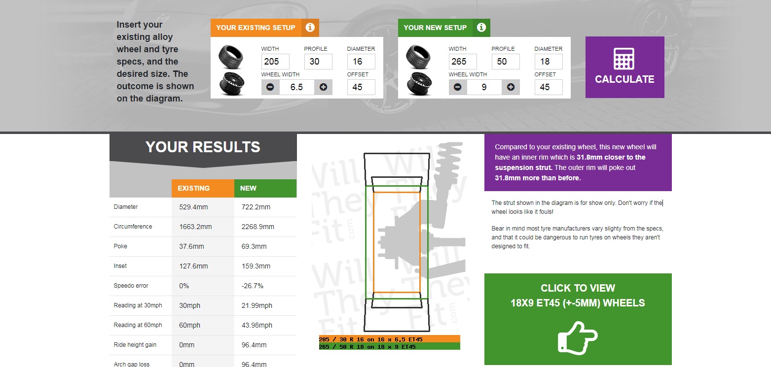

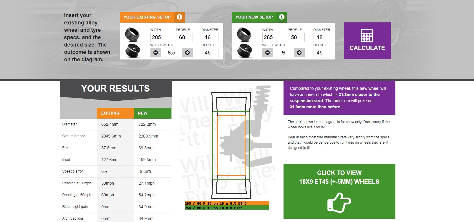

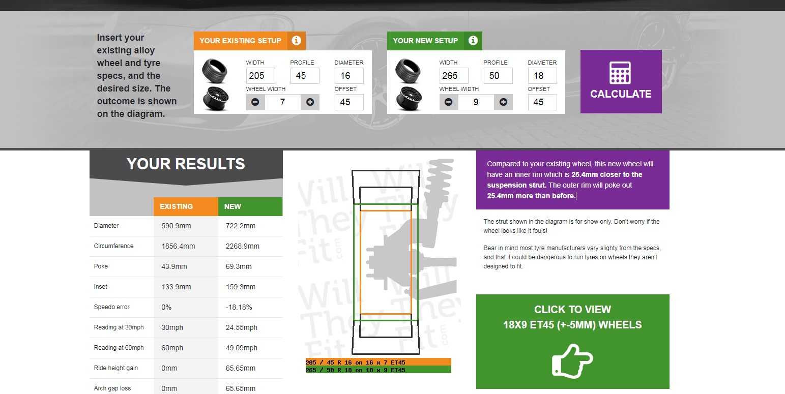

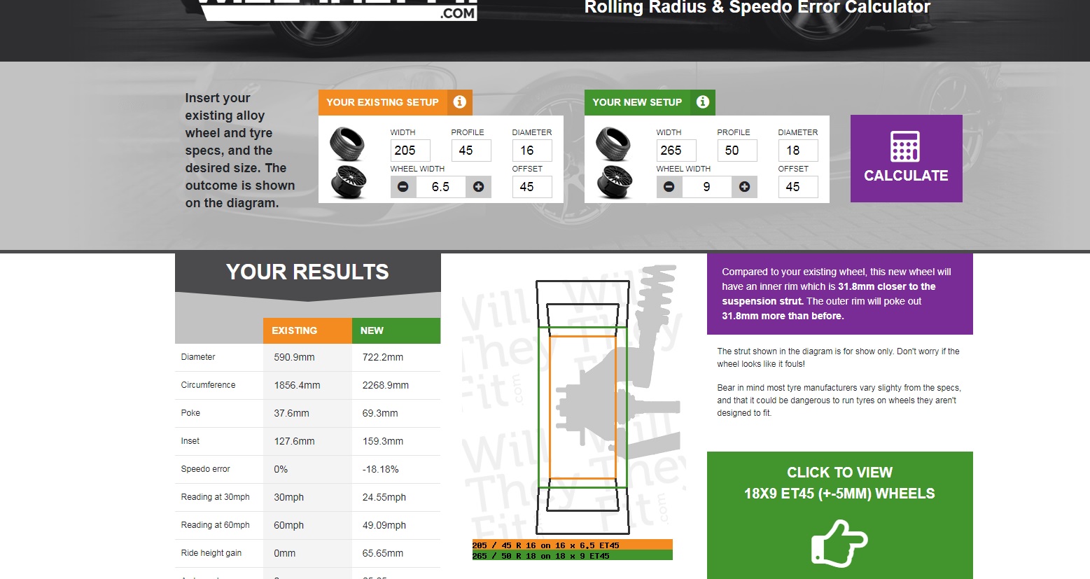

Fit or no fit is one but the way it will look is another matter. Trust me, it will look awkward on 6,5" rims, let me show you some examples as to why that is
This site is quite a useful tool, I encourage people to use it
So, see how the 205/45 tyres sits on 7" vs 6.5"? It's sidewall is almost straight - good fit
Ignore the other 18" wheel size, I just put it out there so the 16" wheel will be more visible
Now, look how a 205/60 tyre sits on a 6,5" rim- the sidewall flex towards the inside is less visible because of the taller sidewall and the fact that talll sidewall tyres are more baloon like so yea, a 205/60 would fit okish on a 6,5" rim,
Now let's imagine if a 205/30 tyre would exist (only for demo purpose) - see how the sidewall stretch to the inside is more visible?
I'm talking from experience, I bought long time ago some 15" rims with 6.5" width but the store mistakenly got me 6" wide ones, and when I fitted them to the 195/50 R15 tyres I had back then and they looked awful, told them to re-order and get the correct 6,5" rim - they looked spot on
Renault put 7" wide rims for a reason on the 1*2's (even the 172 ph1 has 7" wide rim with 195 width tyre!) would be a shame to go to the hassle of getting some wheels imported just to find them fitting the tyres wrong :(
View attachment 1722827View attachment 1722828View attachment 1722829View attachment 1722830
Thanks so much, this site is quite useful..
