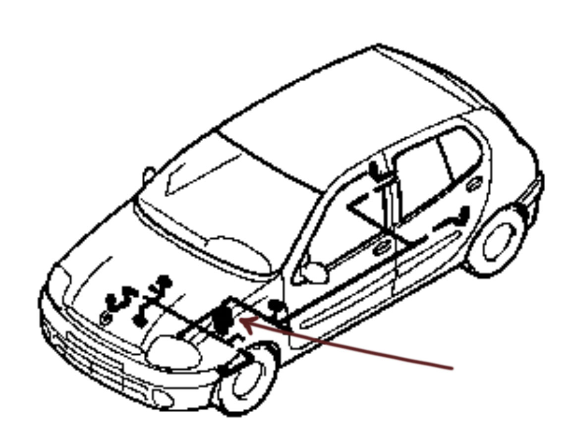

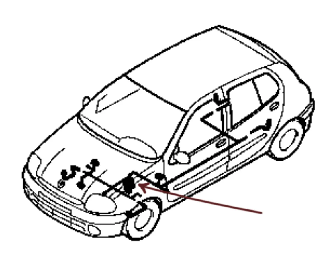

That's link is helpful thankyou, where is the abs pump on a 172 ? Would it be obvious in photos ?
Mr Underhill
Just behind the front passenger wheel arch - see arrow.

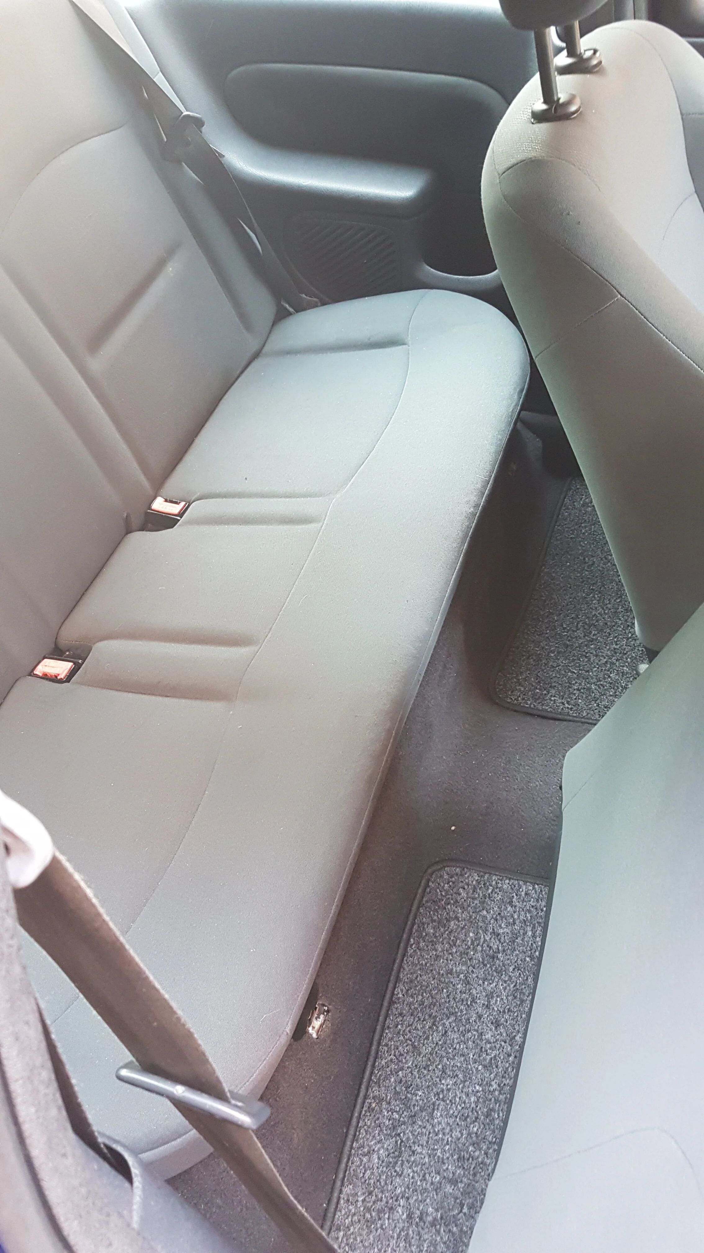

16v_paddy
  Valvers & 172 Cup
A big obvious difference is the back seats, there is only 2 seatbelts in a 172 Cup, all other Mk2 Clio's have 3 seatbelts with the middle 1 being attached at the roof
