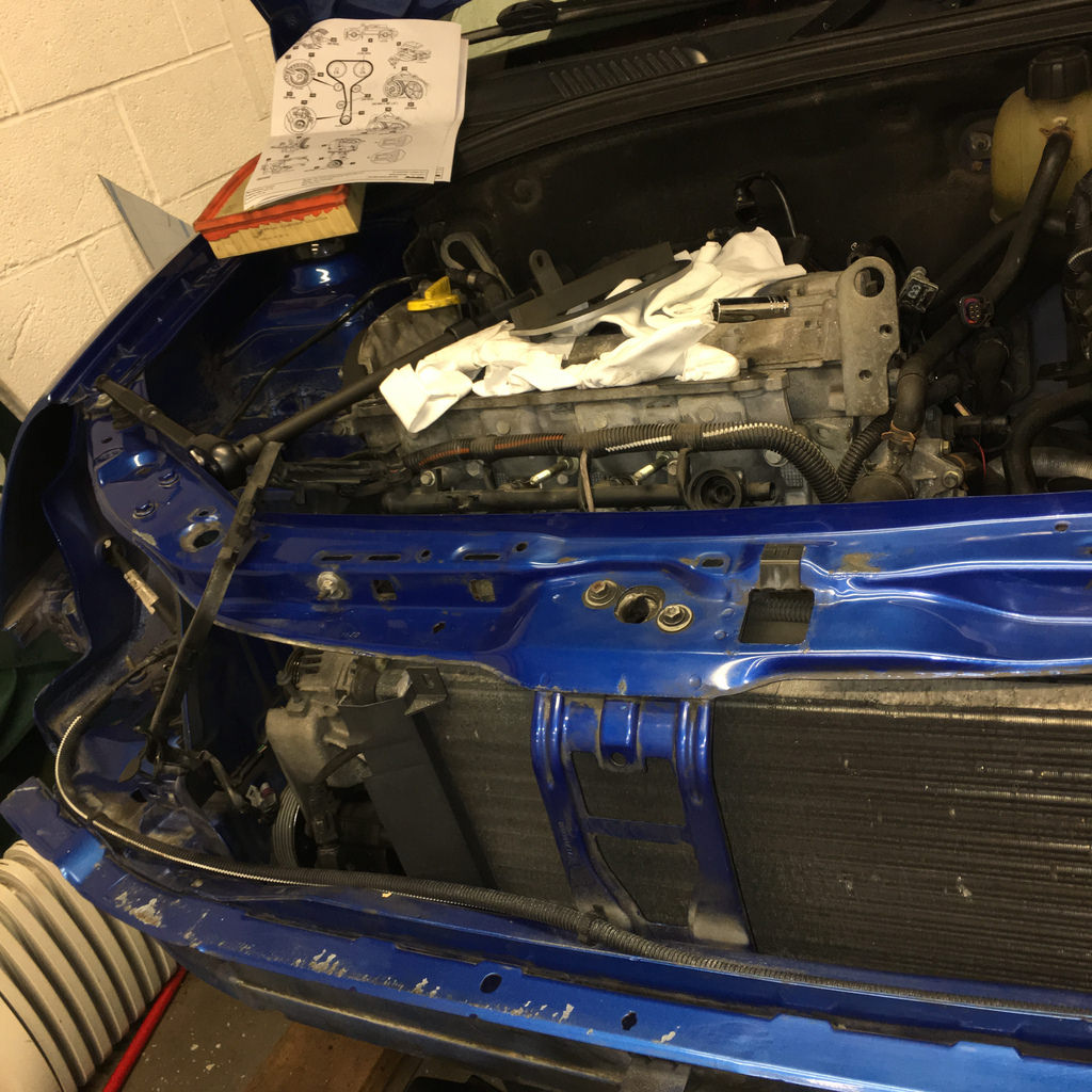

Having got my timing tools today, we popped the caps to check the timing - and straight away could see the issue - and the cams are out of time. So we have begun stripping for a new belt and retime it.
Having done our 182 twice now, I am amazed by how much access there is in the cup thanks to the lack of aircon.
Stripping

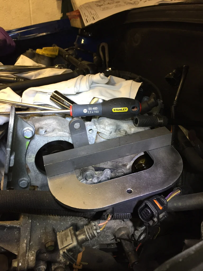

With the crank pin in place and trying to fit the horseshoe locking tool - I think it’s clear this is out! Amazing that it runs really!

are you 100% that you've got the locking pin right in the crank?
We have gone round at least 2 rotations of the crank to check for alignment (and done so twice!) - and this is the position where the crank pin goes in and that both cams are sitting with their slots below the centreline, so am confident it is right - just miles out! Will do a triple check on the TDC marks before we take the belt off to be sure, but I am amazed it ran at all with the cams so far out!
easy to either miss the hole completely or get it in the balance drilling. the tdc mark can be a pain if you look at it on an angle as well!!
If the timing is that far out you should notice the severe lack of power tbh, plugs out and cofirm your at tdc is the easiest and best option
Thanks for the comments - and double checking (before we remove the belt and risk breaking anything!) I think that we have been using the wrong crank pin (2 supplied in the kit - we had been trying the threaded one, which it seems is wrong) - so will rectify that and check we really are at TDC. I am sure that the cams are out as they don't align at any point in the rotation - but possibly not quite as dramatically as they appear in the photos above... will report back when we get back on it!
Good news - we double-double checked tdc and the cams were still out - and the cam pulleys were also out relative to each other - so with the new belt kit fitted and timing checked half a dozen times we have built it back up and I am happy to report that it runs sweetly (we only ran it briefly for a few minutes due to the time, but it is clearly vastly different to how it was before).
