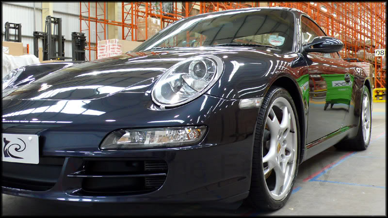

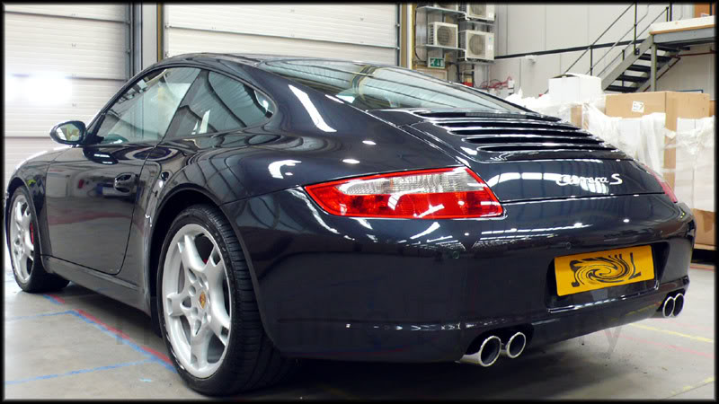

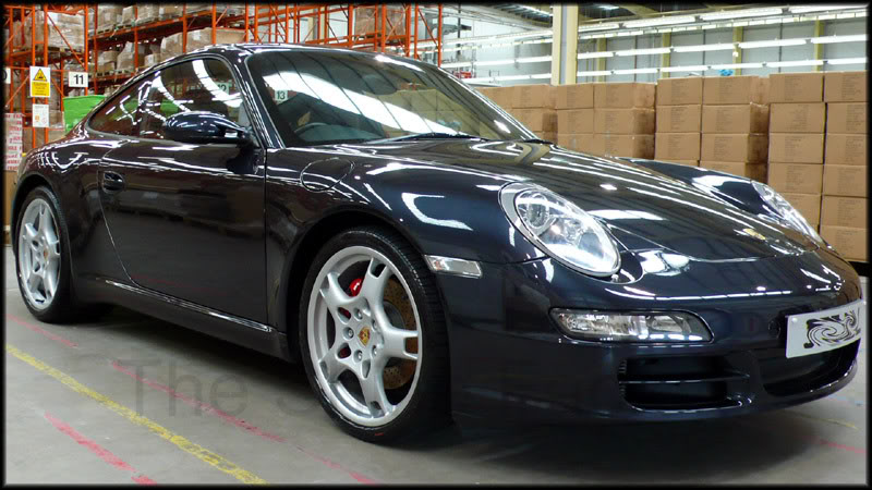

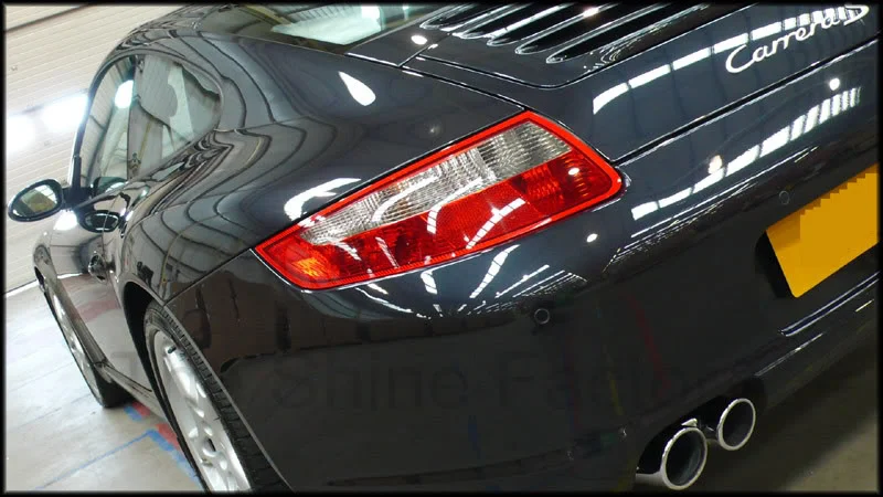

The Car
My second porsche 997 in a week!! Joined this time by my Kosovan Friend who from heronin is called Kristian;) Some of you may recall the backdrop where the tag team detailed an M3 CSL exactly a year ago to the day!
Paintwork Evaluation
Required a heavy clay due to iron filing fallout, looks to have been stored near a railway line at some point in its life - check the bottom gallery! More severe swirls than the turbo I detailed and numerous random scratches. Paintwork was medium to hard rather than outwardly Jack Bauer like some Porsche paintwork can be.
A 50:50
And spiders on the roof before
And After

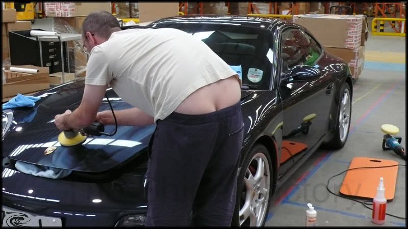

I still haven't paid Kristian enough yet to buy new trousers;)
Full Process
  • Wash with megs shampoo plus
  • Wheels and arches washed with megs APC and Super degreaser and shampoo plus!
  • Paintwork rotary Polished with megs cutting and polishing pads and 3.02
  • Paintwork PC polished with Po85U
  • Premium paintwork cleanser
  • Premium marque specific wax
  • Klasse AIO and rim wax on rims
  • Megs NXT Polysh on Exhaust tips
  • Blackfire Tyre gel

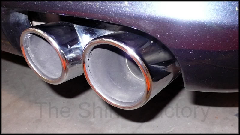

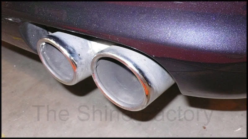

Exaust tips before
And After

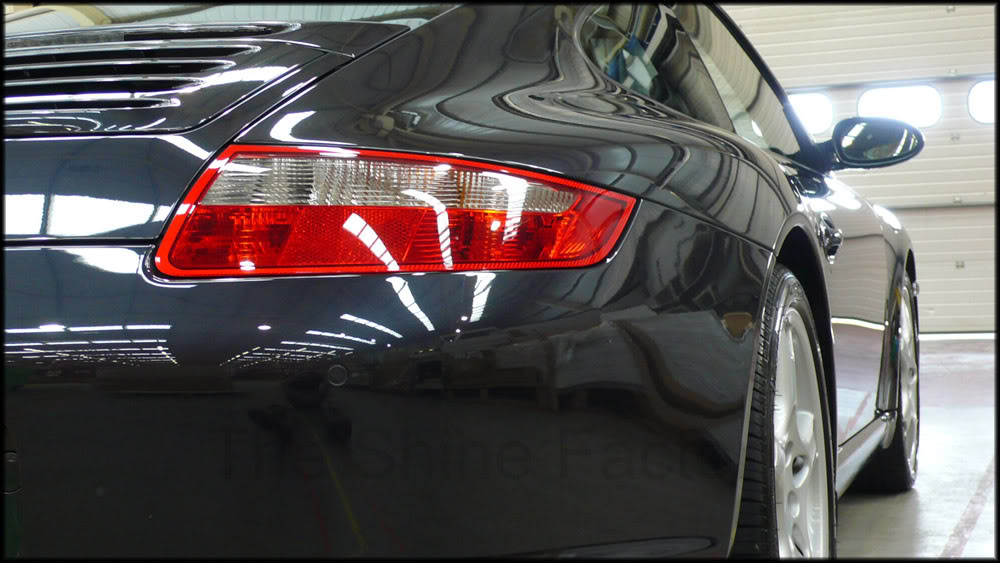

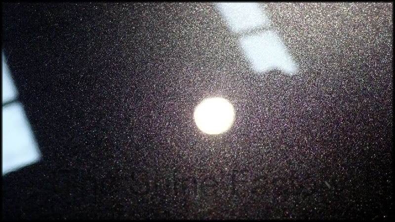

Brinkman shots

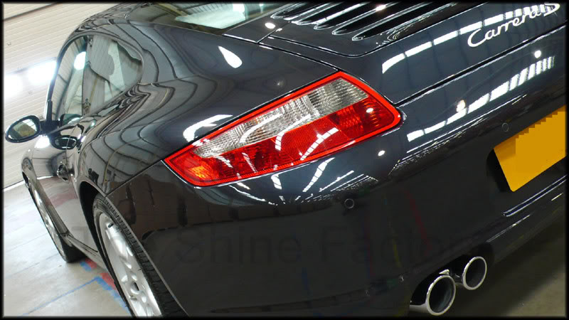

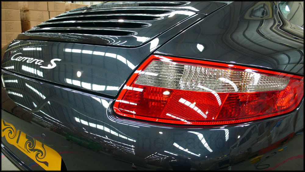

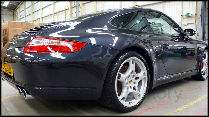

Some Afters

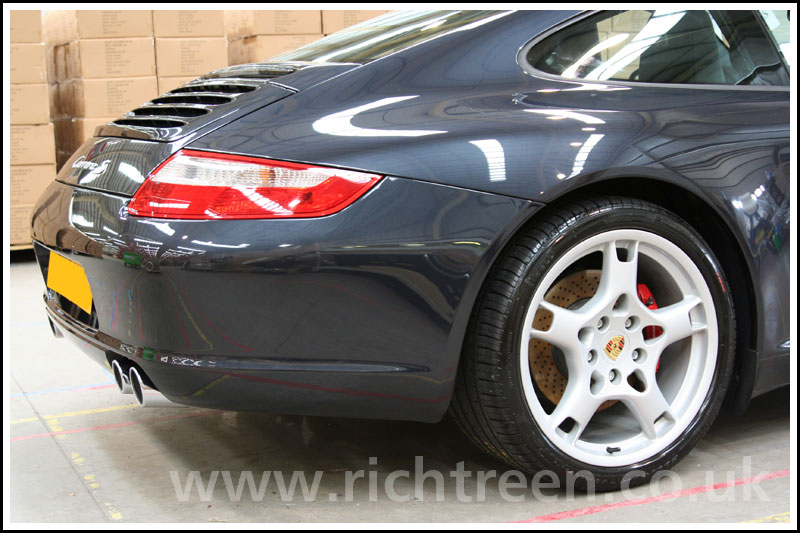

Thanks again to Rich, sorry Kristian ;) and here are some more pics from Rich's archive! Worth a look to see the clay bar with iron contaminants!
http://www.richtreen.co.uk/images/porsche/
