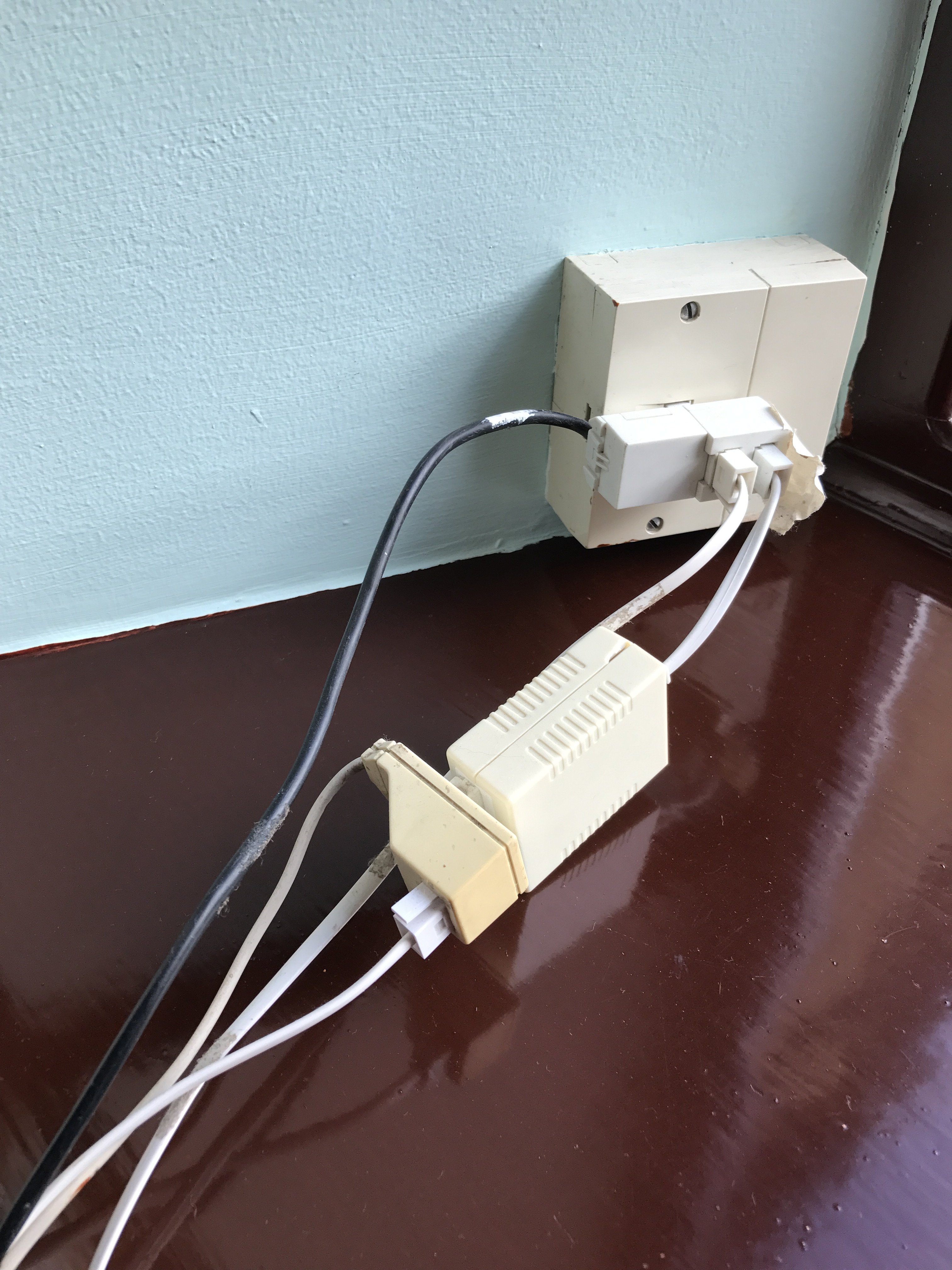

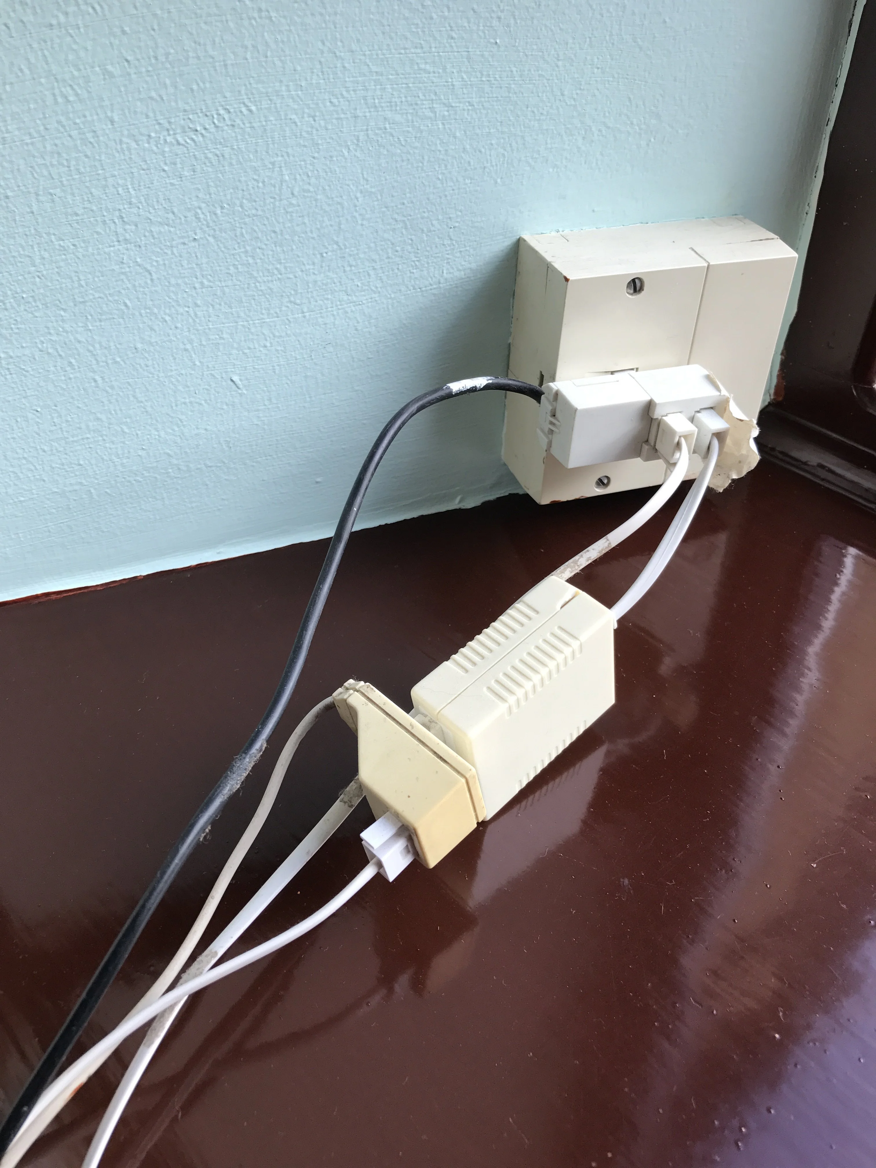

IMG_0508.JPG This I believe is the master socket in the dining room downstairs.

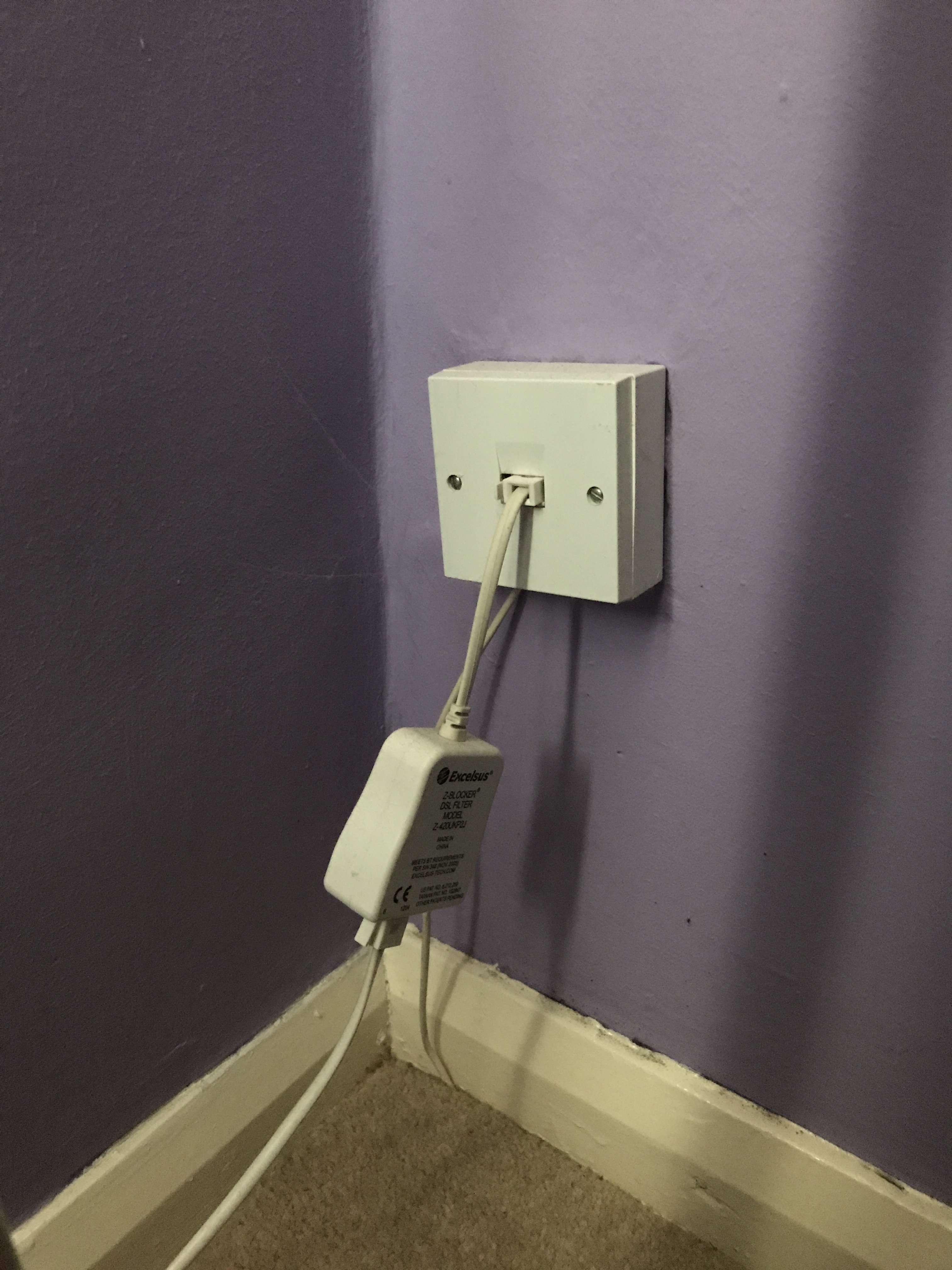

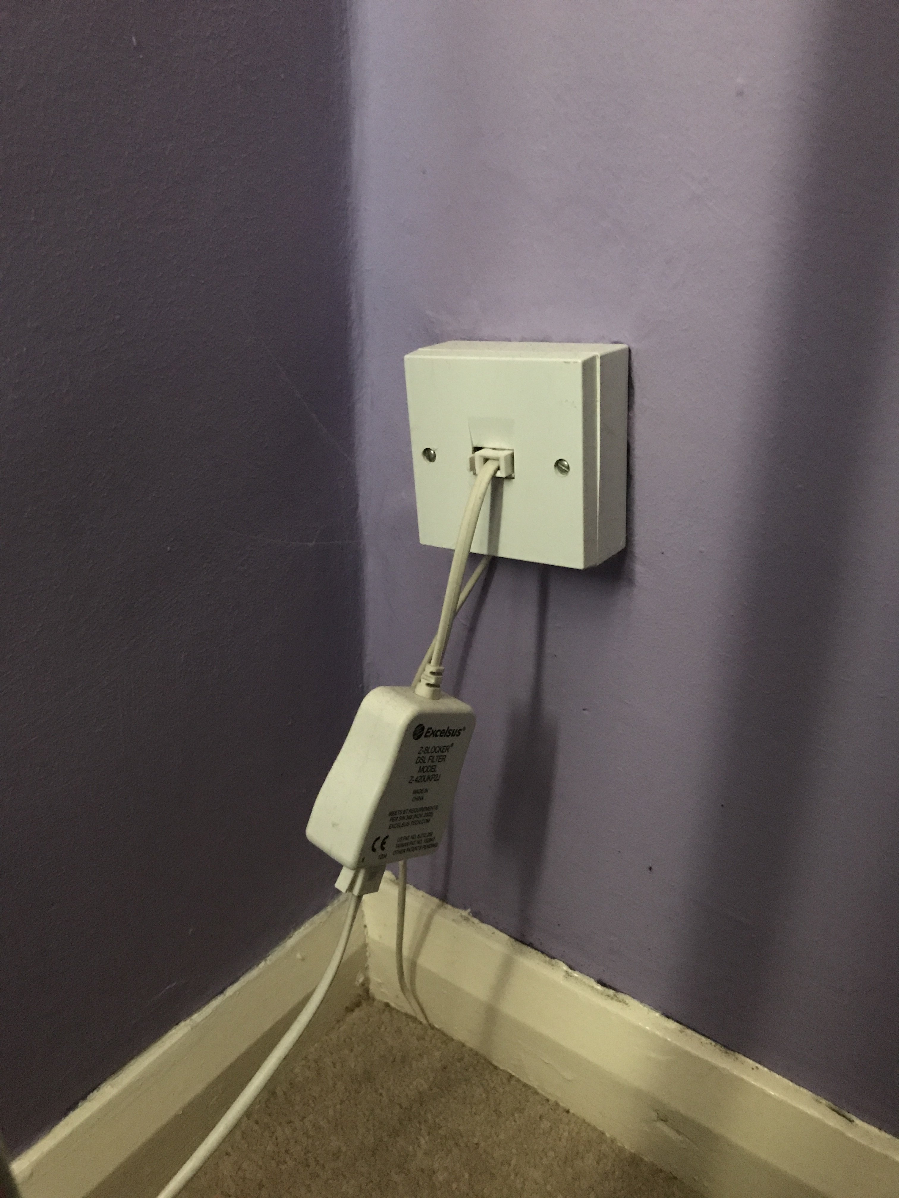

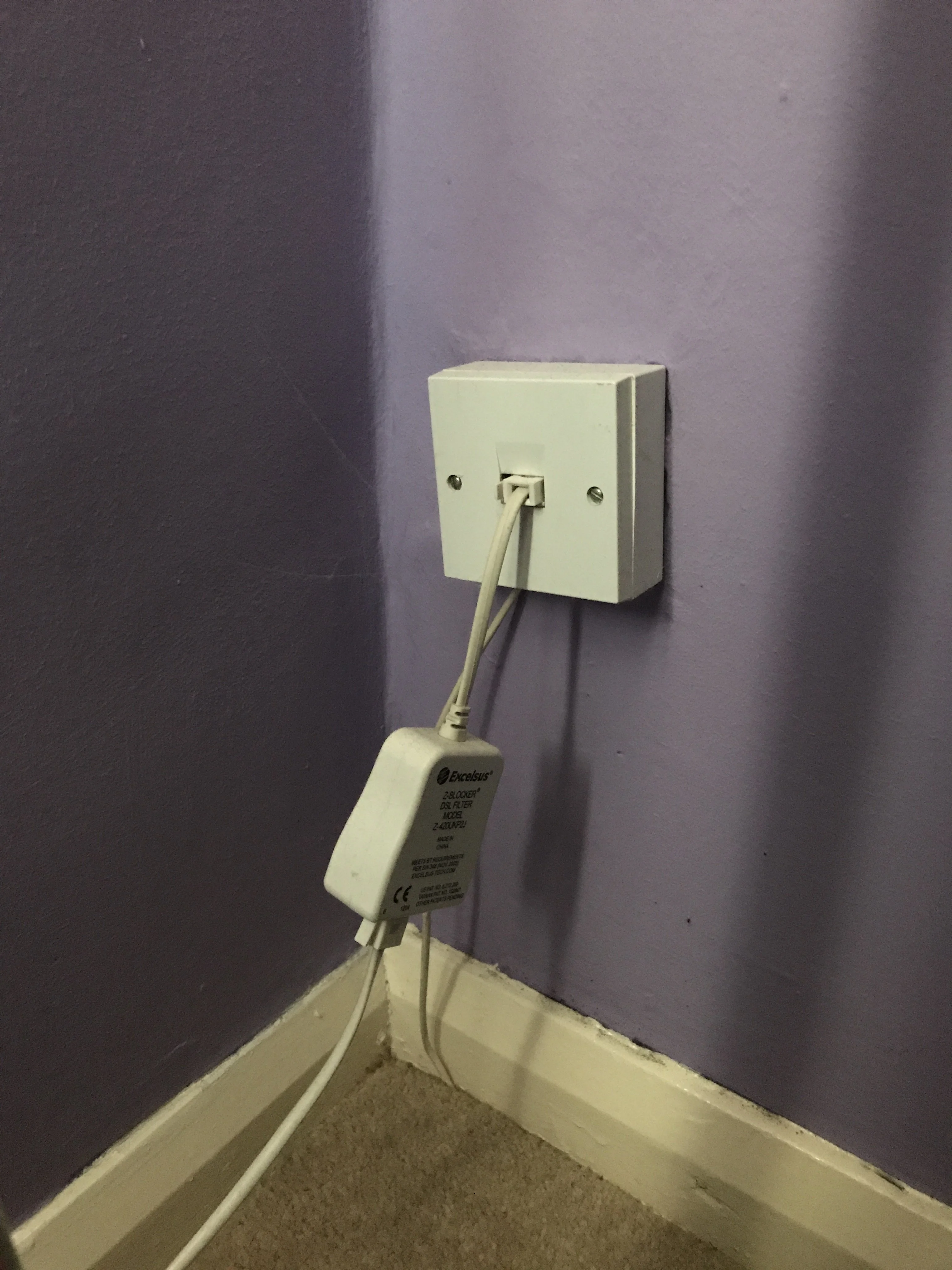

IMG_0507.JPG This is what's in the room upstairs next room to where I am and where the router is. The cable runs through the wall and outside and to the master socket.
There's wall sockets in another 2 rooms in the house and one with a white ADSL filter.
So by what yous been saying the engineer might not pop inside and sort out the cabling even how old it is.
Rystar
  2003 Clio 172
At best they'll stick a new faceplate on the master socket for you, possibly even one that splits the ADSL RJ11 plug like below;
You've got an awful lot of stuff T'd off the master socket there, you running like 3 corded phones or something?

Yeah the wiring is horrible in the house. That socket might be a good idea like.

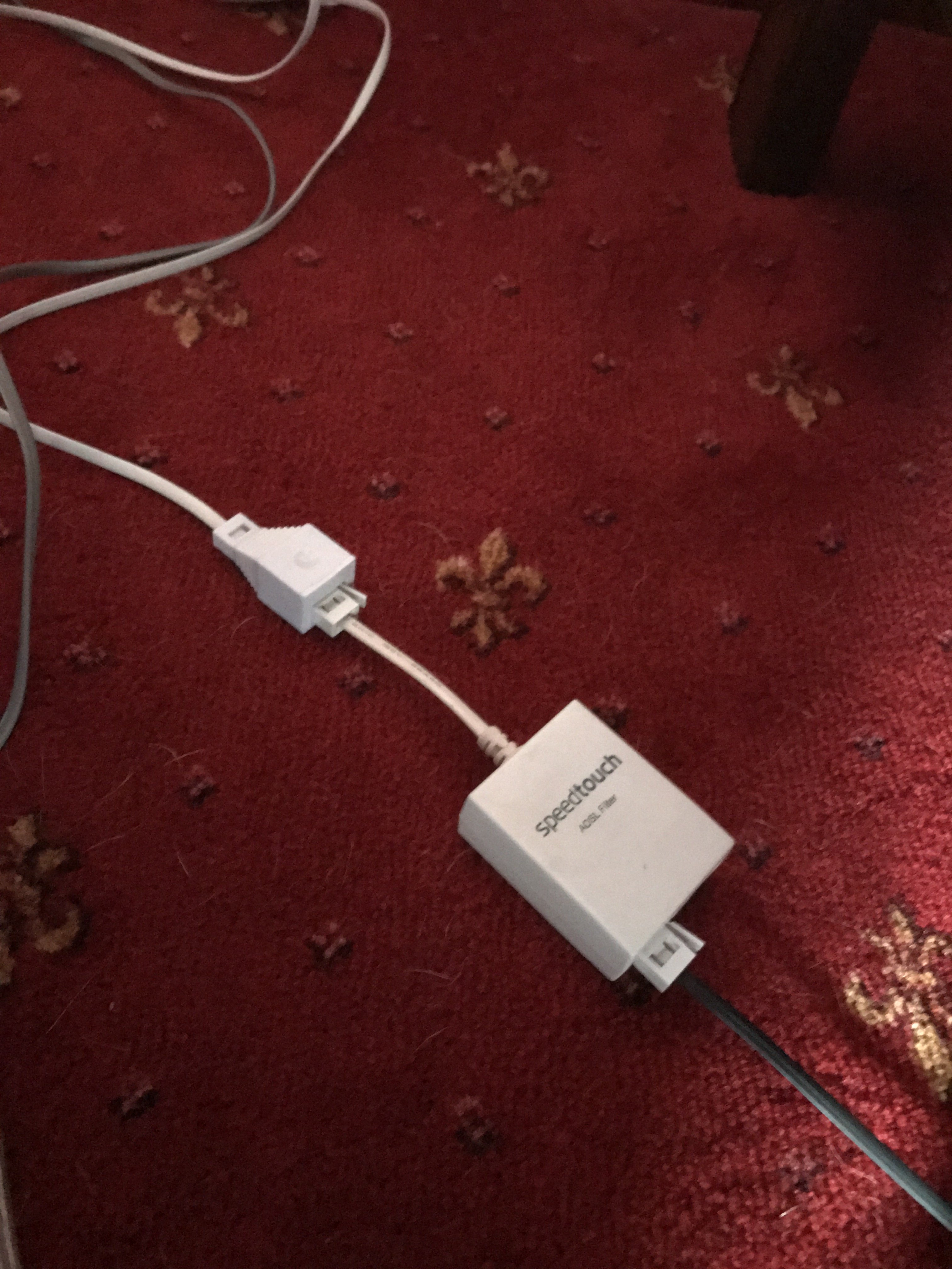

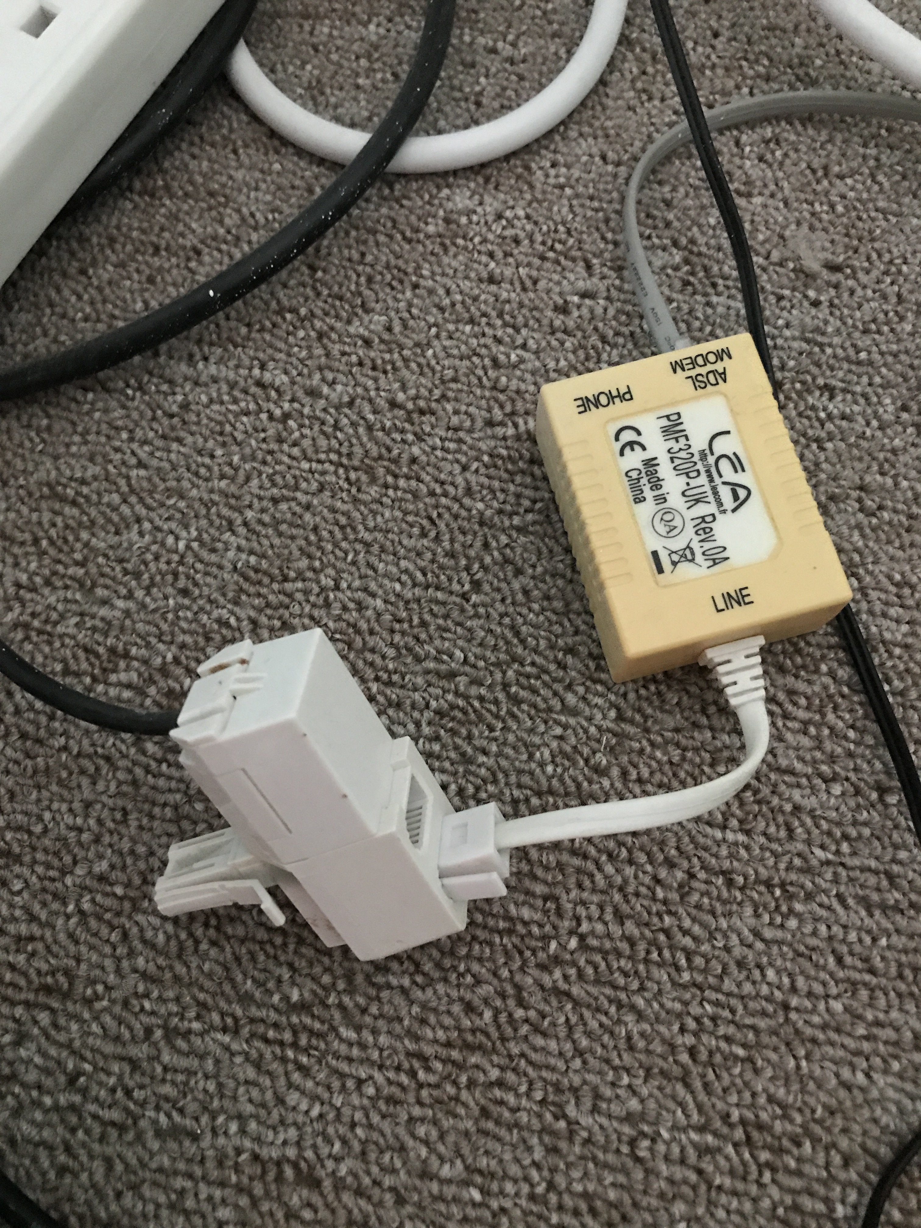

Yeah there's 2 cordless phones in the house. One in my room, here's a pic of the socket
The other is in the living room downstairs here's a pic of the set up.
There's a phone which is non cordless in the dinning room right next to the master socket. I believe the white wire runs to the master socket itself.

If you fitted a filter in the master socket itself, you'd negate the need to have all those filters every time you plug something else in.
If you didn't mind splashing out a little, One of those cordless phone setups with three handsets (where you have a master base that plugs into the phone socket and the rest just need a power point) would tidy up most that wiring in an instant. Meaning you could have the base station where the dining room corded phone is. Plonk the other two 'slave' phones roughly near the other cordless ones wherever there's power. Then all you'd need to do is run an RJ11 ADSL Cable up to your router/modem. But thats all getting a bit off topic haha
