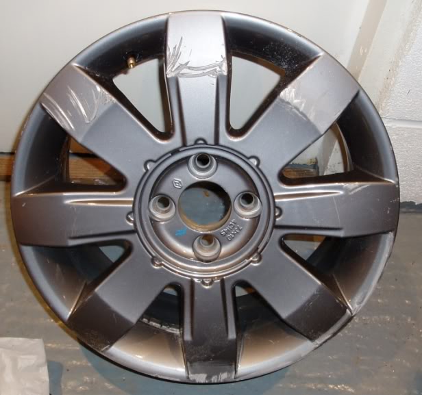

im refurbing my wheels and im wondering whats the best shade you guys have used?
im not wanting them to be 2 dark but a nice shade
suggestions please

look good,did you do them yourself?how did you manage to do the lip without marking any other part of the wheel?just taped it up?
  172 ph2
yep did them my self,i flatted the rim untill it was bare metal then got the wheels ready for paint then using fine line tape i masked around the edges and taped them off,then polished using metal polish.
  172 ph2
no mate because the laquer will just flake off,bare alloy needs etch primer so that would be defeating the object
