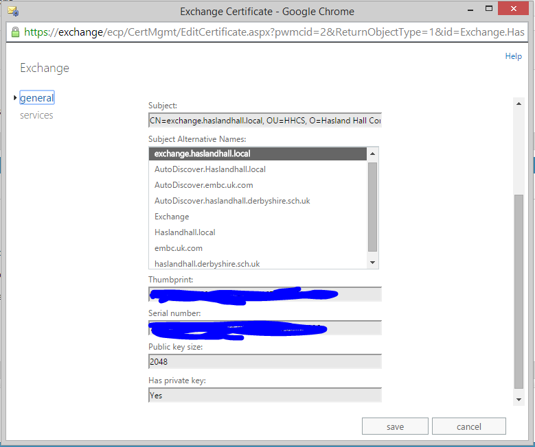

Does the CERT contain the external fqdn and not the internal. Both the internal/external names should be registered on the certificate

To me it looks certificate based and it is the wrong certificate that is installed/used.

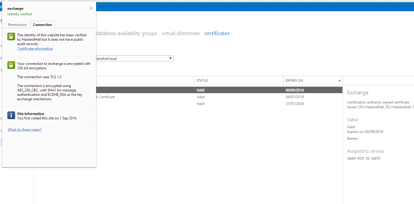

This is what my exchange server certificate covers;
Will have a read through that now,
