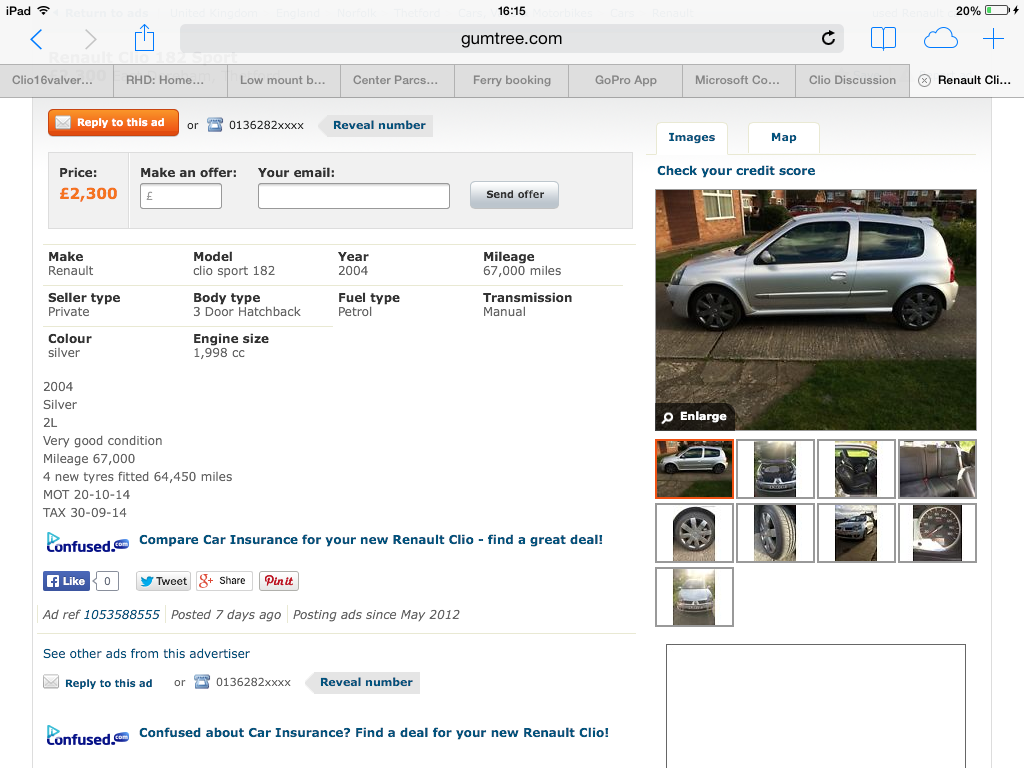

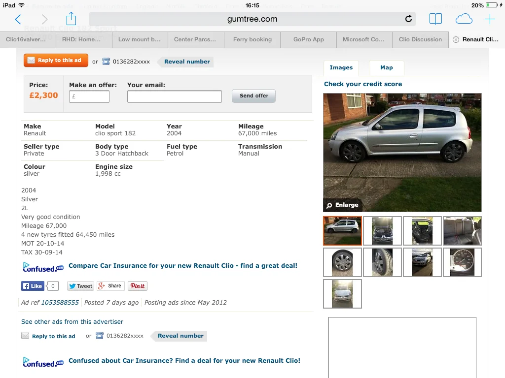

Hi all I'm looking to buy a 182.
Iv just test drove this one. It's not bad but does have a couple of issues. The main one being the front drivers side shock seems to poke through the turret at the top like it's not fixed correctly. What would cause this and is it easily fixed?
Here is the advert.
