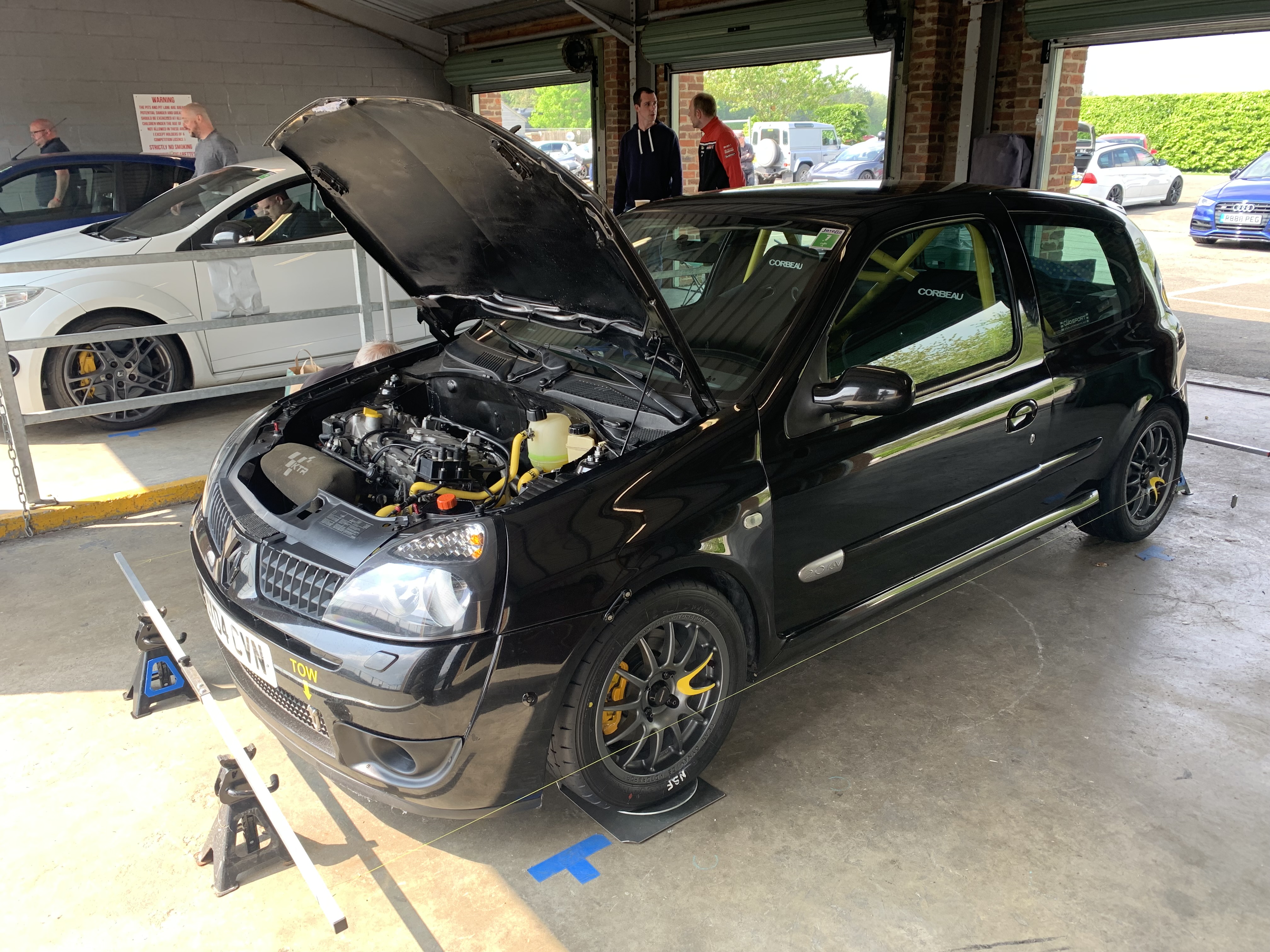

@SCB not sure if you’ve pressed the button on your suspension yet, but I’m happy to report you won’t be disappointed if you buy them.
A good friend of mine came to Croft yesterday and set mine up.
5100s, 90Nm front, 100Nm rear. Left a decent gap in the arches - don’t like them too low. Dampers set to neutral. Negative 2.5 degrees camber and 4mm (2mm per side) toe out.
I run a roll centre correction kit as well.
The handling was incredible!
Ran tyre temp tests all day and they were perfectly even. I run A052 tyres.
