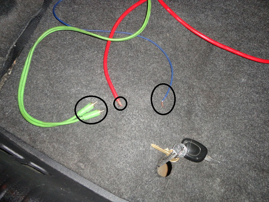

Anyone tell me what those 3 things are lol?

I'm getting that in a sec and want to just know the basics as i'm contemplating fitting it myself if the wirings half way done..
The lad whose had it before said he ran a 1k vibe sub with a amp and he left the wiring in will that sub and amp be ok to run?

red is power
blue should be remote from head unit
and the others are phono leads from headunit to carry audio signal to amp
you are missing a ground.

I think it could be chinese lol. Fail.... I'll have a rummage round and try and find the ground.. He said he had it on the break light -.- I think i would put it on one of the seat bolts or panels.

yeah i had mine on a seat belt bolt but there are other locations
