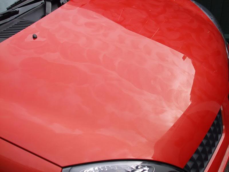

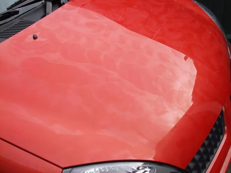

pic you can just make out egp on the bonnet! ;)
Straight lines not circles for waxes and sealants will be less visible if you cause any swirls or marring, if you can see it in pics it is too thick !
you think straight lines i wouldnt have thought that :S it didnt turn white and i hardly used any just kept putting the odd drop on to the pad and that worked for me! :eek:

It is so thin and watery it is easy to apply in back and forth motions.
Straight lines is the preferred method for most non abrasive products (waxes and sealants) where you don't actually need to physically work them.
When you see swirls on a car they are always in circular motions and look how back they show up as they easily catch the light, to avoid any risk of making marks that will show up as badly use straight lines.
