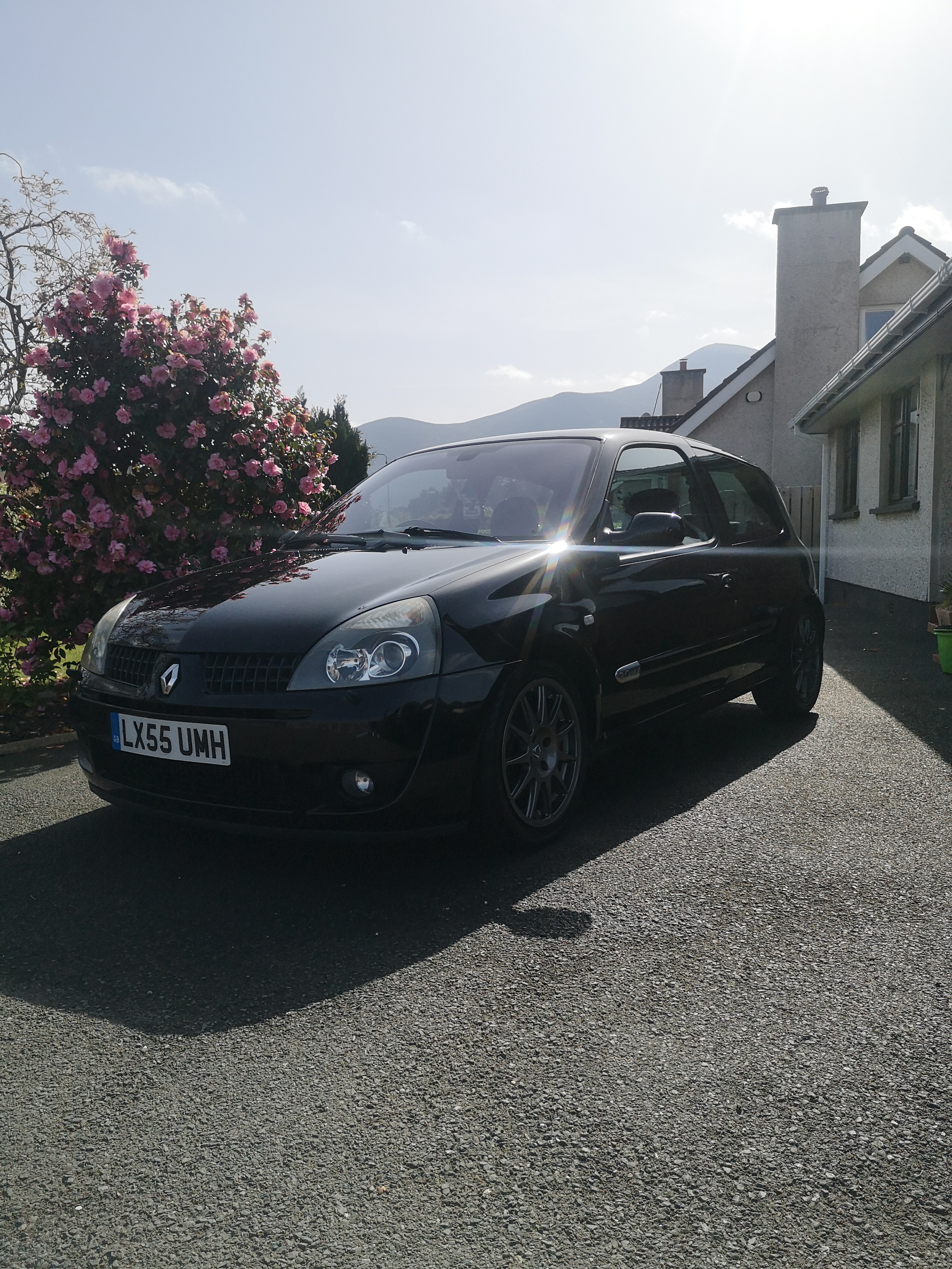

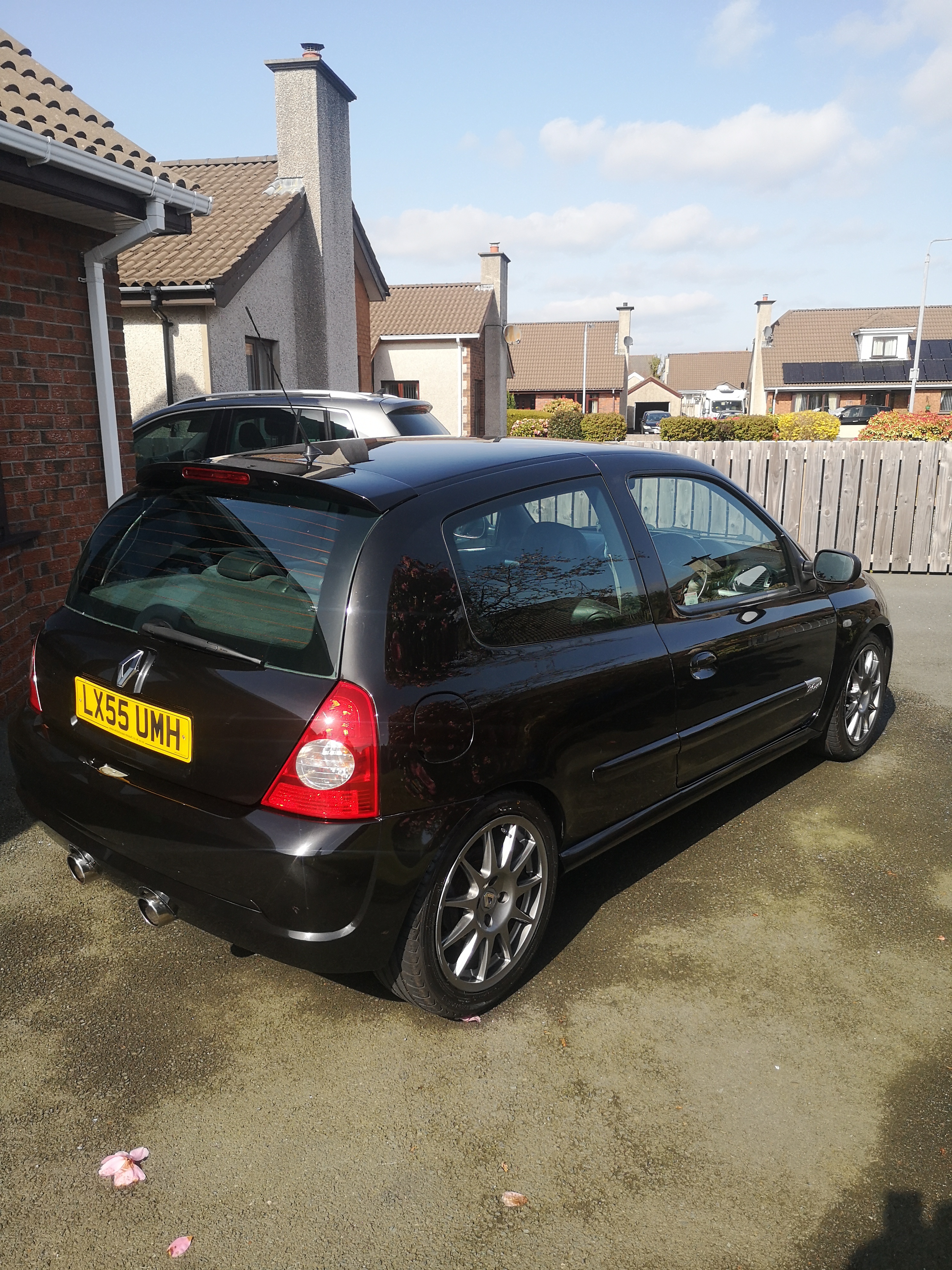

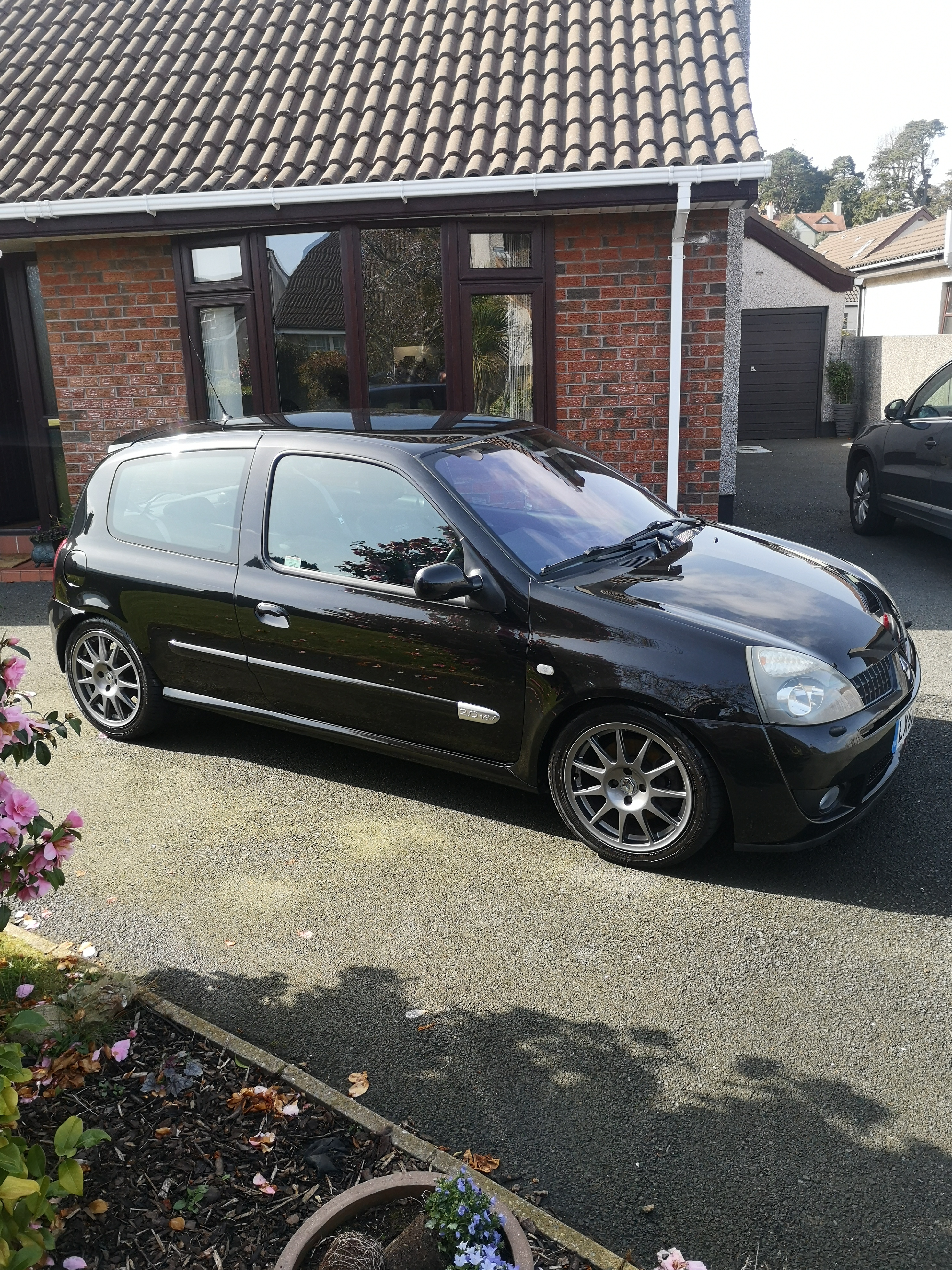

Planning on finally getting the drive tarmacced this summer so the jungle doesn't grow up inside her. Need to sort that Leon out as well, been parked for 18 months and is turning green.

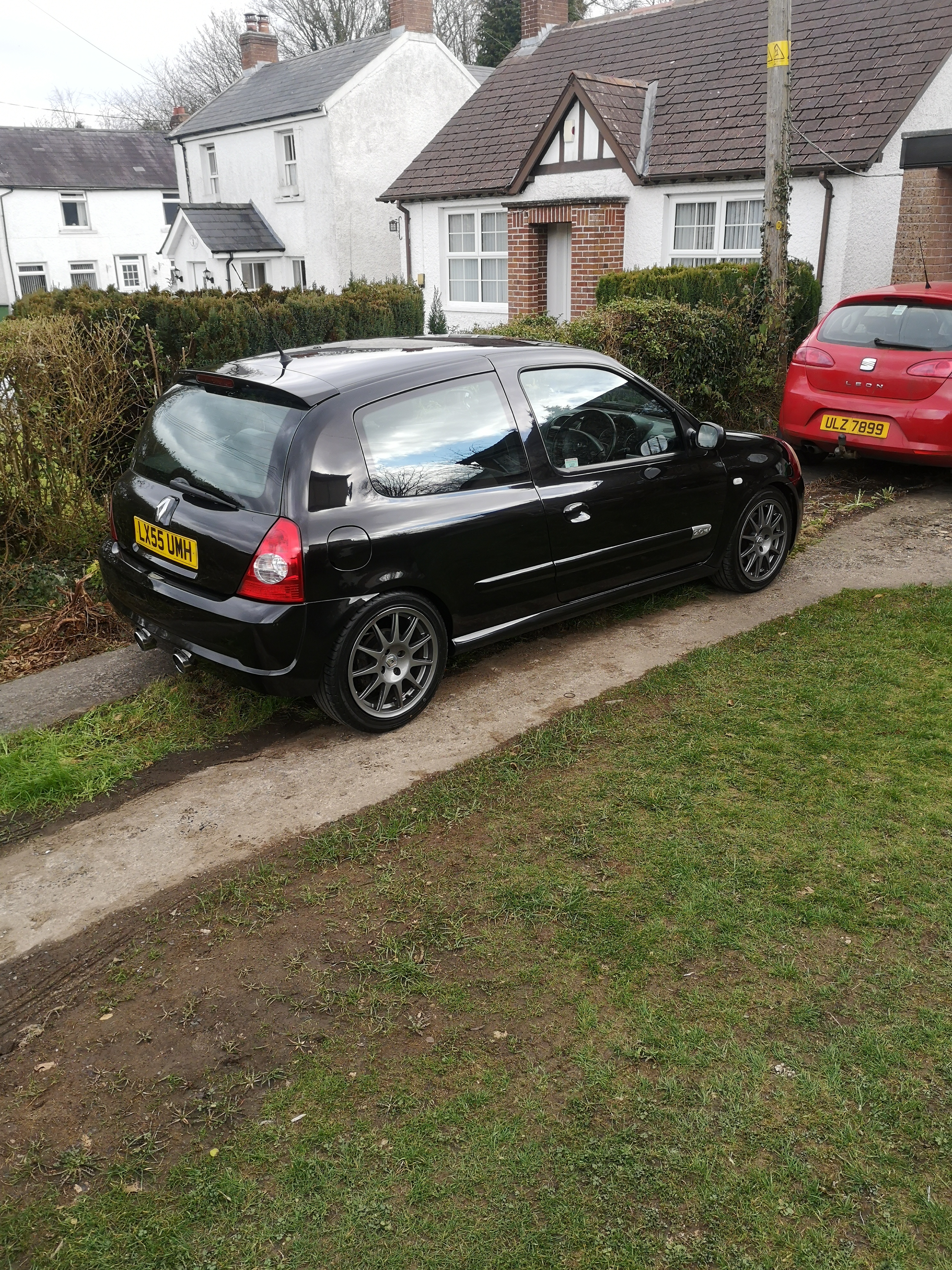

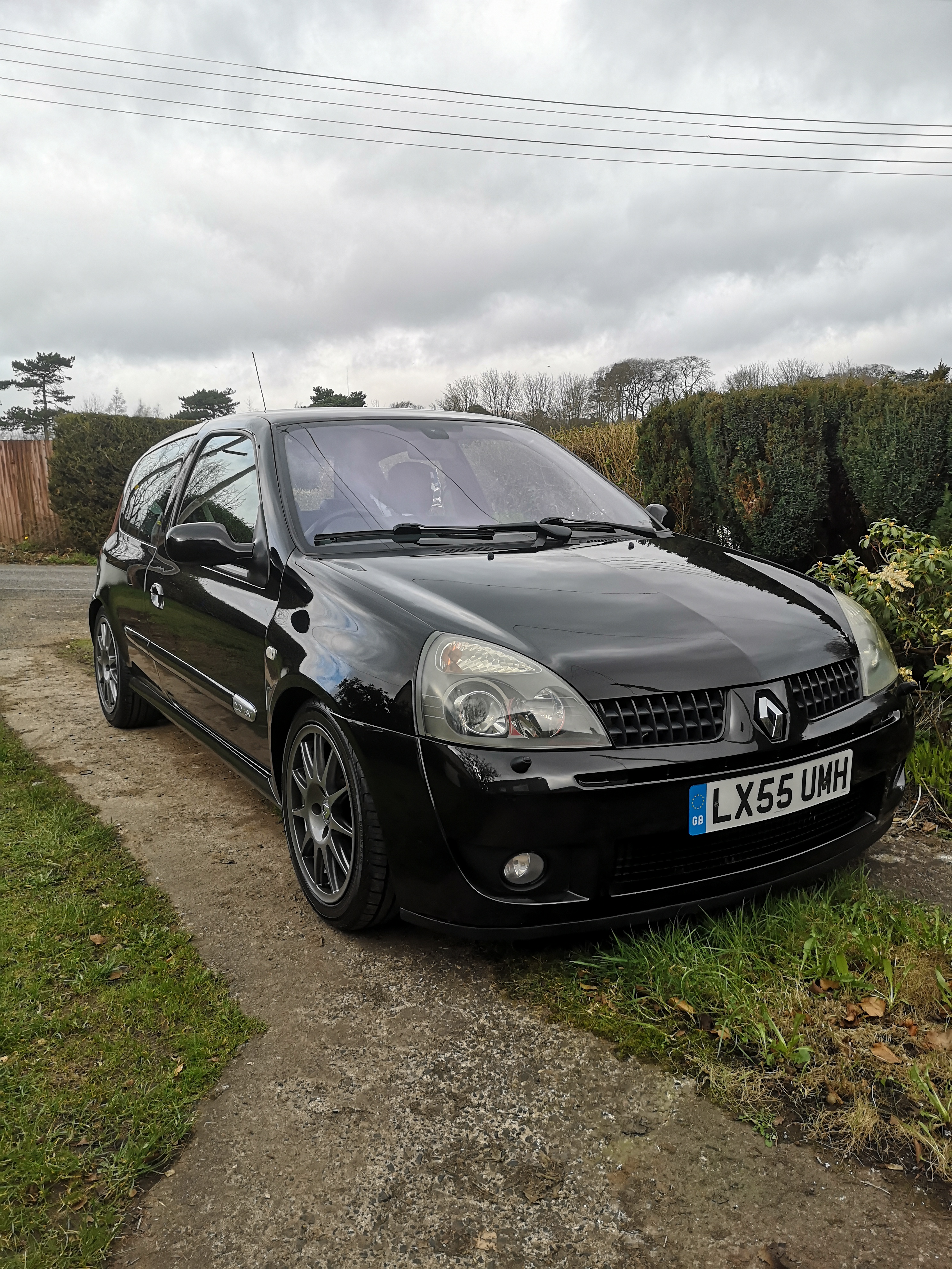

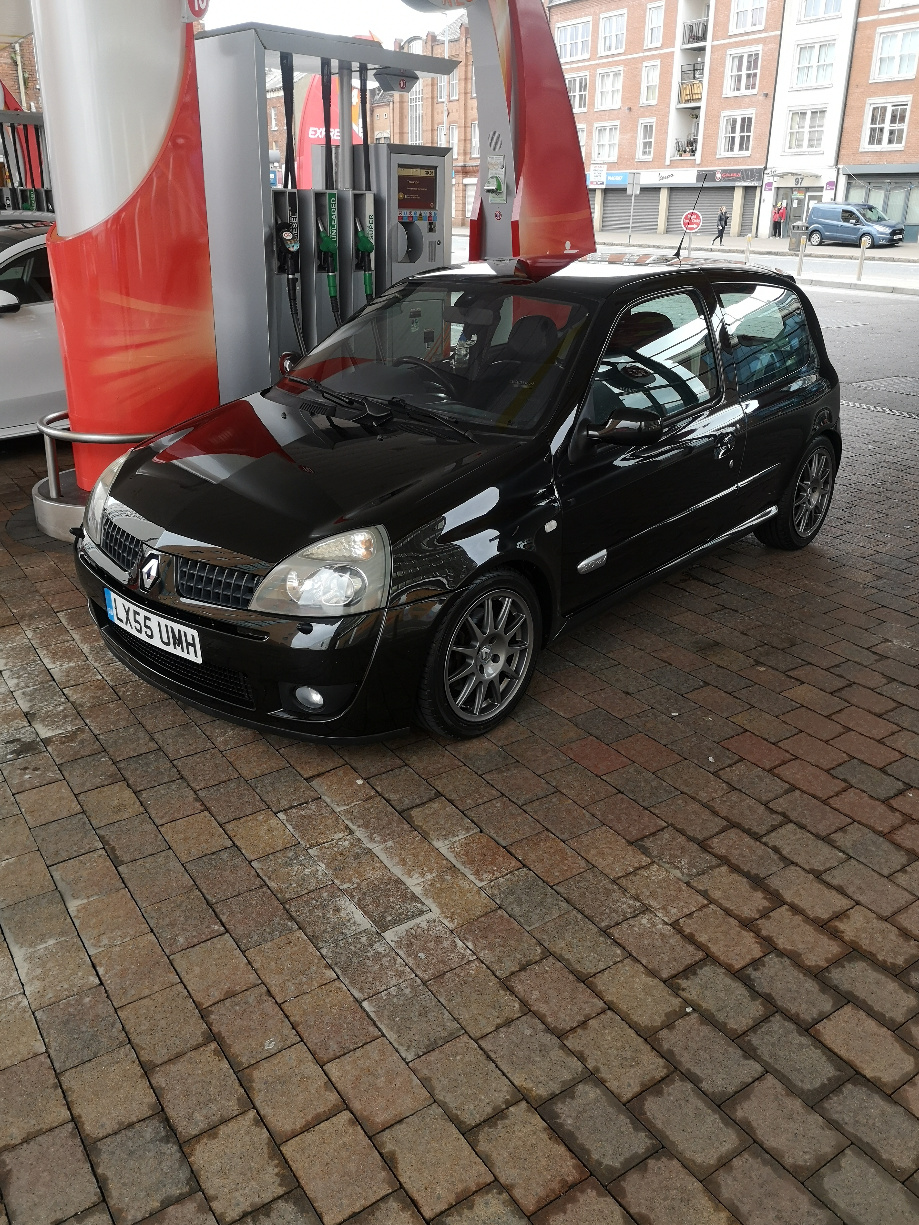

Great looking car, well done.
Very new to all this, I have just bought a silver 182 myself. Can I just ask, I assume those Turini‘s are 16”?
They are 16" yeah. Look decent as they are but could do with a refurb. I had been set on silver then saw ash's 182 BG trophy thread from way back and really love that porsche grey. But the current colour is growing on me.
Looks clean!!
Also picked my 182 up today so I share the same excitement, it’s barely sat still since I got it home I just want to keep nipping out for “essentials” [emoji23]
I had to get on the drink to stop myself from taking it out again. Coming from driving diesels for the last number of years it will definitely require a bit of getting used to again but was trying to avoid really pushing it and I know from experience thats when these cars come alive.

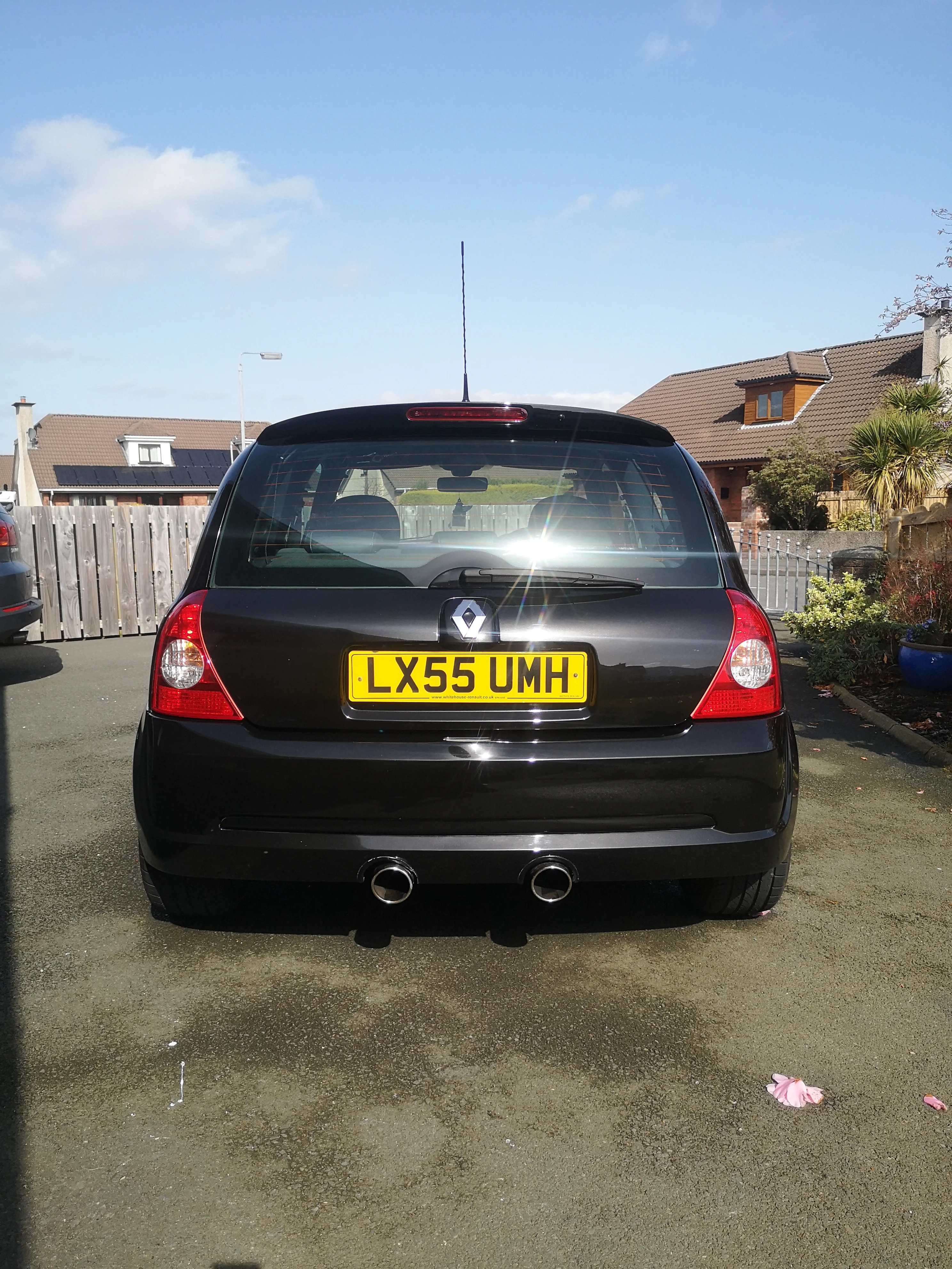

Would need to get a couple of the little plastic exhaust trims to tidy the back up and ideally get the exhaust tips realigned slightly as they are a bit off
