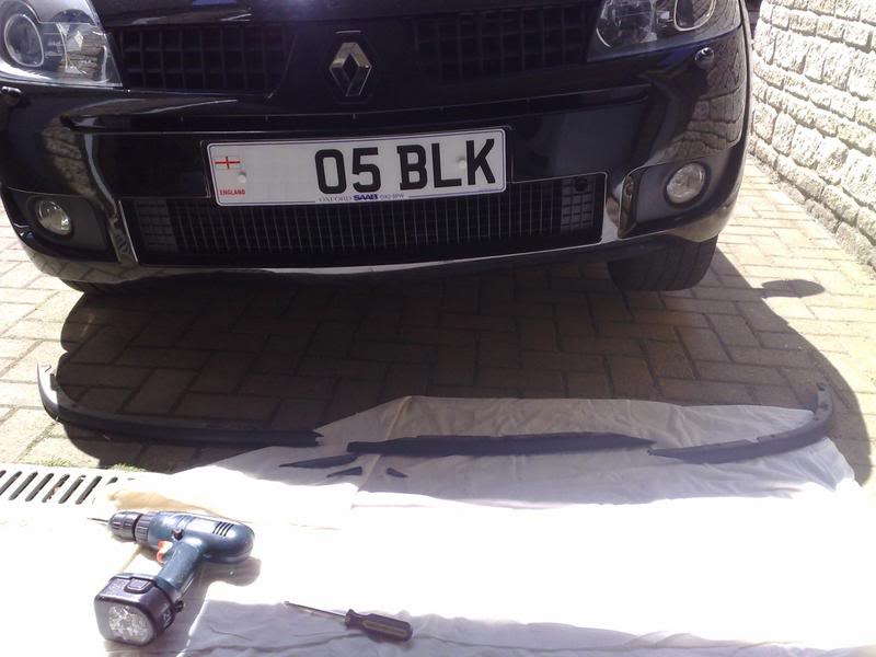

Can this be fixed.....or not??

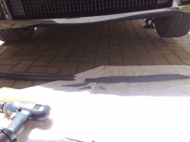

Could be fixed if you could be arsed. Fibreglass the back of the splitter then respray in satin black. Would take a bit of time but not impossible.

I recogn some clever work with a pound shop glue gun, then a bodge job, rubbed down and painted would look just like new
Cheers
Where would i get the fibre glass from?
You can get fibreglass from a motor factors. It may be worth bracing it with some wire mesh as well then a bit of P38 filler to finish on the front.
