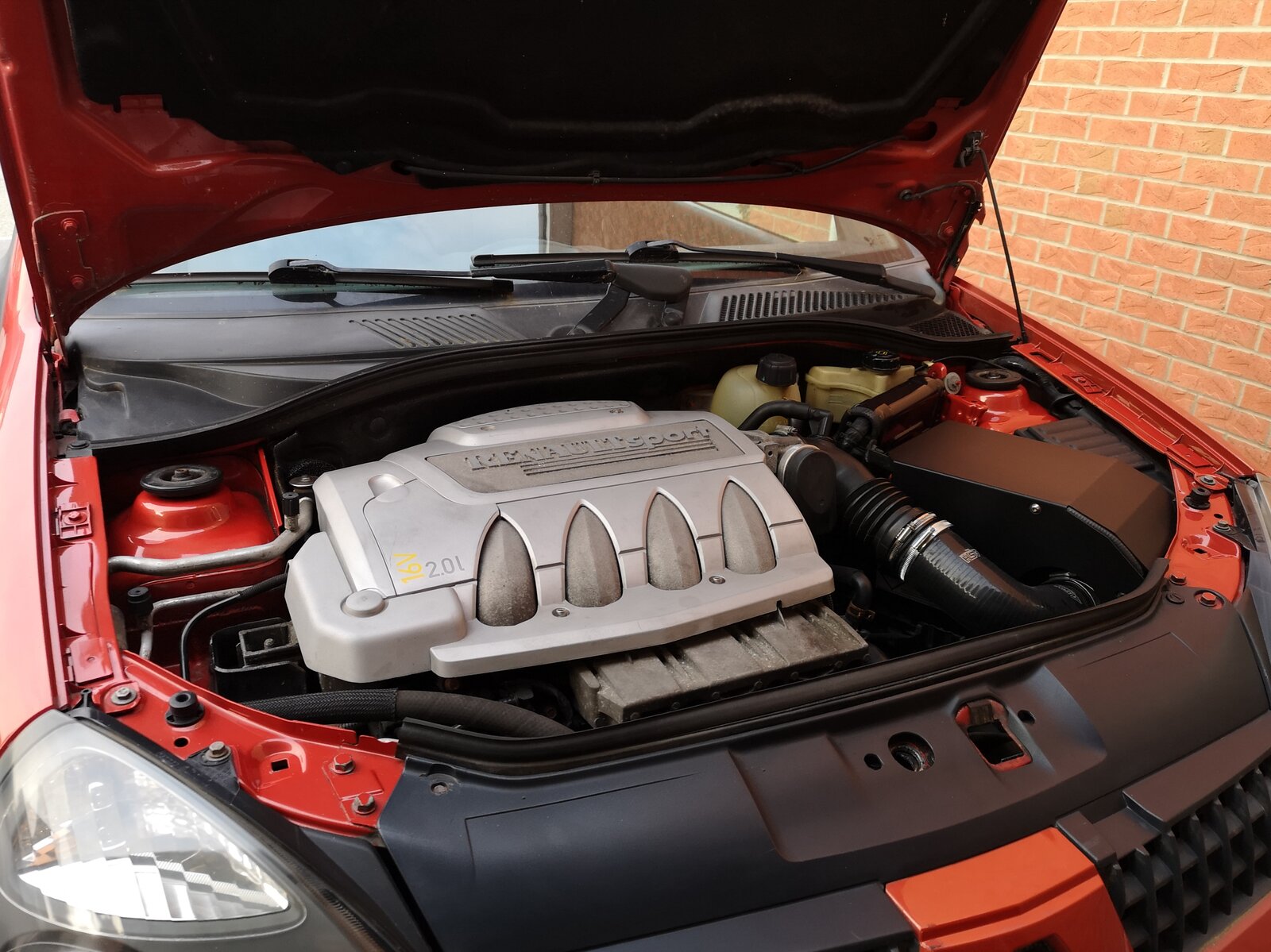

The spunk is now fully gone. Got fed up and bored with trying to fix it a few weeks ago so cleaned the engine bay a little bit. Might even spray the inlet and fuel rail guard when I get the fucker working again!
You cleaned that about 2 weeks ago
