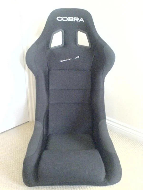

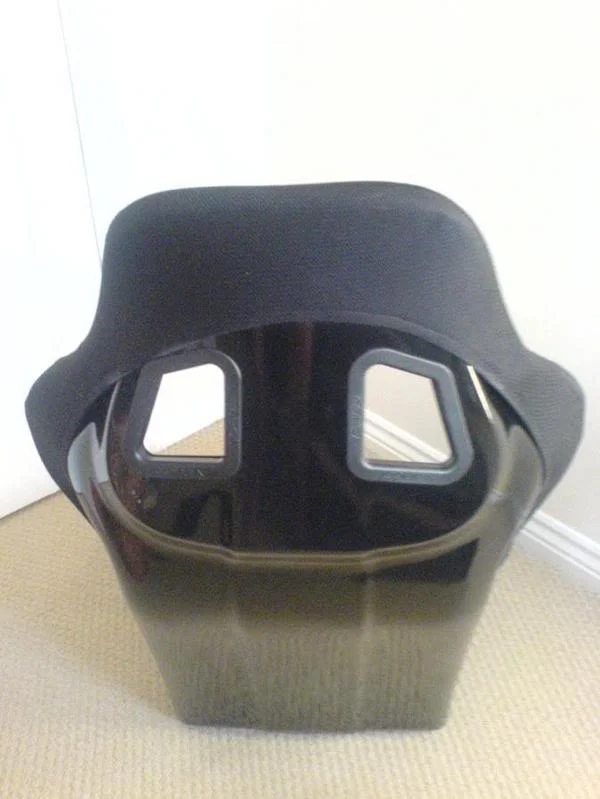

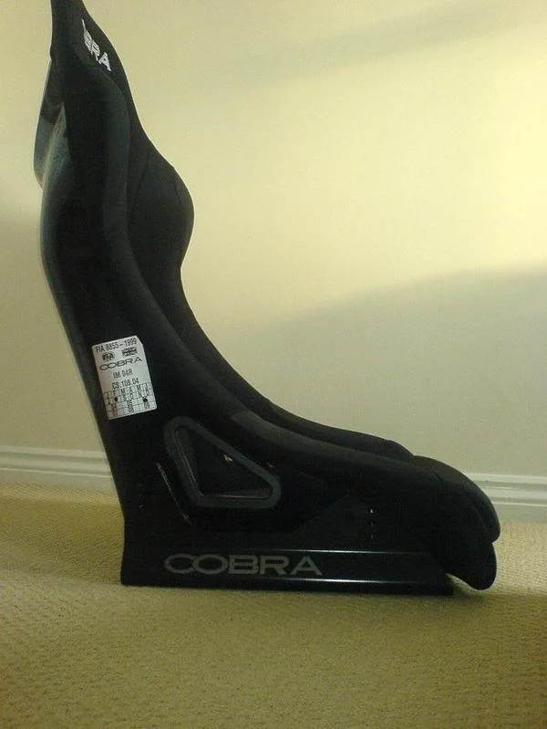

heres a pic of mine, so you get an idea
  CTR--VX220D
Have a look on Demon Tweeks for Cobra Imola S bucket seats in the Kevlar composite.
I also have the 5mm Alloy side mounts - not the normal 4mm steel ones ;)
