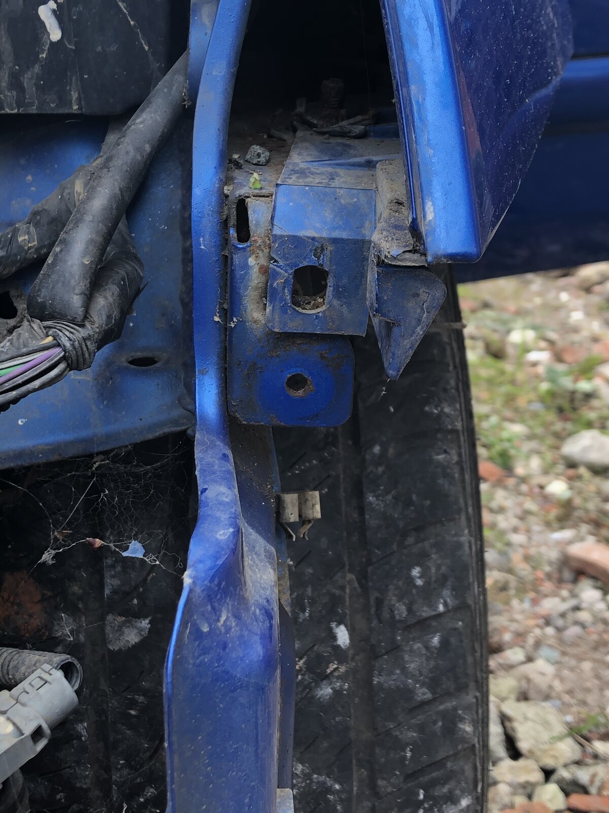

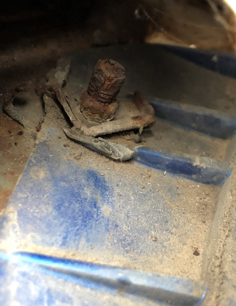

Hi,
Can anyone tell me what and where to find replacements of these please? Wing to frame and bumper etc Bolts and fasteners please?
Thanks in advance.
Louis
I Park Like a C**t
f**k the bolts off for the bumper to the wings, its not needed.
They're otherwise called spire clips
Eddie555
  Q7 2018 & 172 Cup.
I did this job today.. I just used a M6 nut and bolt with a couple of penny washers..
Sent from my SM-G977B using Tapatalk
04-182
  AB Clio 182
Thanks for the replies. Quick follow up. What’s the top hole for here? Know bottom one is for the headlight. Thanks.
Eddie555
  Q7 2018 & 172 Cup.
The top hole is just a locator hole for the head lamp.. Look at the back of your head lamp as there is a plastic pin sticking out of it..
