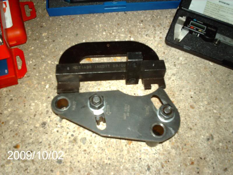

If they're an independent, working from Autodata, then it will be wrong, guaranteed. Autodata for renaults is next to useless, hardly any of it is correct
  Clio 172mk2
TDC/Crank Pin - 0000105400 - £8.98
Extra Longer Cog + Spacers + Nut - 0000150901 - £16.56
Camshaft Locking Tool - 0000149600 - £40.50
Pulley Locking Tool - 7711381801 - £40.50

Nothing wrong with asking. Dont see why they wouldnt show you unless the have something to hide. (Using the wrong tools and knowing about it)

Yep thats true!!,
Only with the help of the guys off of here and there vast knowledge did i manage to get the part numbers for the tools i needed to do the job "right"!!!!!!!!!
I did say to the parts guy at Renualt "Bloody good when the customer has to give you the part numbers"
