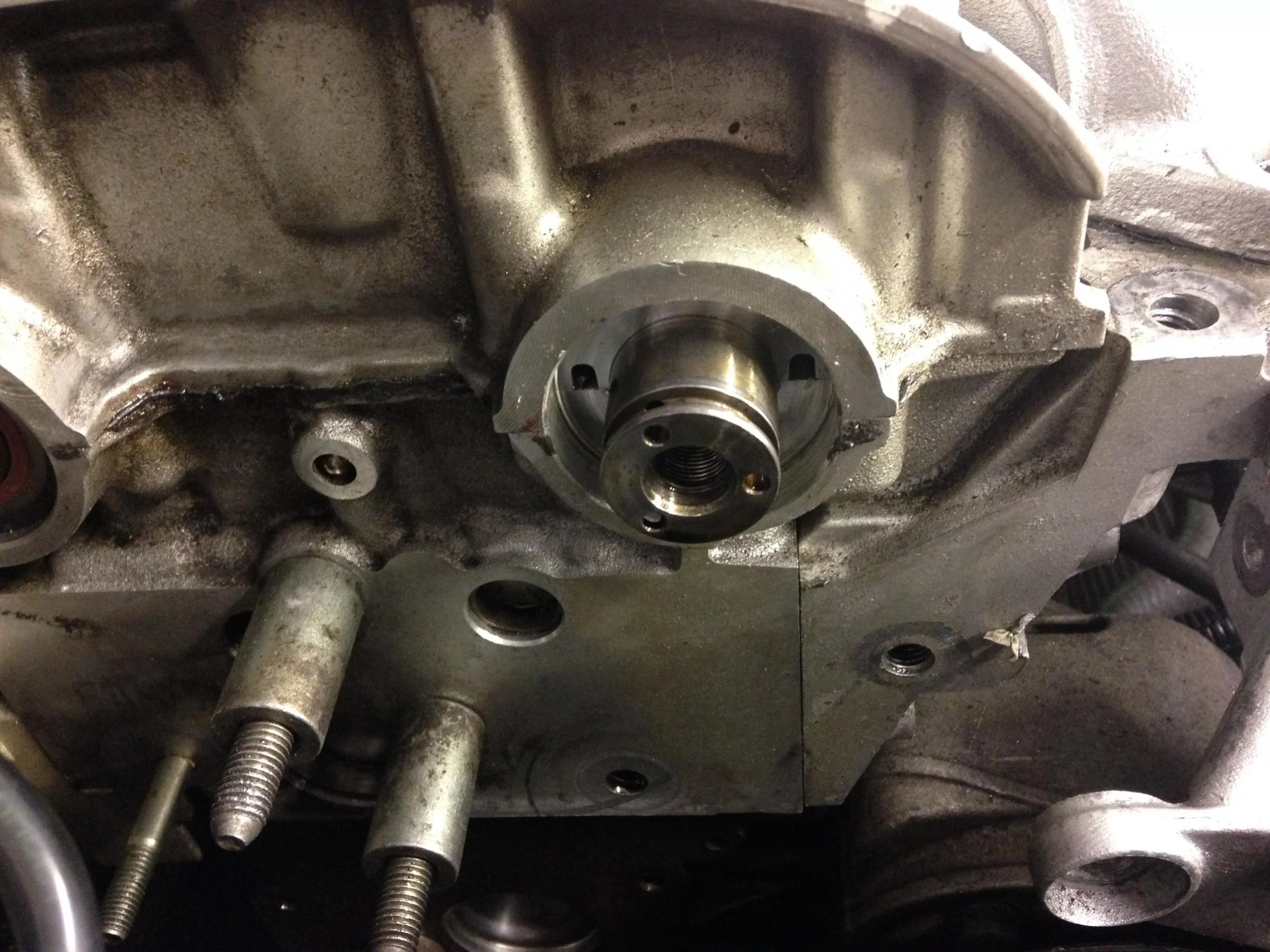

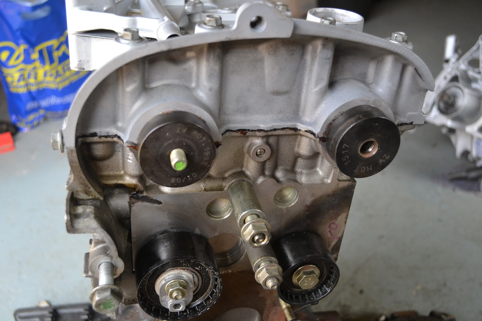

Yeah dan you are right that was / is my car that was being done at the time I don't want to go in to much on here as there was a row the other night and I don't want to bring any of that up or names but unfortunalty for me this is goin to be an expensive fix :( I will you all the advice you guys have given me and this time I will make sure the garage get it spot on
  Clio 200 full fat

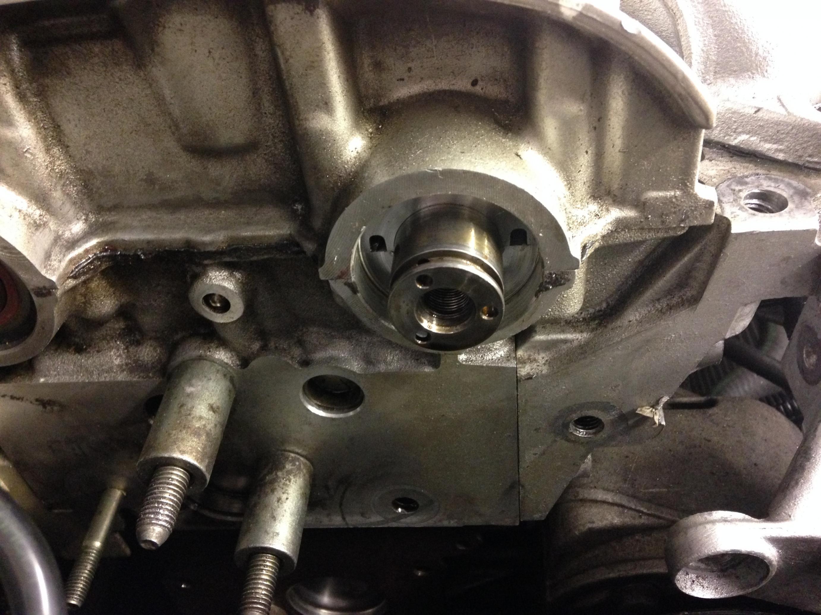

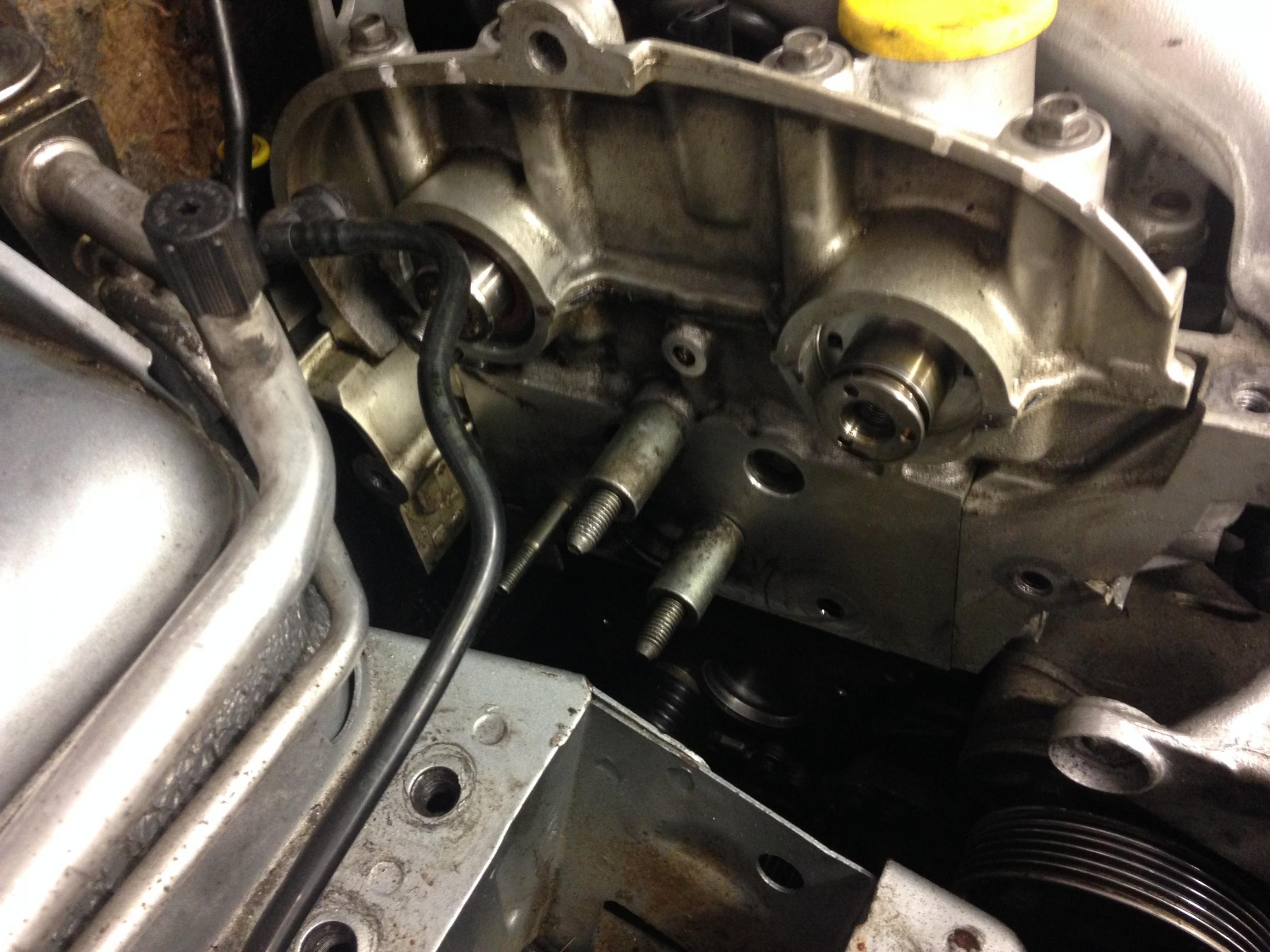

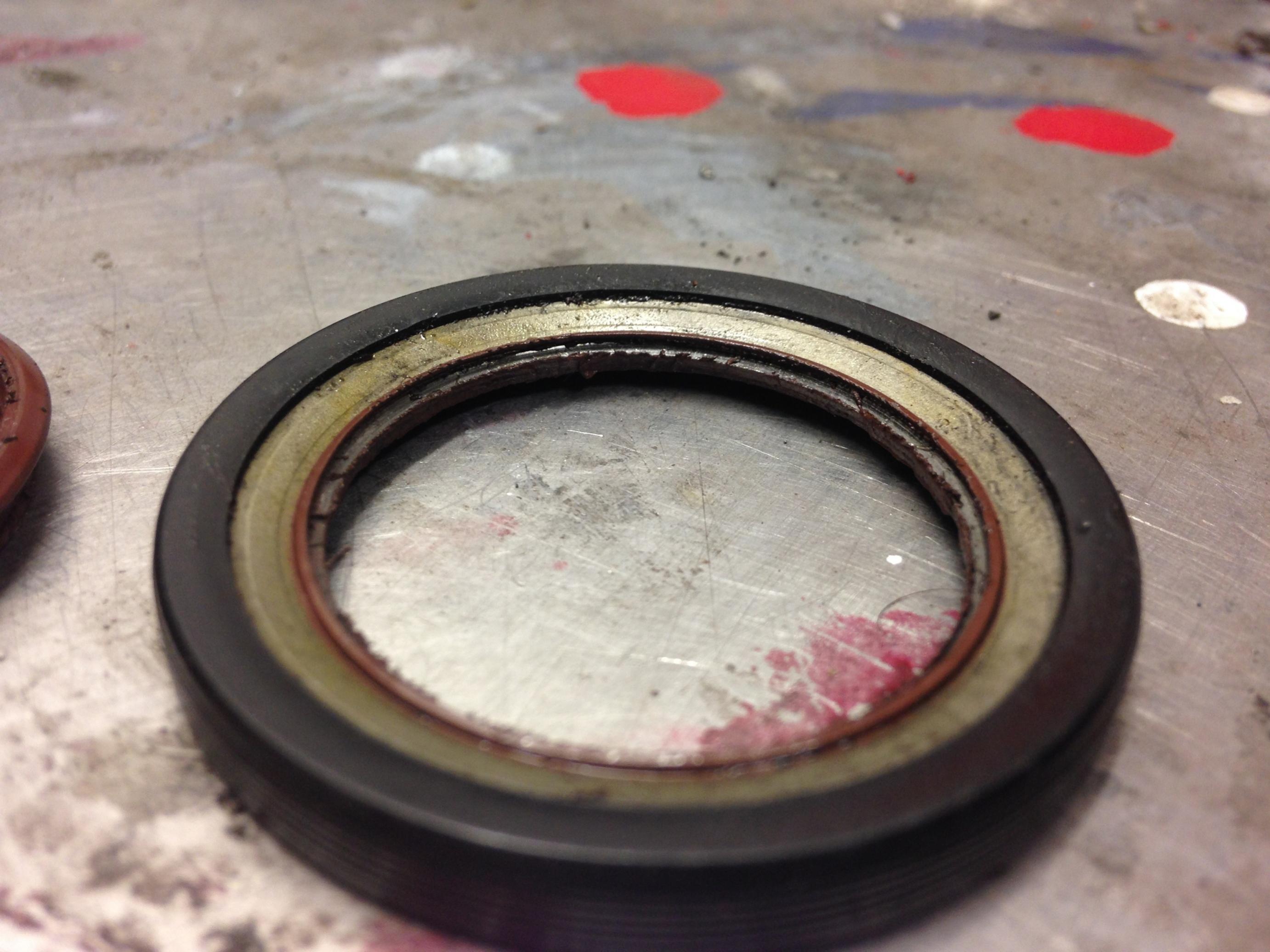

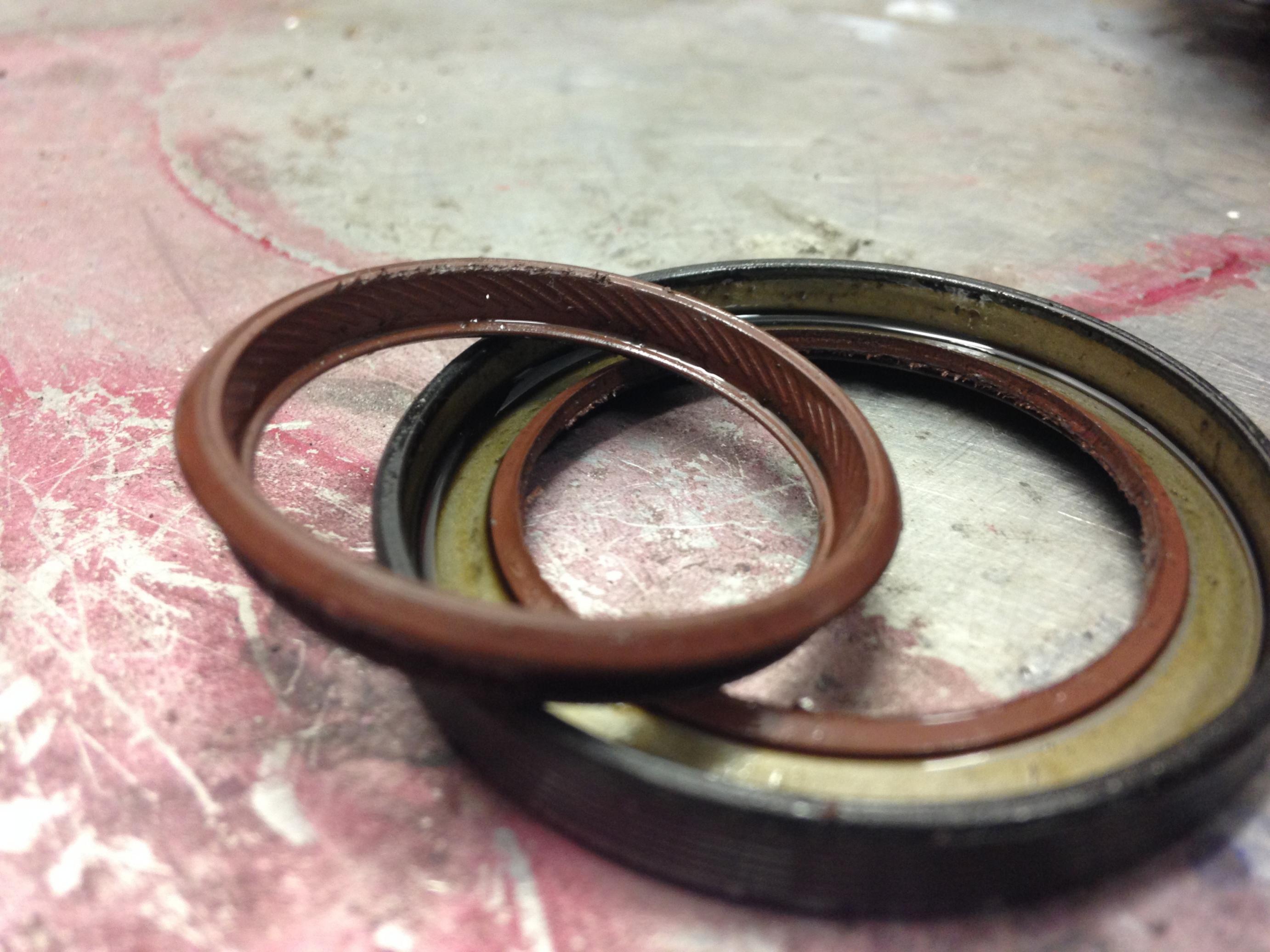

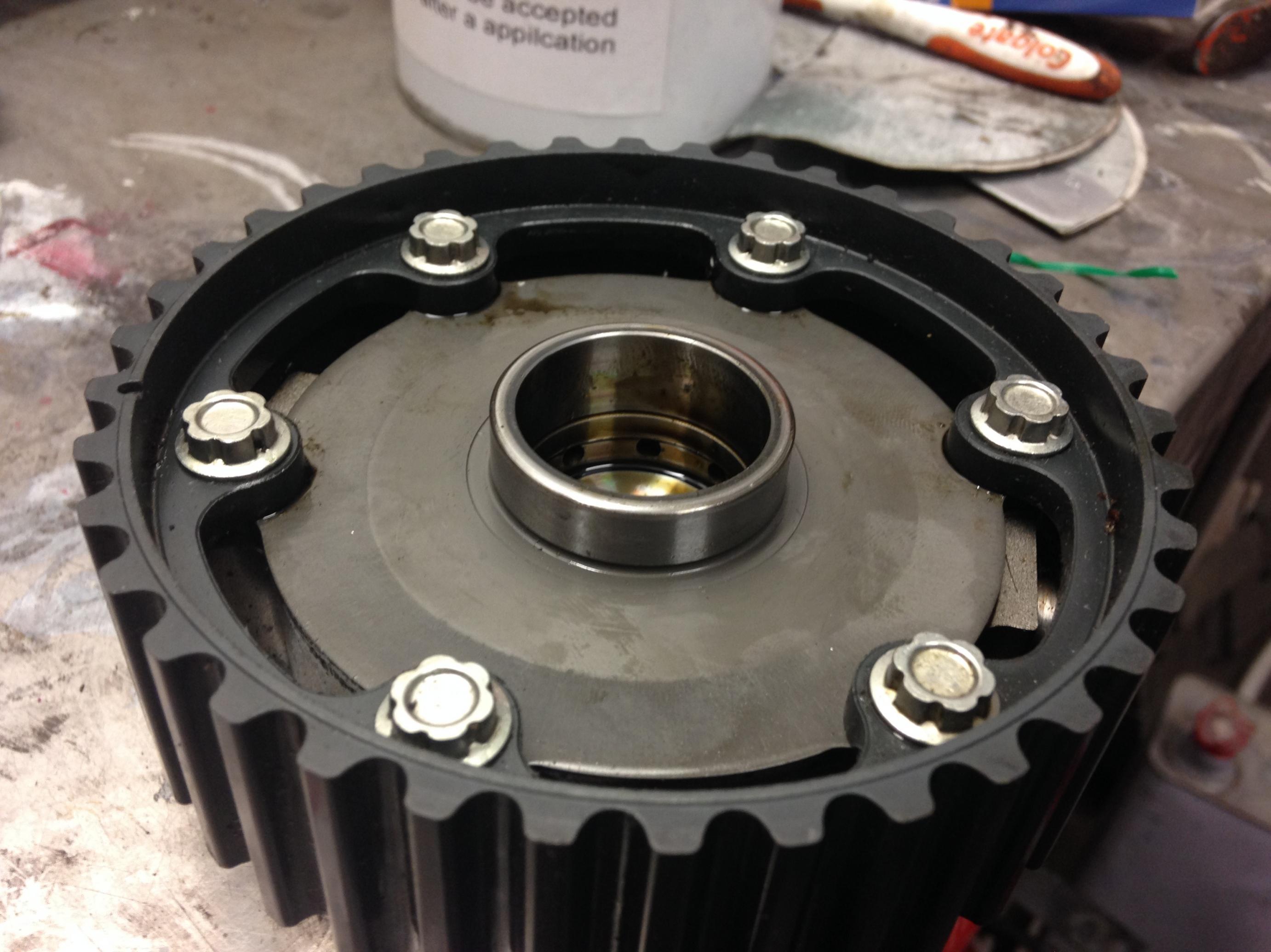

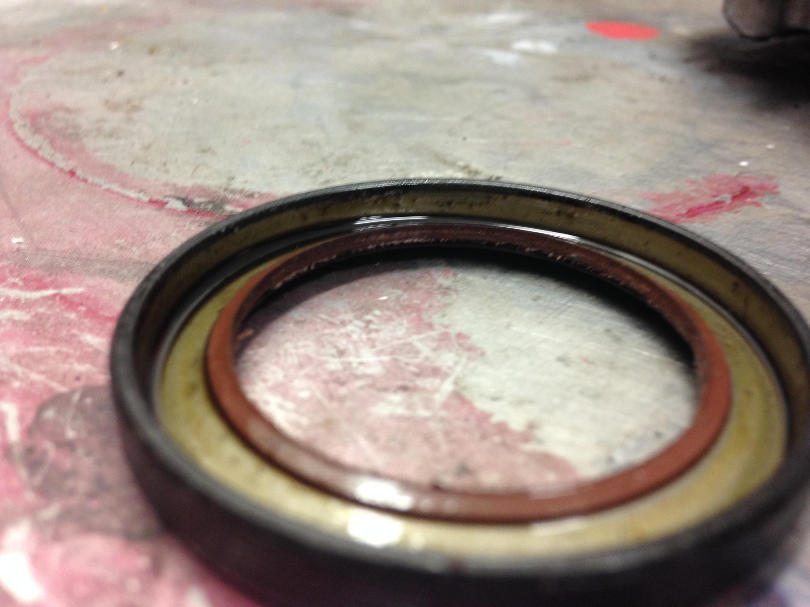

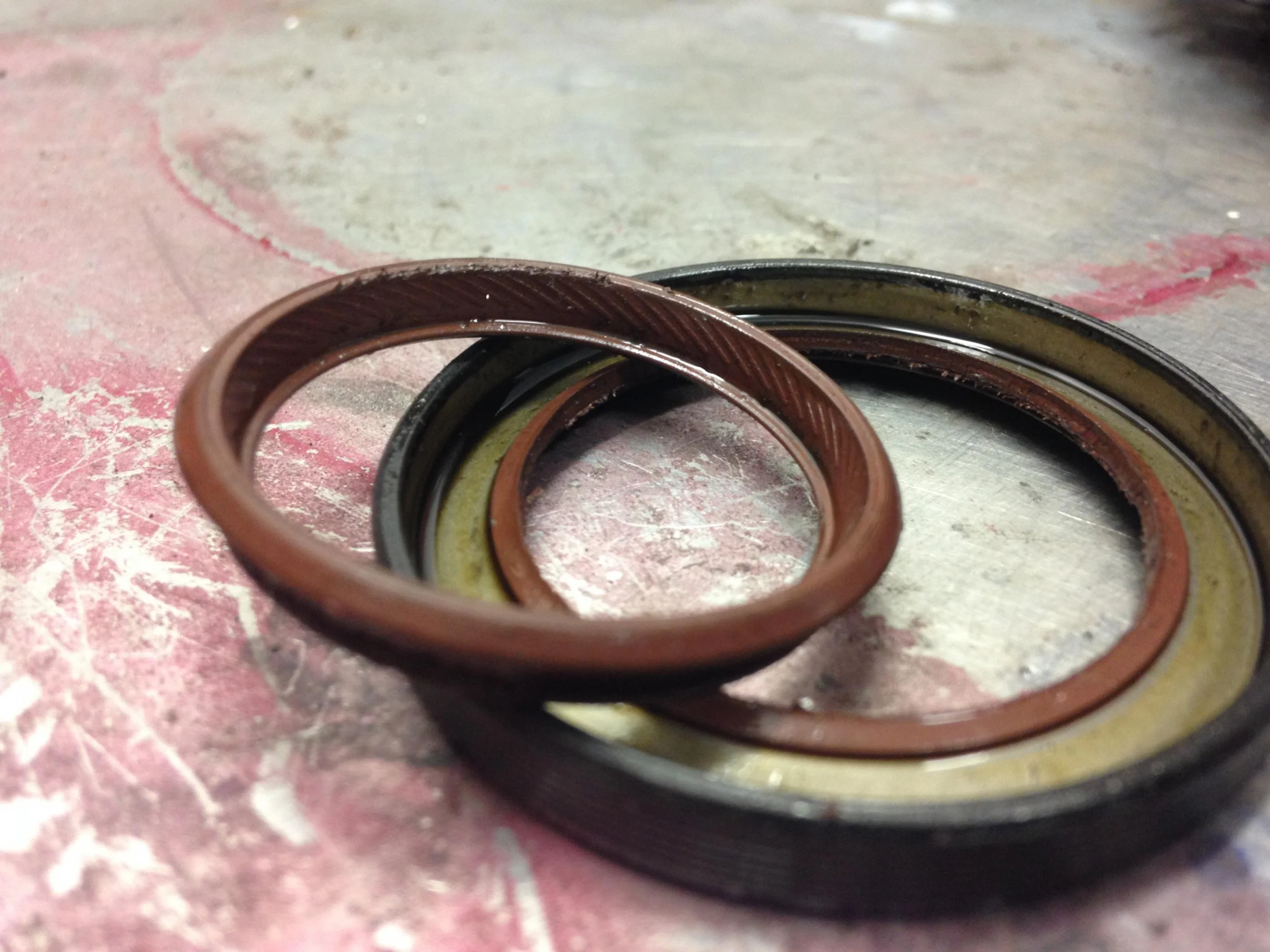

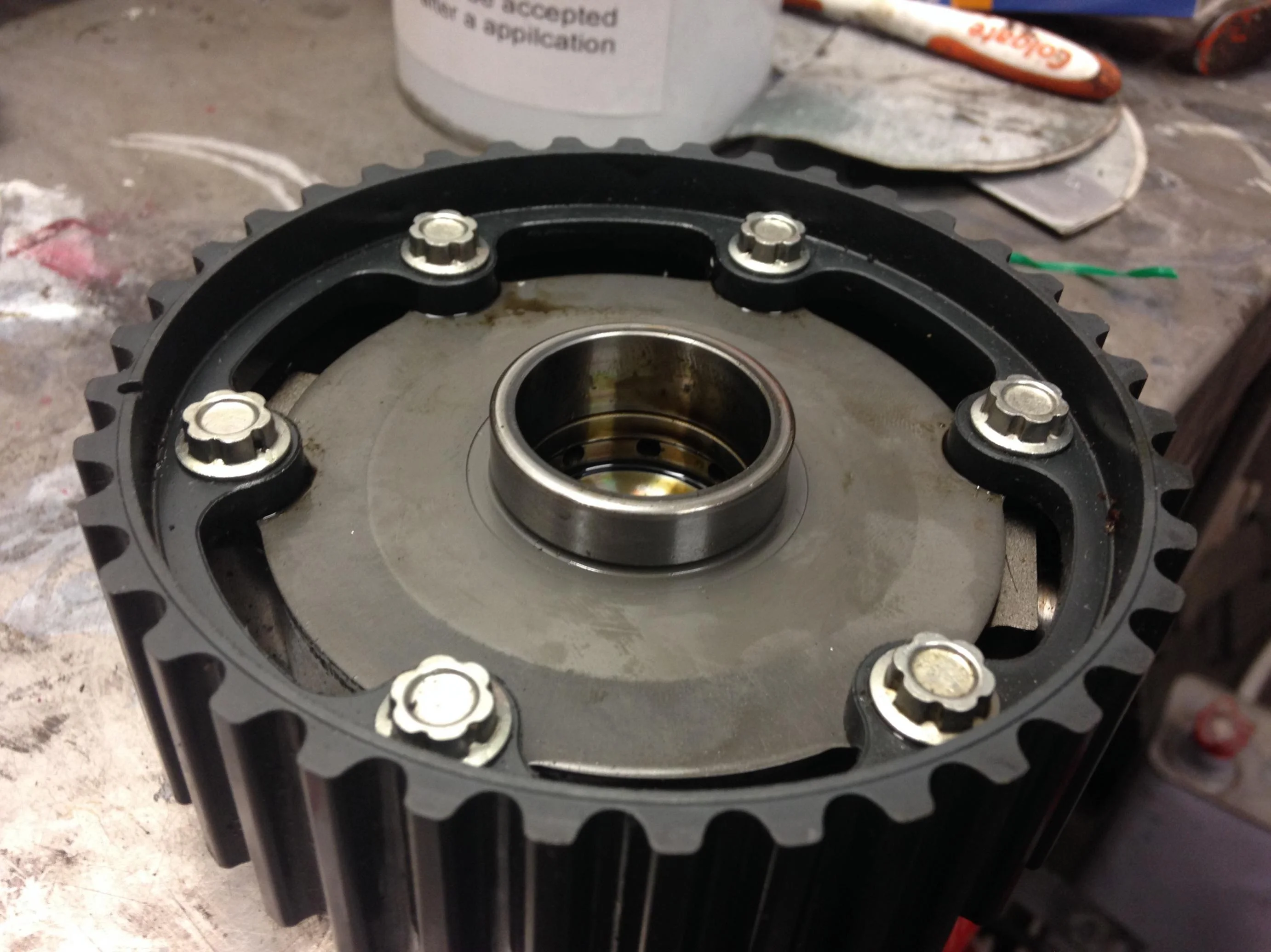

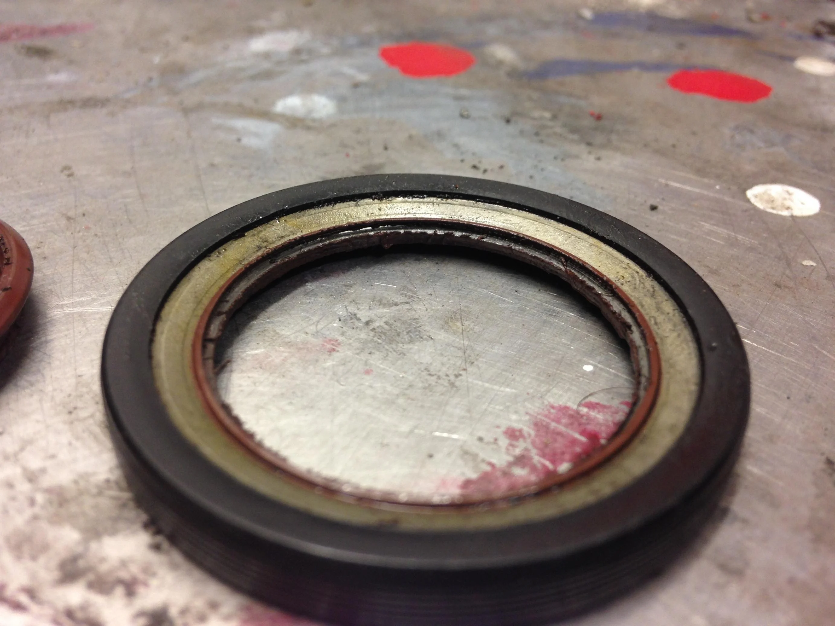

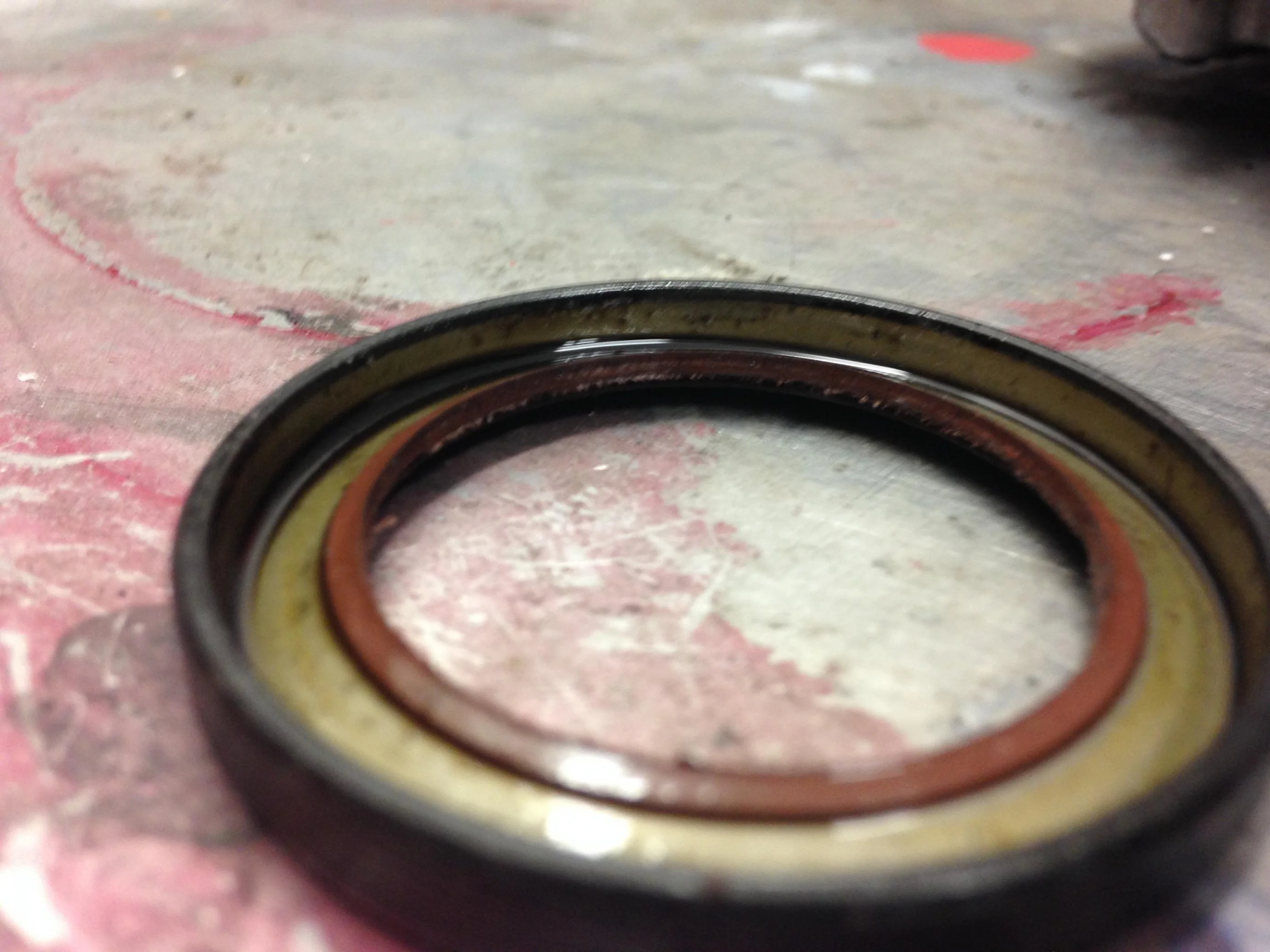

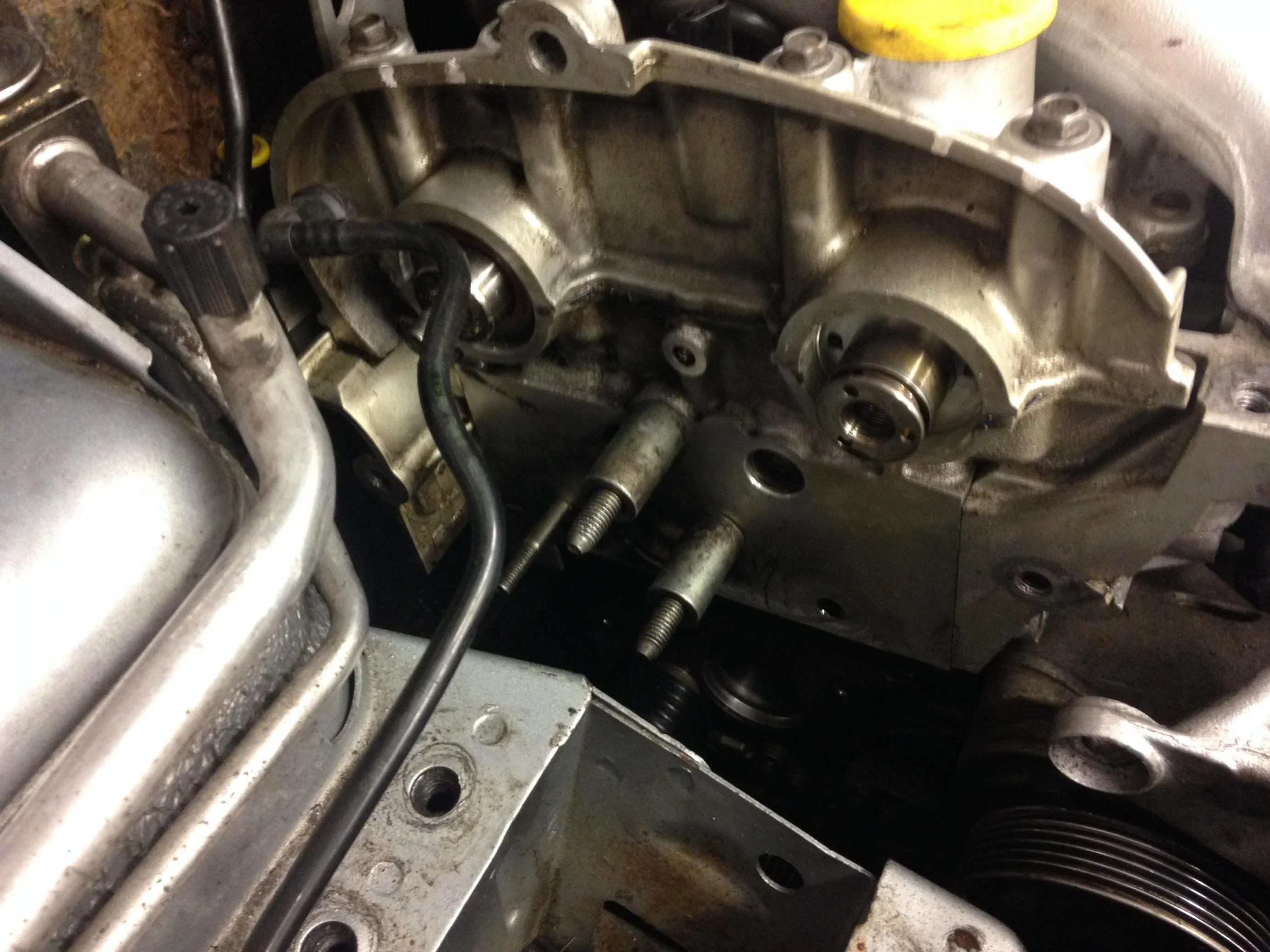

so my car was looked at yesterday and the problem has been found it was as said in here the cam seals apparently as told by my mechanic the guy who did the work on my car orignally had put the wrong seal in the inlet hole he had used an exhaust seal in there and apparently when my guy stripped it all down the de phaser was not sitting in there correctly once he had taken that off he could see that it had not been sitting correctly in there because the seal did not fit and apparently the two should be sitting flush on each other he the continued to remove the seal which on removal he found was split in half here are some pictures that i took image (1).jpgimage (2).jpgimage (3).jpgimage (4).jpgimage (5).jpgimage.jpg as you can see from the pictures the gold ring inside the seal i belive should be flat but because it was the wrong seal and did not fit the de phaser just sat on it and bent it then making the brown part of seal split away there was also some marks on one of the pulleys which look like some one has put a set of swan necks on there at some point and slightly mis shaped a tooth
