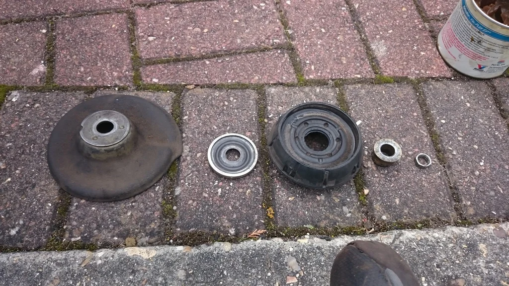

What is the correct order to put these back on the spring?
Andy_con ClioSport Club Member clio 182 May 15, 2015 #1 What is the correct order to put these back on the spring?
Andy_con ClioSport Club Member clio 182 May 15, 2015 #3 Ok so then is this right? This is done up as tight as I can
1812lsd CursedTitanium 182FF May 15, 2015 #4 Watch this for the correct order @1:20min Your bearing looks upside down. Last edited: May 15, 2015
Ol’ Tarby ClioSport Moderator Clio 220 Trophy May 15, 2015 #5 Hmmm I don't remember having play like that on mine when I did it a couple of weeks ago
Mr Trailer Man ClioSport Club Member OG Megane 265 May 15, 2015 #6 Flip the bearing over that's underneath that top rubber mount.
1812lsd CursedTitanium 182FF May 15, 2015 #7 Not sure why, but the bearing in this guide is shown under the spring cap :fearscream: http://www.cliosport.net/threads/gu...n-suspension-struts-springs-with-pics.319663/
Mr Trailer Man ClioSport Club Member OG Megane 265 May 15, 2015 #8 1812lsd said: Not sure why, but the bearing in this guide is shown under the spring cap :fearscream: http://www.cliosport.net/threads/gu...n-suspension-struts-springs-with-pics.319663/ Click to expand... That looks wrong i'm sure.
Andy_con ClioSport Club Member clio 182 May 15, 2015 #9 Bearing is in the right way, just wasn't the right way up for that photo. Just seems a lot of play considering its tightened
