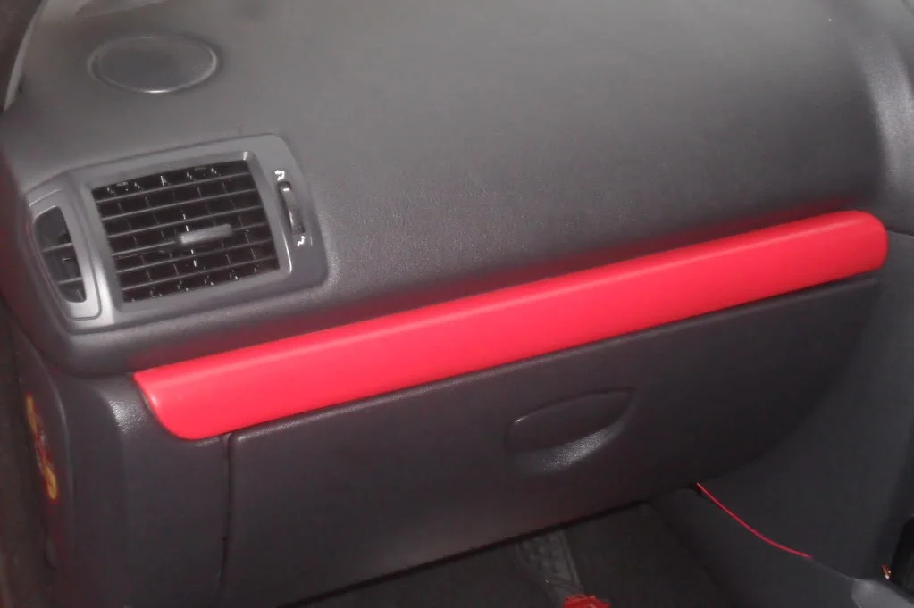

All done, really pleased with them :approve:

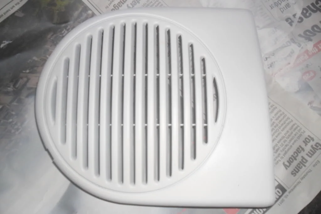

Now I'm doing my speaker covers:

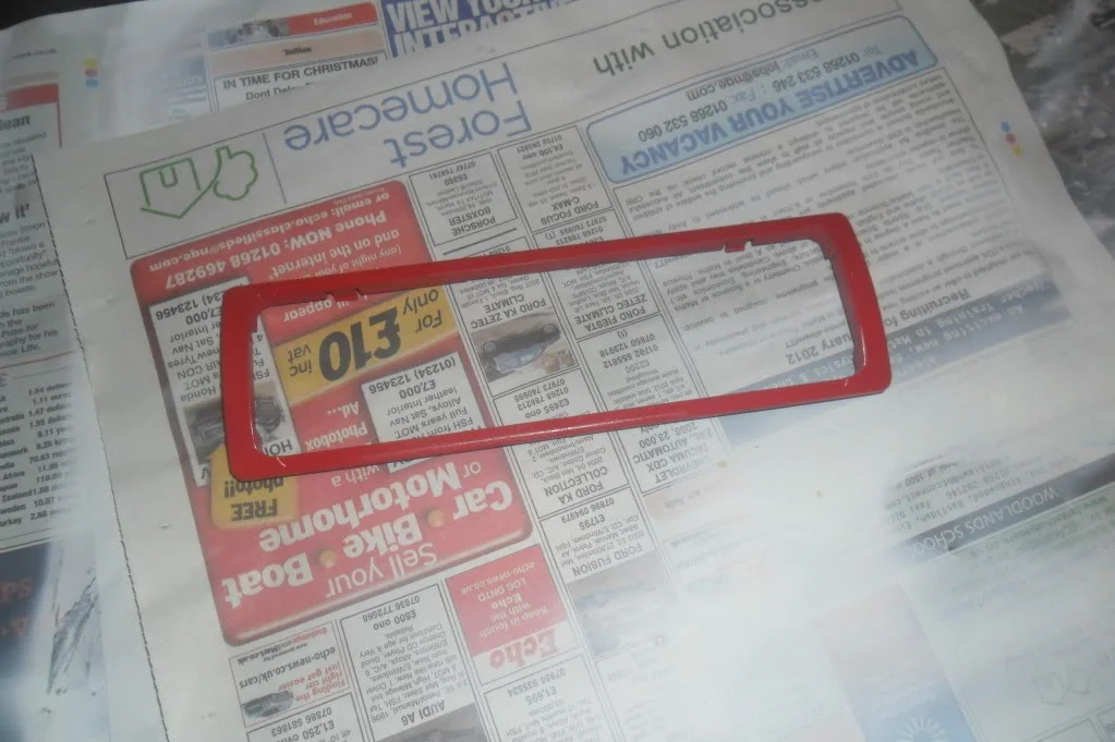

And I've also done my stereo surround
Hopefully will look alright and not too tacky.. Can always buy replacements if it does look a bit much :P
