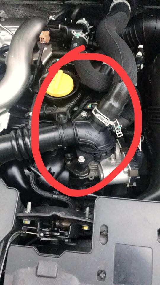

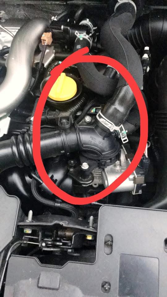

Check this pipe. They’re common for splitting.
  Clio rs 200 sport
LOL just came in with that part in my hand and seen your post. It broke a few months ago, came completely off, made the car very noisy and no power but did not trigger a warning. I glued it back together and all was well. The glue failed, opening a split at the back out of sight, this time triggering the warning.
Why would it not have triggered a warning the first time is beyond me.
These are multi segment parts glued at the factory. I would like to know what the adhesive is?
