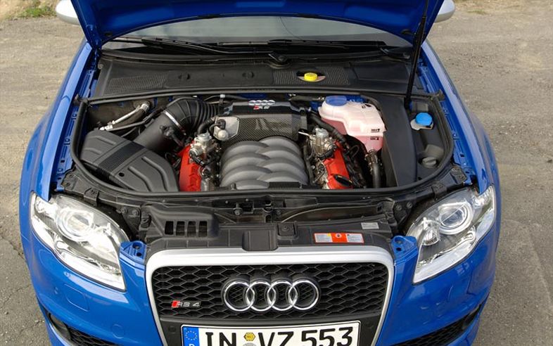

Say I had one of these....
and one off these.... missing the engine.
What would stop me putting the top one in the bottom?
From a technological point what would be the biggest hurdles to over come? Would it even fit?

The fact there there are no transverse gearbox options for the Audi engine at all, and it wouldnt fit accross the rear of the car even if there were, means you would have to go for a longitudinal layout, at which point the front two cylinders would be space sharing with your chest.

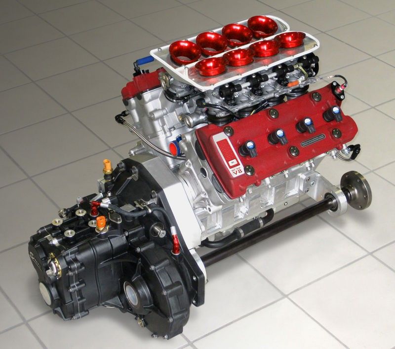

Audi engine and box:
Cant find a Vee engine, but hese's a conventional transverse layout:
Im sure you can see the problem.

Except wrong. Its transverse rear engine RWD, so in effect it's a FWD engine and box, so nothing youve mentioned will fit due to the aforementioned lack of transverse gearboxes. Cadillac Northstar V8 would be a vague possibility.
