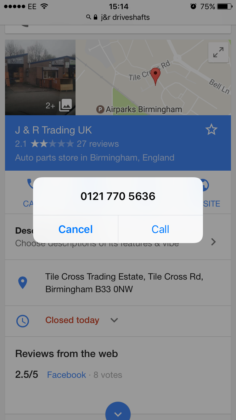

Okay cheers mate il give them a ring tomorrow. Iv just read a couple of reviews saying they were crap :-/
