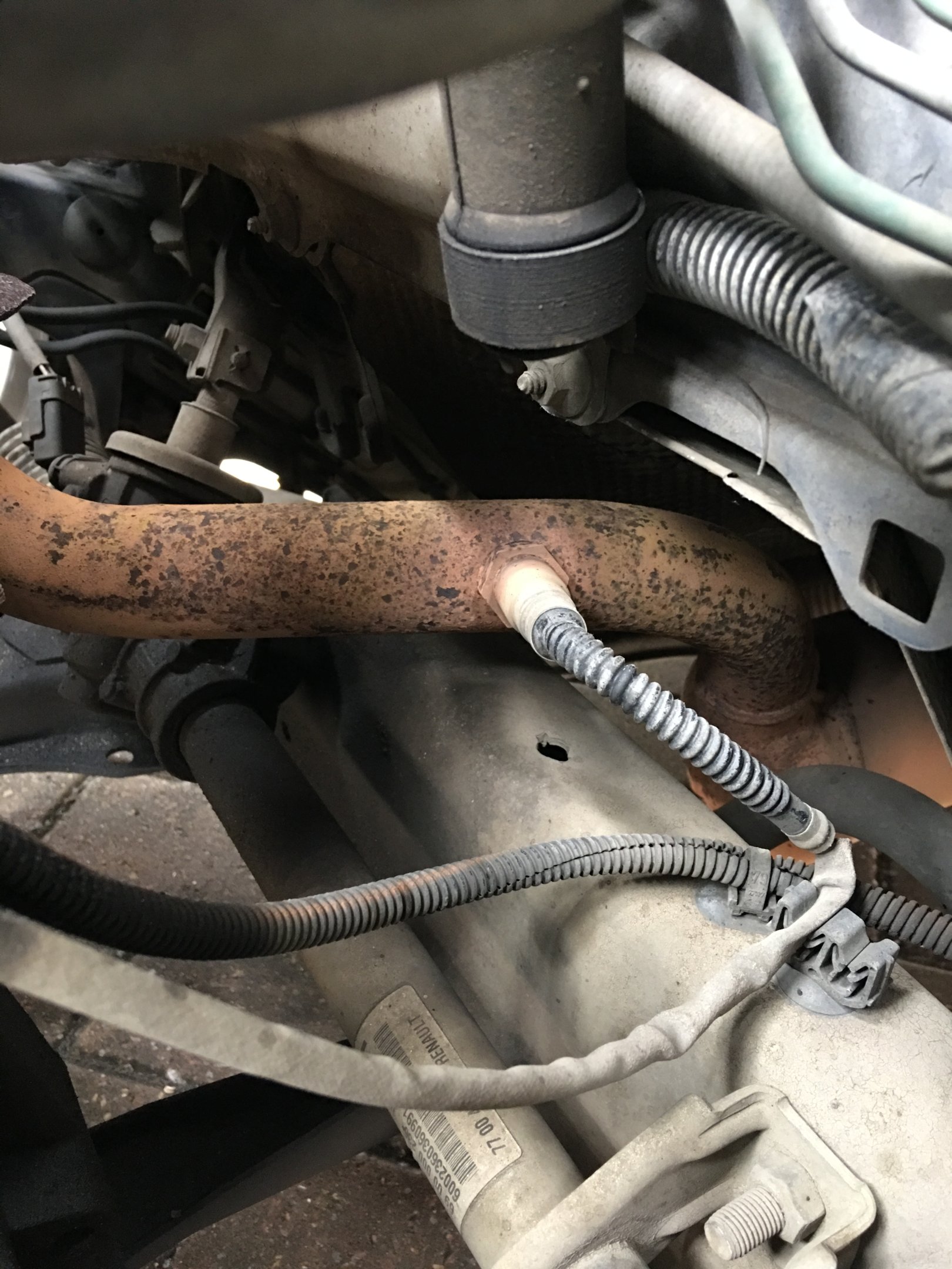

Hi guys, just wondering if someone out there might be able to shine some light on a situation for me. Was driving up to my girlfriends last night, about a 40-mile drive, and half way my car started to judder. Losing all power I pulled into a lay by of the a14... Long story short, its been losing power momentarily for a couple weeks now, and kicks in vigorously again, jolting me backward. Although last night was the first time the check engine light came on (flashing). After reading a few things, and phoning a few people that have worked on clios, I have narrowed it down to the oxygen sensor. Only problem is; money is tight, so its going to be a jobby for me. Heres the next problem. Is this the oxygen sensor? I haven't done this kind of thing before, so is this what im going to have to change? or will I have to tear half the engine apart...

So diagnostics is over. They couldn't pin point the problem as it wasn't showing an engine code, resulting in them not charging me due to not being able to find a specific problem, BONUS! The guy said it could be the fuel injector pack or the o2 sensor. So i shall replace both of these, and hopefully, it will fix the issue! :)

£50 later on a new Lambda Sensor, and socket. The problem seems to have fixed its self. I also bought new ignition coils and leads, although got sent the ones for the standard 2008 clio. Joys of having a campus, so they don't fit. All is looking good for now though :D
