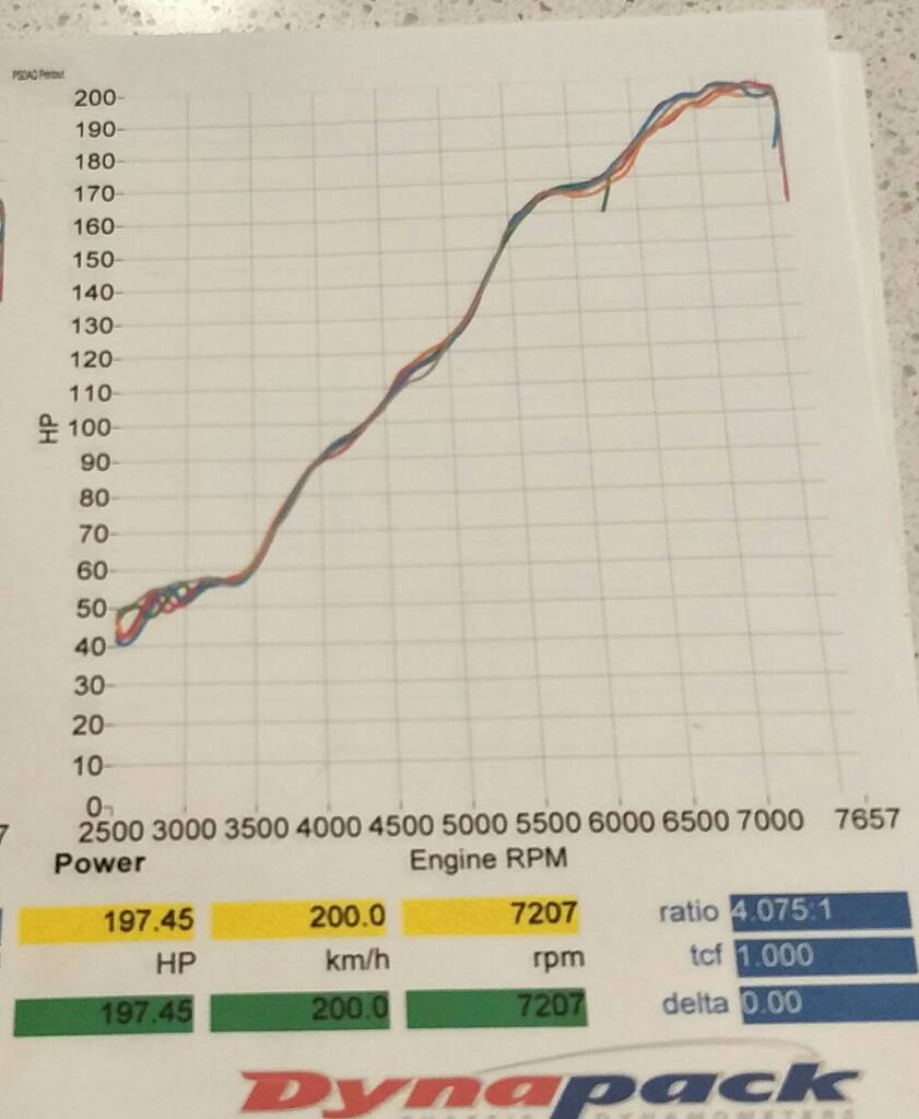

I'm running 431's. Make sure you get Cam vernier as you will need to dial in the Cam overlap

I'm getting a pretty flat torque curve and ran the car up to a 7750 rev limiter as revs are important being a race car.
Below dunk is at the wheels. Gained about 20hp by moving the cams.

All the 433, 431 and 434 make good power, I would chose the cam regarding in on what type and gear ratio or engine preparation.
434 make a very linear/flat torque curve, not the big torque at 5800rpm that 433 makes.
The engine made 245hp at 7800rpm (Engine) and 245Nm, similar curves that @Brucefil posted. (Verniers adjusted in order to reduce the 6000-6300rpm (“hole”).
