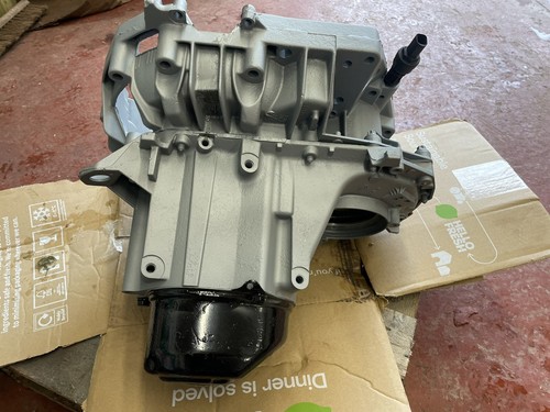

I've spotted this on fleabay and wondered if this was a potential quick solution:

Does your car run a speedo? If it does, then that box *should work, but quite why they’ve listed a jb3 box up as a 182 gearbox is beyond me!
