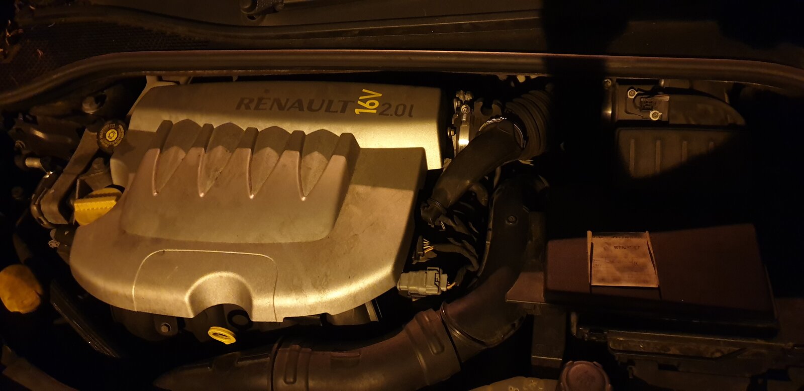

Hi guys is the Renault Clio Dominique s 2.0 138bhp the same engine as the sport 197 and if so what does it need to get to 197bhp
Is this engine a cambelt or timing chain
Its a chain engine. You wont get 197hp out of it. The most you can get is an extra 10hp with a remap. They are aluminium block engines and are not designed to have any more power put through them. The block heats up too much and deforms and then its game over for that engine. Stick with standard, very reliable if you maintain them well
