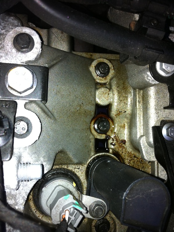

Other small things to check for would be the rear window rubber cracking where the door shuts on it, oil leaking from rocker cover bolts. Worn ball joints, normally you get a knocking from the front end and a squeaking noise when turning. With the Recaros just keep and eye on the seat bolster as they take a lot of damage if you are not careful when getting in and out.
Just a quick picture of the leaks they get from the bolts on the rocker cover. Nothing major and normally sorted by resealing the bolt but could get you a couple of £s off.
