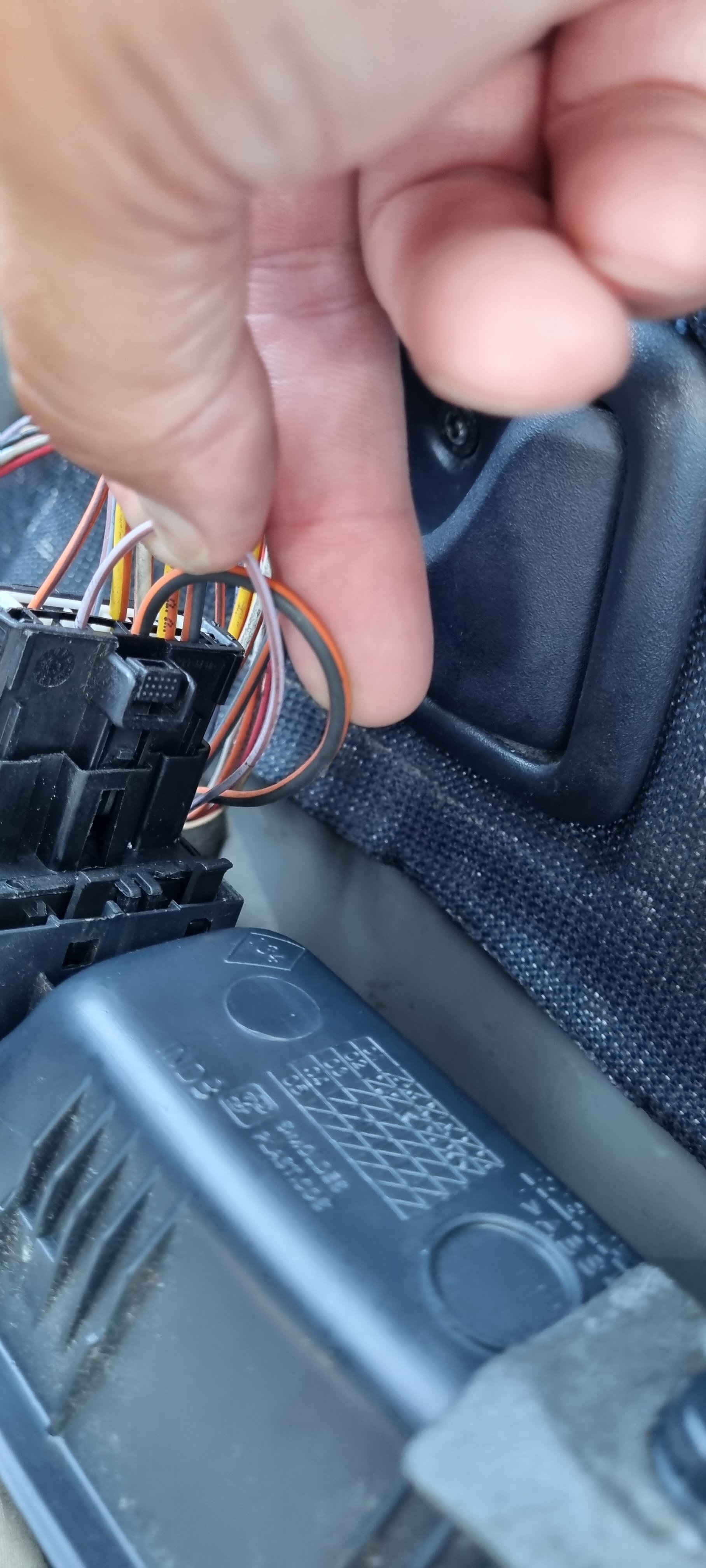

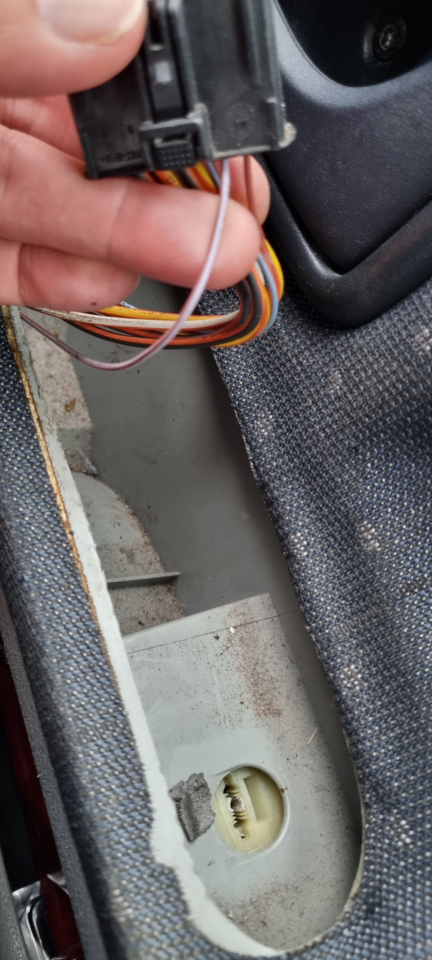

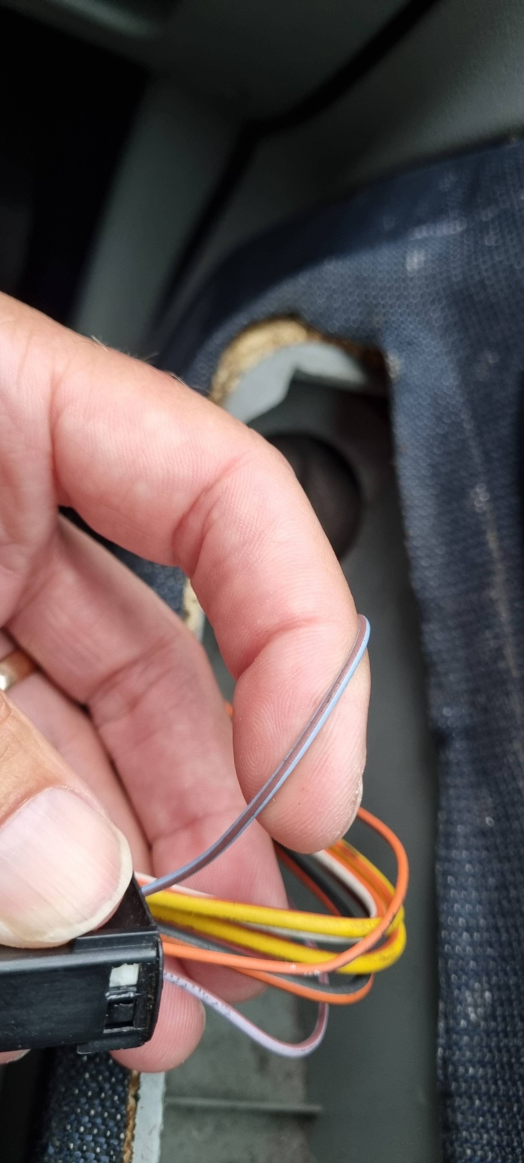

Hi sorry for the delay but here's the wires and the positioning in the plug (hope there're clear enough). When I tried jumping them again you could hear the uch and motor clicking several times. It's so frustrating as I don't won't to buy a second hand uch if I don't need one. Hopefully you can point me in the right direction

Okay so first I would check the switch.

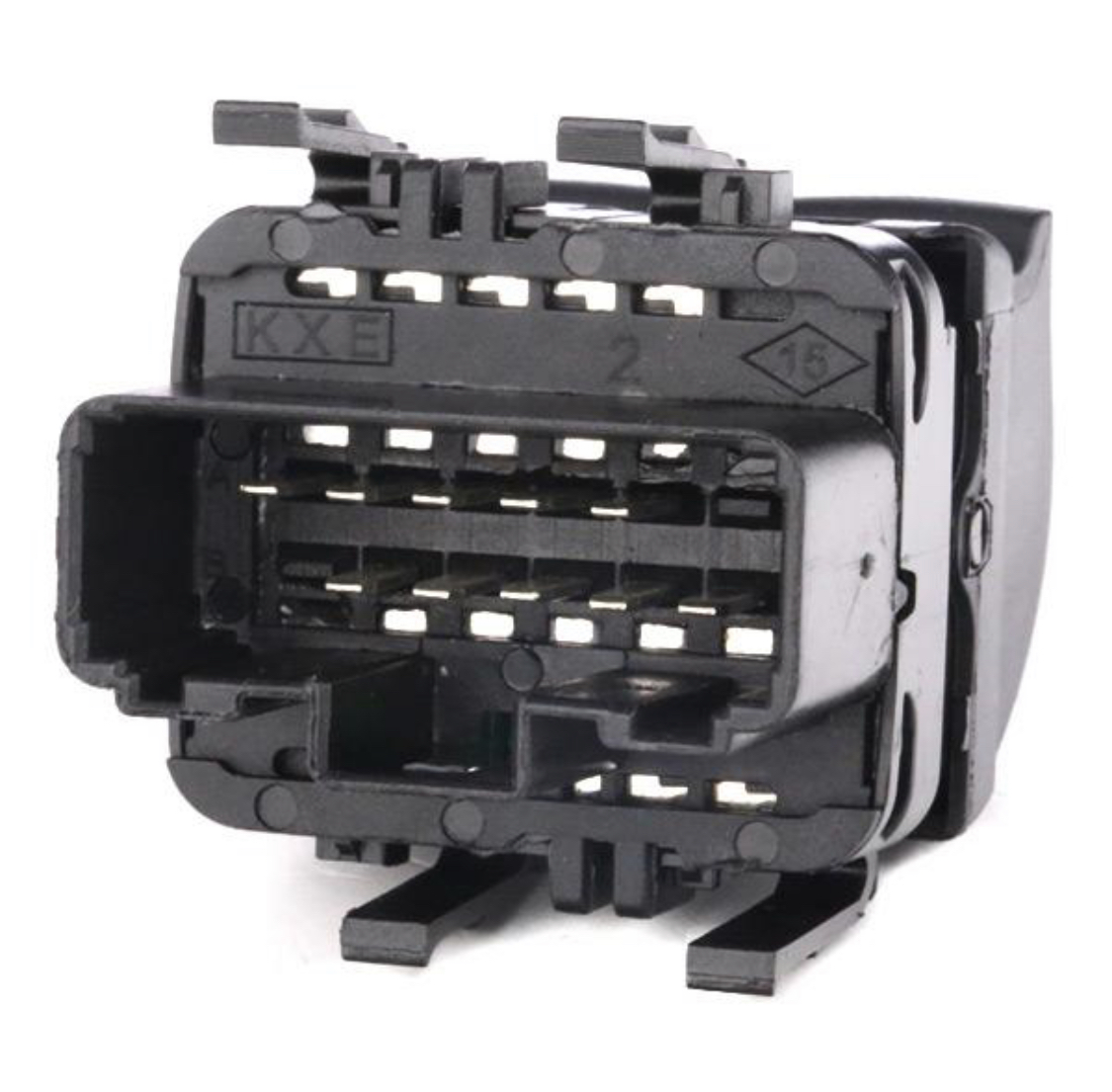

When you unplug the switch you should see something like this:
With 5 pins on the top (I’m gonna call them A1 - A5, from left to right) and 5 on the bottom (B1 - B5).
If we have the same switch you should get continuity between pins B3 and B4 when you press the button for the driver’s window up. If not, check all the other combinations of pins for continuity for "driver up". If you get this result, it‘s probably not a switch fault.
If you can‘t find 2 pins with continuity when you press "driver up", the switch is broken. In this case maybe a short circuit at the switch/connector could have broken your new one, but I‘m not sure.
If you do find these 2 pins:
Now you should look which wires connect to these pins (either B3 and B4 or your 2 pins). One should be a thick black/orange one (note that there are 2 wires that look similar, I mean the one with the darker grey/black) and the other should be a thin pink/purple one (the one you hold in the second image). If that‘s not the case, your connector is wired incorrectly. That’s an easy fix, but for that I‘d need more information.
If the wires are correct however, you should be able to jump these two to roll the window up.
So if you would tell me:
  • Do you get continuity between 2 pins when you press the driver window up? If so, which ones?
  • If so, which wires connect to these pins from the back?
  • If these wires are the ones I described, can you jump them to roll the window up?
  • If so, does it work consistently or do you still get the clicking?
From there I hope I can help you further.

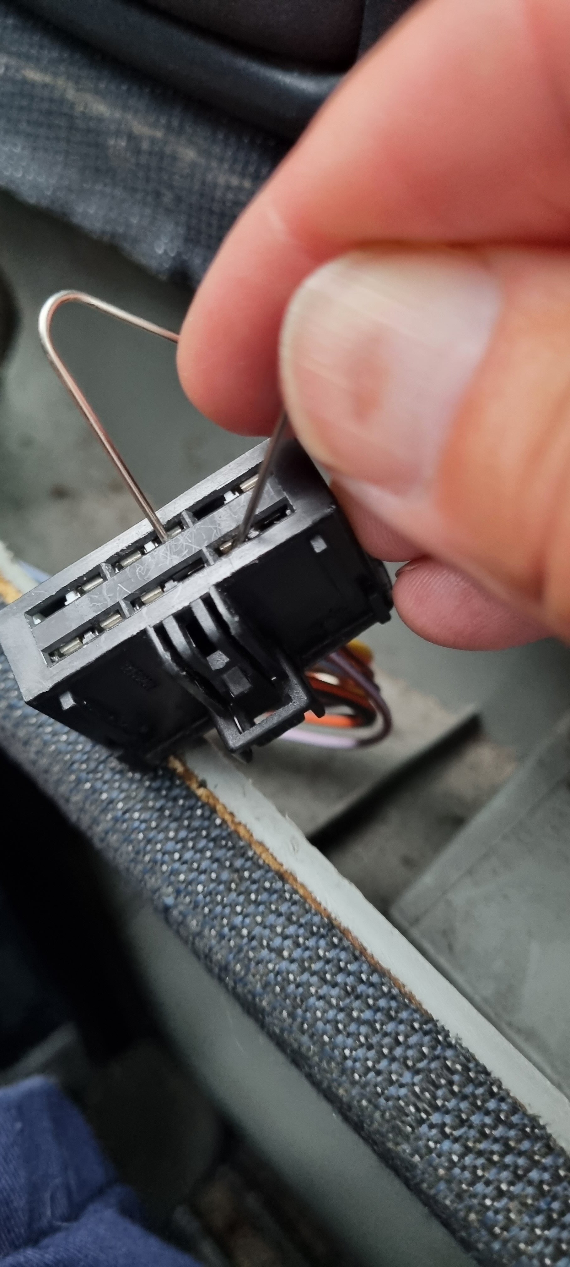

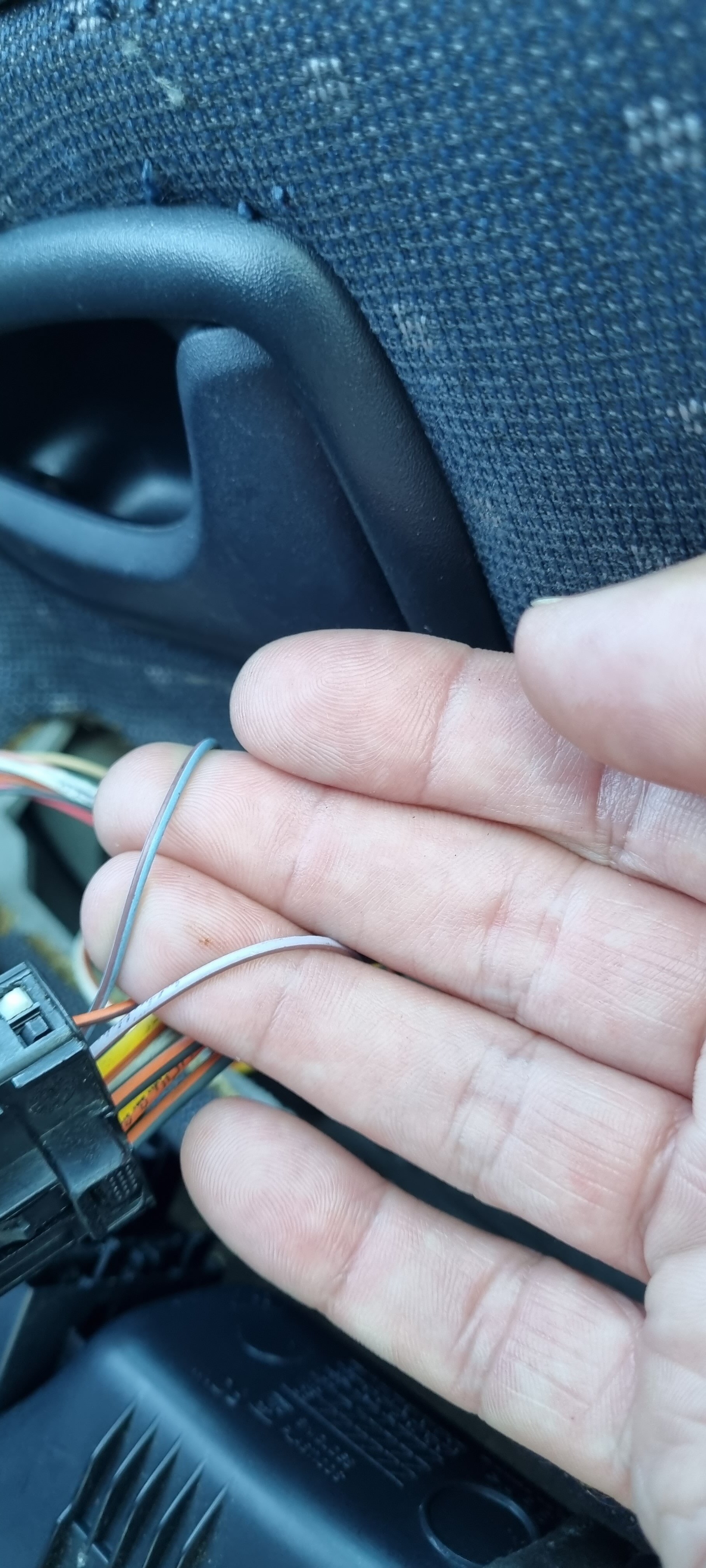

OK so this morning driving to work the uch started clicking for a while then stopped. With regards to your question I get continuity on B1 and B3 when I press drivers window up which is the thick black/orange and thin brown/ white. This doesn't get the window up when I jump them. To get the window up I have to jump B1 thin brown/white with A3 thin blue/brown. Also at one point I connected the switch to lower the window then unplugged the switch and the window went up by itself. Hope you can fathom this out because it's doing me in. Thanks

Ok so from what I can tell it should be the thick black/orange wire.
The thin brown/white is the 12V driver up live, the black/orange is connected to earth.
So it’s either a bad connection somewhere at the switch / connector (or at the door connector), a broken black/orange wire somewhere between switch and earth, or just bad contact where the wire is connected to the chassis.
You could also try connecting the thin brown/white wire directly to the chassis, that should roll up the window too. If that’s the case, you should definitely check the black/orange wire.
fyi the thin blue/brown is the live wire for the passenger side which oddly also has connection to earth (idk), which is why you can jump blue/brown and brown/white to roll the window up, but that’s not how it’s supposed to be used.

Hello jonah now I'm totally stumped. So I connected the thin blue/brown directly to earth but nothing I also connected the thick black/orange directly to earth but again nothing. So to get the window back up if I jump the thin brown/white and the thin blue/brown it doesn't work until I jump the thin brown/ white to the thick yellow/orange in A4 then put the jump wire back into the thin blue/brown. Confused yet? So I gave up but at the moment the window is working fine 🤷‍♂️. Had a bit of clicking from the uch too. Is the wiring loom knackered?

As I said, you should connect the thin brown/white to earth, not the thin blue/brown (that’s the passenger‘s live) and not the thick black/orange (that’s earth).
If that works fine, the fault lies somewhere in the thick brown/orange cable.

Hi jonah sorry I wrote it down wrong....I did connect the thin brown/white to earth but nothing. To get it up I have to jump the thin brown/white to the thick yellow/orange then to the thin blue/brown. It's like it resets it so the window comes up. Then it works for a little while before giving up after several clicks from the uch.

If that’s the case, I don’t really know what’s going on.
Maybe you could test if there’s continuity between the black/orange wire and earth, and if you get 12V on the white/brown wire.
Maybe that helps, but idk
