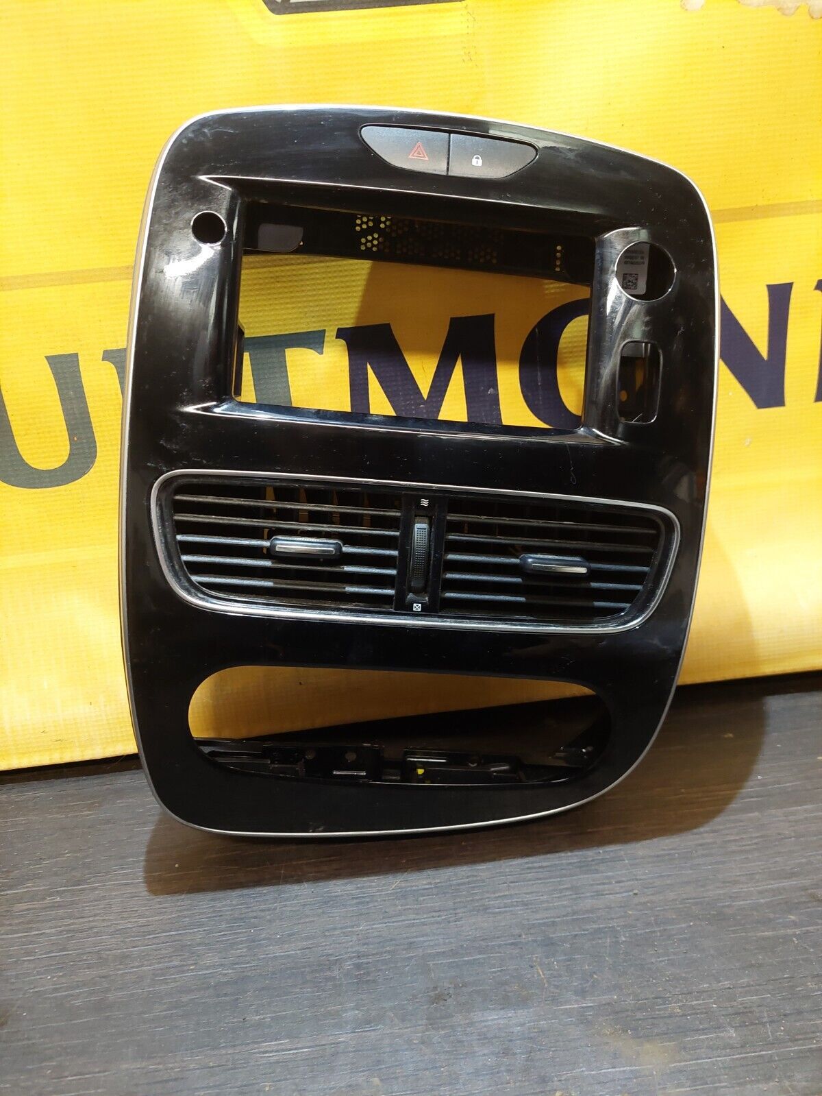

Hello all, I have just bought a 2015 Clio mk4 S Nav, the two air vents in the centre console part, one of them has missing flaps on the vent, can these be bought seperate or can you buy the whoe air vent as a replacemnt. Seen the whole centre console with vents but ideally don't want to buy the whole console. Thanks

You remove the full gloss black dash surround that surrounds the screen etc, and then you can remove the vents from that to replace if required, given its a 2015 though you could always get a ph2 2017> one for the nicer vent surround!
just need to make sure you get a climate control one, not a non climate control one (as all Dyn S have climate control im sure?!) - one pictured is non climate control

Proably cant get the vent parts, will probably hve to buy a new surround.
To get the surround off, its easy, grab to top right corner and pull and then do the same working your way around the surround. need to pull quite hard, dont worry it wont break.
