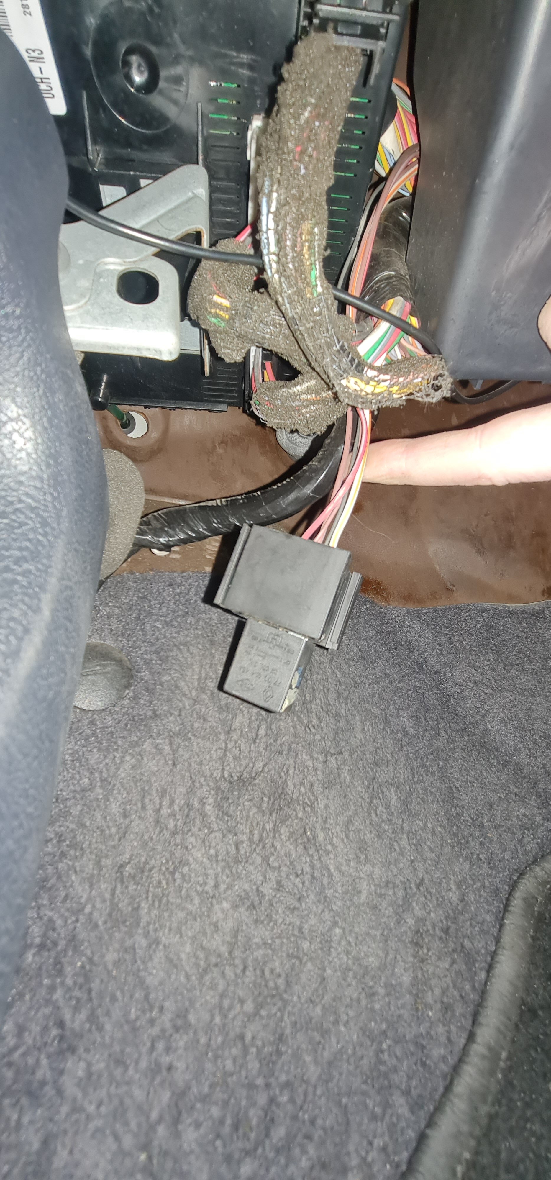

Clio sport 172 cup this cable is unplugged whats it for ?
Car  Clio sport 172 cup
Looks plugged in to me, just needs to be clipped into or onto something else is all
Ok cheers
