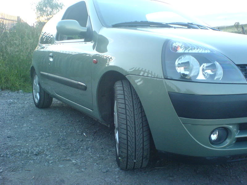

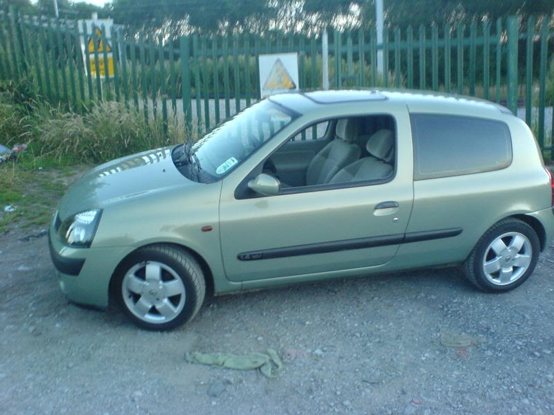

I got mine done for £190 looks loads better
Before:
After:
  K20 eg 217 whp.
yer that looks alot better ^^^
