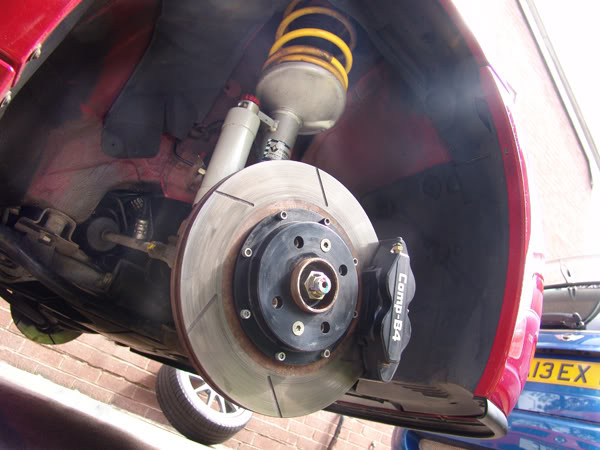

compbrake kit fitted pics
Car  VX220 Turbo
http://i18.photobucket.com/albums/b113/a13exf/compbrakelowres3withwheel.jpg

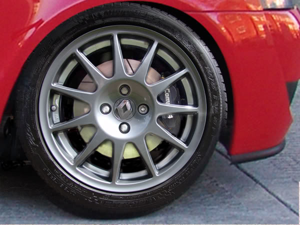

That bottom one is a photoshop, and not even a good one! The cheek of it.....
lol i know it is i took a pic of it while the wheel was on the axle stands looked a bit pants so thought i'd shop the bodywork back on it lol.
the rest of it is genuine though
Trophy 4x4 ride height ;)

How can you tell?
Its the vanes on the inside that determine the turning direction, not the grooves on the surface of the disc as shown on the pics.
Some manufacturers make discs with grooves that go either way depending upon what kit you bought.
The vanes between the disc should take air from the hub and throw it out of the top of the disc centrifugally, rather than try to scoop air in from the outside of the disc as it turns.
Hope that clears things.
They could still be on wrong, but it's just not possible to see from the pics
Daz
because with the power vane rotors they are designed to take air in through the inside of the disc outwards as they are not straight vained they are curved and for them to be fitted the right way the outer edge of the groove on the face of the disc should reach the caliper first

Are you sure, the damper in the first photo hasn't got any drainage holes and looks very new;)
Stick a pencil in the groove in the rotor at the top of the wheel.
If it points backwards towards the back of the car they are on correct.
Ignore the website technical picture that pic was 'borrowed' from another internet source ;)
correct
i think that the disc are a different design now so you cant go off the look without doing this test i think that the grooves are now cut the other way.
And to clarify 'groove' I mean in the curved vein bit in the centre of the rotor.
Dont think we have ever changed direction of the face groove as that is like its trademark ;)
