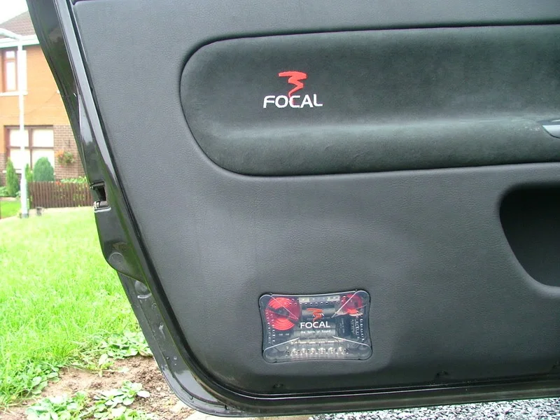

The trouble you face is getting round the fact that its very difficult to get wire into the doors, i've done this:
http://www.cliosport.net/forum/showpost.php?p=2113021&postcount=3
The other option is getting wire into the doors, theres a guide on here somewhere.
