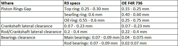

Just checking over my competition engine, what tolerance would you expect to see in the main bearings to crank?
Thanks
JamesBryan
0.040-0.075mm according to the specs i have.
@NorthloopCup has the spec sheet i think.

Thanks, I’m just at the upper limit, just under 3 thousands of inch in old money.

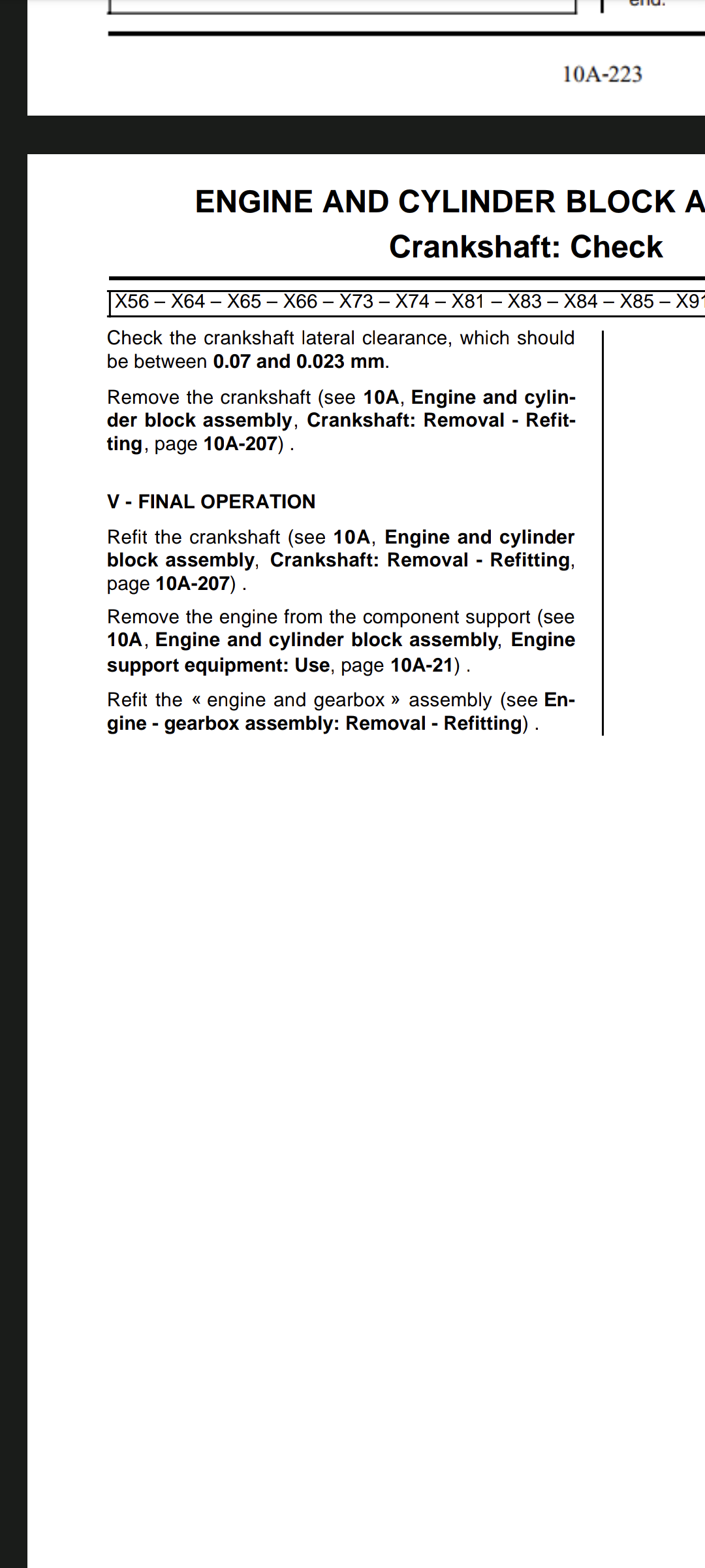

Yeah 3 thou is 0.076?
Thrust clearance on that list is wrong by the way, the upper limit should be 0.023mm not 0.23mm according to my Renault pdf.
That seems incredibly tight for thrust washer clearance if it is, especially on this size 4 cylinder. Most stuff is 0.1-0.4mm in this displacement?
0.023 wouldn't even leave enough for thermal expansion?

0.4 would be a bit lose, Ford Zetec is 0.09 - 0.260 but agree 0.023 looks like an error - perhaps it was supposed to be 0.07 - 0.230 which is more inline with the Zetec specs.
Wonder if anyone has built to 0.023 in the past and wondered why the crank didn't turn 🤦‍♂️
*Edit sorry saw James said it was a typo.
