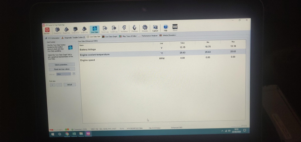

Took the 182 out of the garage yesterday (first mistake lol) no problems at all and parked on the driveway ready to take it out. Got back in the car and it just cranks over endlessly. I did wiggle the TDC sensor wiring whilst the gf cranked it and it did fire into life and ran absolutely fine. Turned it off and thought I'd reassemble / just clean the relays whilst I was there. Now doesn't start again and can't replicate the wire wiggling.
What I've done /noted -
•Immobiliser light turns off as normal - also tried the spare key just in case.
•Fuel pump primes with ignition - can also manually engage the relay with the RsTuner - relay clicks and pump runs
•TDC sensor removed and cleaned with WD40 - no change (still running the original sensor and wiring loom)
•Engine speed doesn't move from 0 rpm when cranking - checking with live data on RsTuner
Anything else to try before I bite the somewhat expensive bullet of a genuine TDC sensor and loom?

Sounds like CS if there’s no rpm on crank?
Stick it in the freezer for half hour and see if it works intermittently on Rs tuner
Amos91
Honorary Member
Surely that makes sense as there's no engine speed detected so the engine doesn't know when to spark. You're essentially not cranking the engine (when you are) or so the engine thinks
Indeed! I just thought the coil pack should still receive a 12v supply with ignition on which is then earthed by the ECU if it wants to make a spark.
New genuine CPS coming today and I'll also have a look at the earth's. The top gearbox one looked fine from my quick check of it.

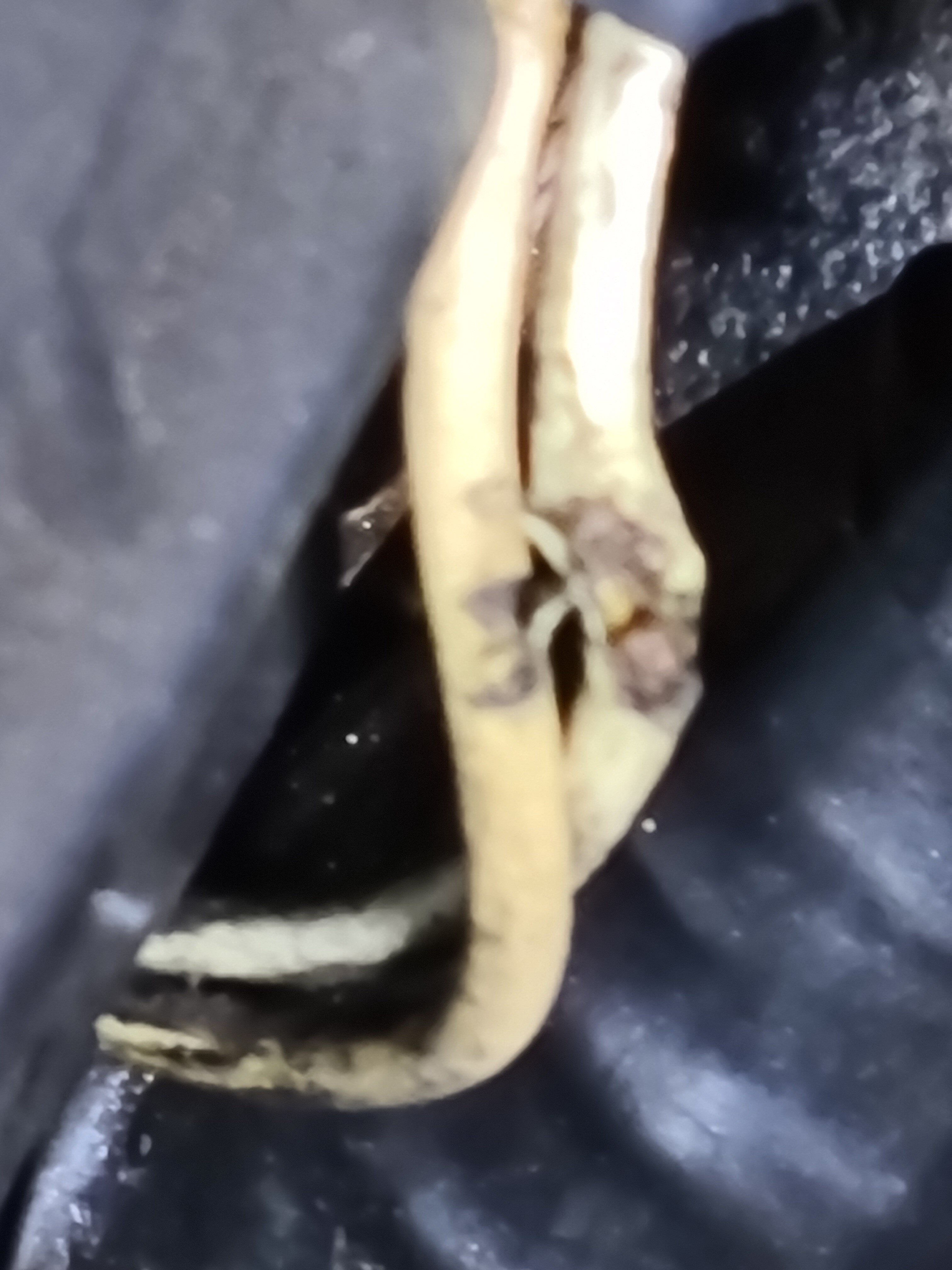

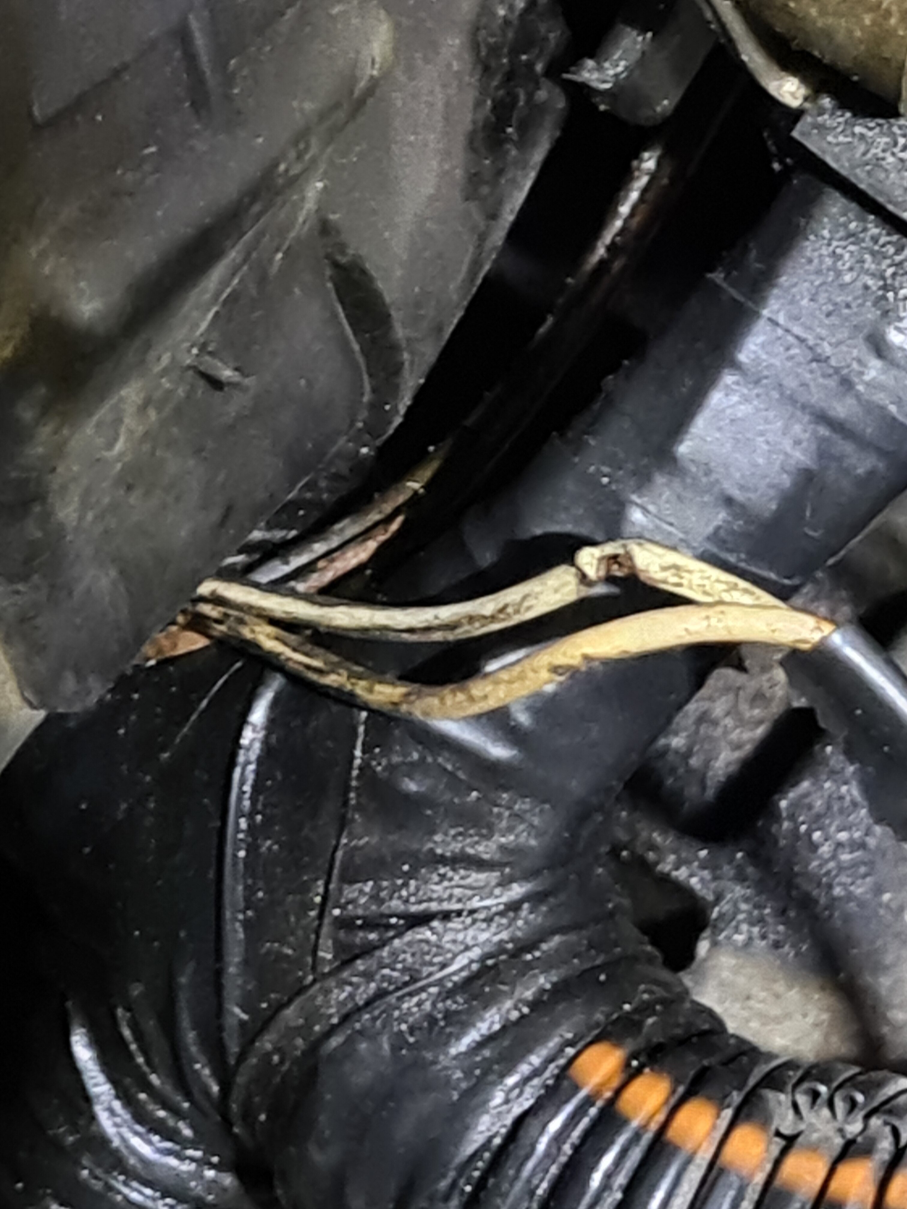

Hello mate, I have purchased a genuine renault loom to fix this, is it just a case of snipping the old connector off, cut the wires both ends to have some.metal to play with, wind together and cover with these plastic tube things, heat up to spring/seal?
Apologies not done this before and don't want to bodge any worse than it already is, I've attached a pic of the remaining wire also

jameswrx
Best to solder it if you can. Or get some of those solder connectors they sell these days that have solder built in. You can use a lighter on them.
Yeah that's it. Put the sleeve on one wire, then join the two cables by twisting together, after that slide the sleeve back over so the solder middle is over the join. It's a bit fiddly due to location.
Go YouTube and search for solder sleeve and you will find some guides.
That's exactly what Renault supply with them.

Ah right, sure I’ve got one somewhere. Didn’t think there were any connectors in the pack, will have to check.
  Clio 172 2001
Thanks guys, got it successfully installed today using the sleeves and a heat gun and now the car starts again.
