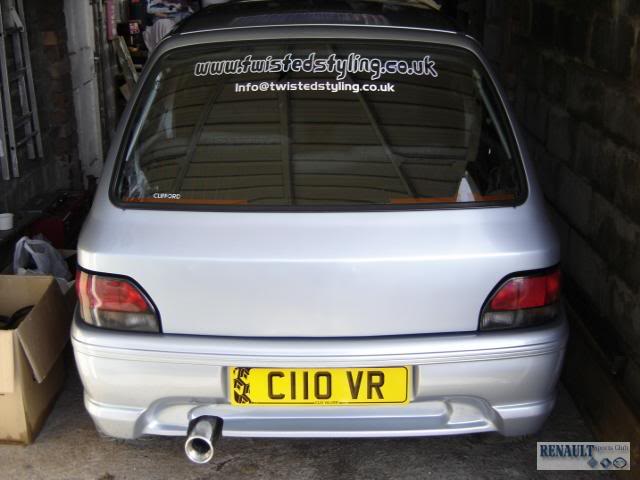

I prefer them fully smoothed off and then some, like mine ;)
