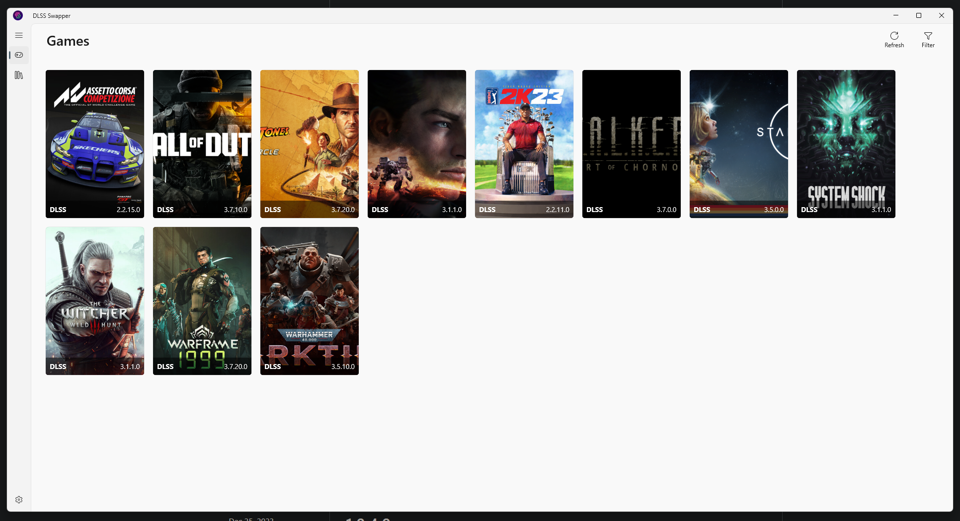

Not sure of the 'true' benefits of this, but thought I'd give it a go.
So, some studios leave their existing DLSS support in limbo, despite updating and patching the game that uses it. Some people report significant improvements within games that support DLSS and of the games I've tried it with - I've had no issues.
My DLSS supported library when opened, looked like the below. Look how old the setting for ACC is, when the latest release is 3.8.10.0.

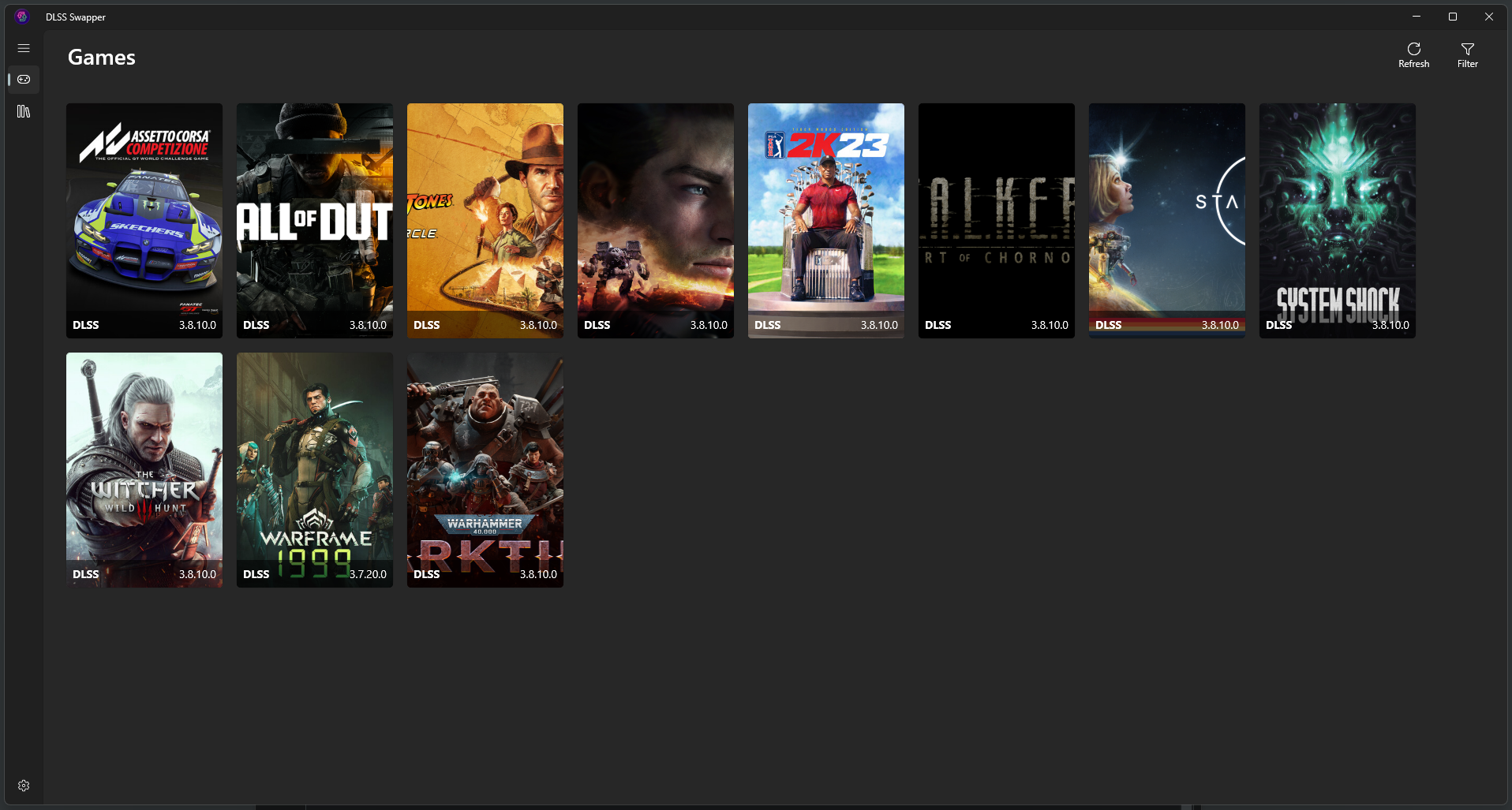

Downloaded 3.8.10.0 within the Library of the DLSS Swapper itself and updated them all. As said, no issues yet - but they do warn that potentially some multiplayer anti-cheat software, might get twitchy with it? As such, I've left Warframe alone for now - plus it wasn't that far behind to begin with.
