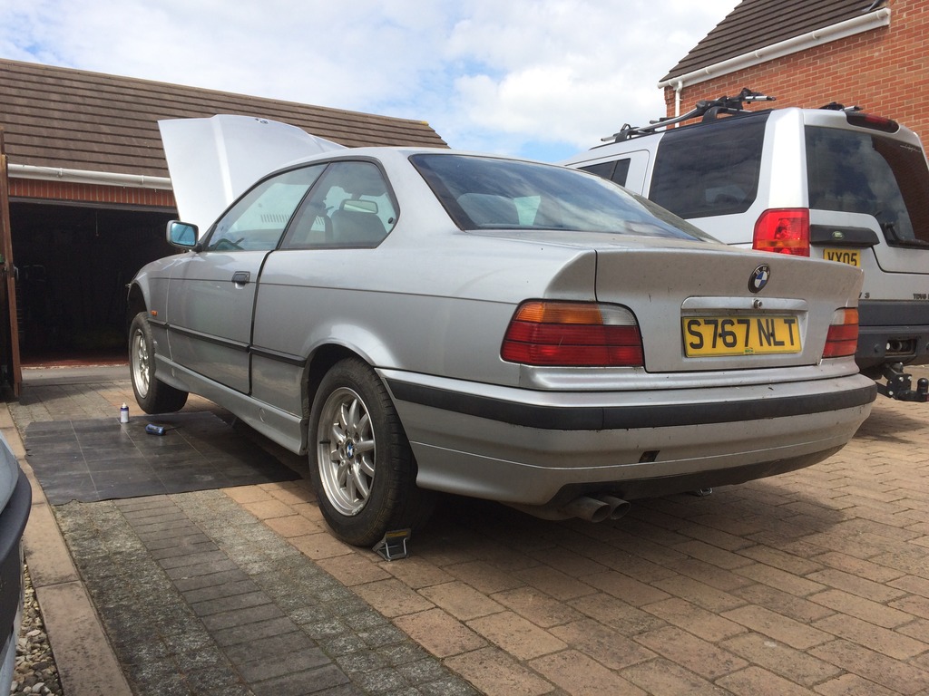

But basically, me and my step dad are off to the Nurburgring in 8 weeks (17th September). The current car list on the drive way is my Clio and his Corsa. Would love to take the Clio. His Corsa as only one seat, plus he never keeps a car for longer than a few months! So he has bought an E36 328ci to take - he wanted something old(ish), 6 cylinder and RWD - only choice was a BMW! My friend had his old one for sale

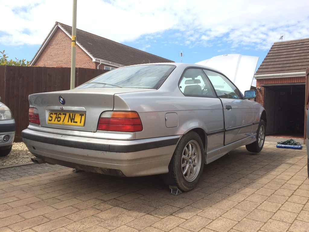

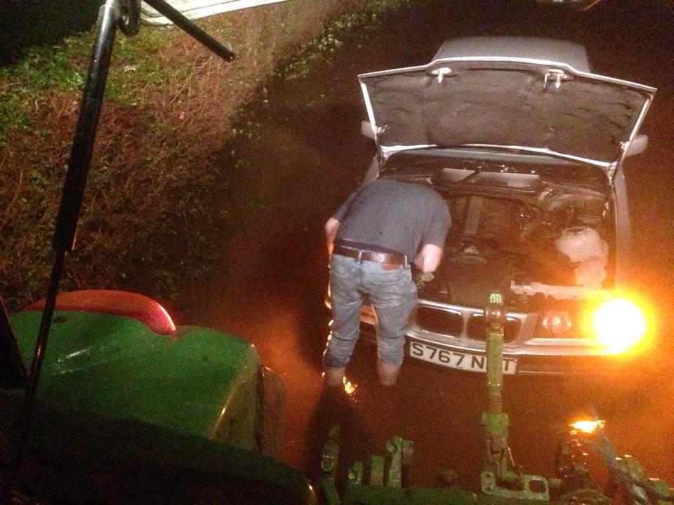

Looks nice.....however this is what happened the last time he took it out.
Yes that is a flooded road - muppet. That was over 2 years ago. It has been stood in a shed ever since (he bought an E21 and I think that took priority over a broken E36).

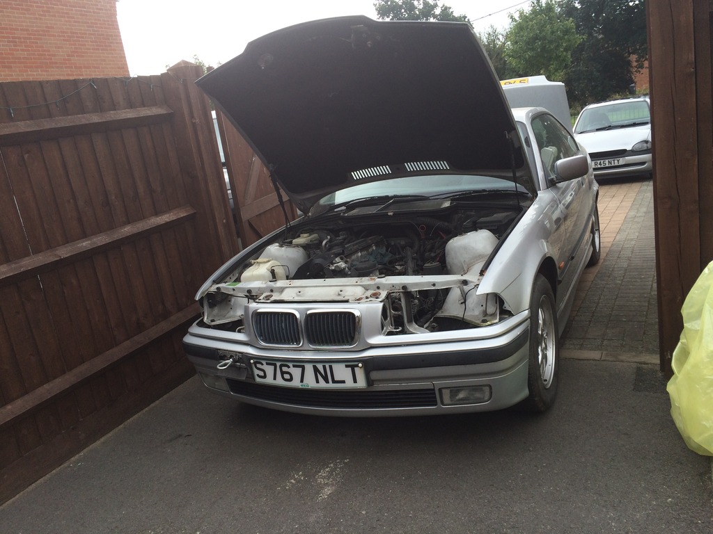

Told my step dad about this and he went and bought it. It has a solid shell, interior is "perfect" as it isn't nice leather to feel guilty ripping it out. Just needed an engine. Mother was not happy as they went away to Paignton the other week, little did she know there was an engine for sale in Paignton! So bought that, got it home and then the fun started.

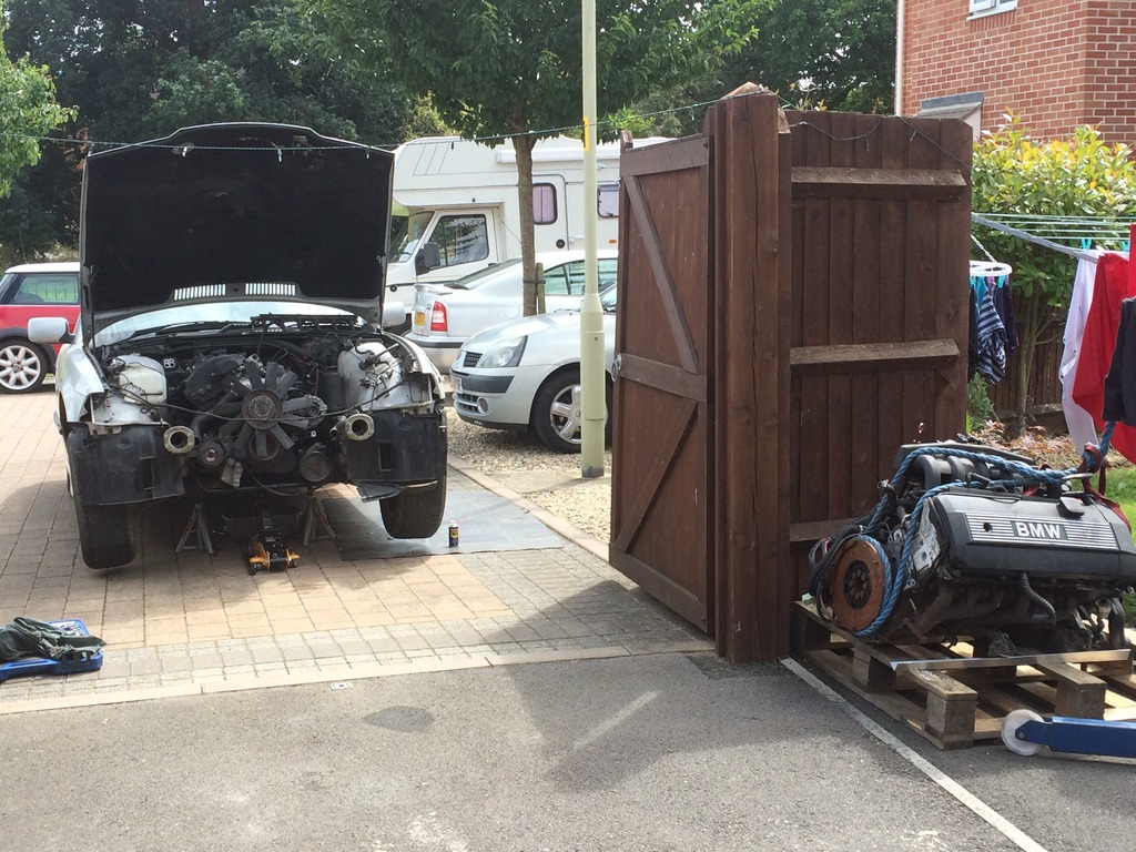

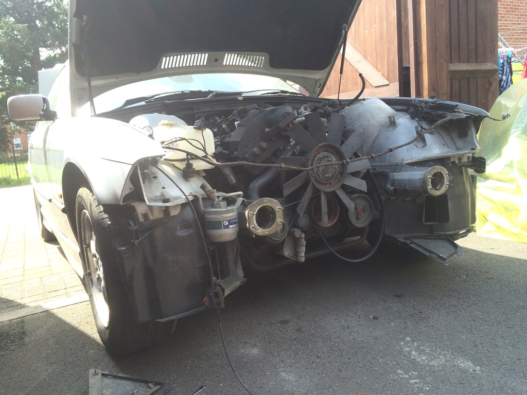

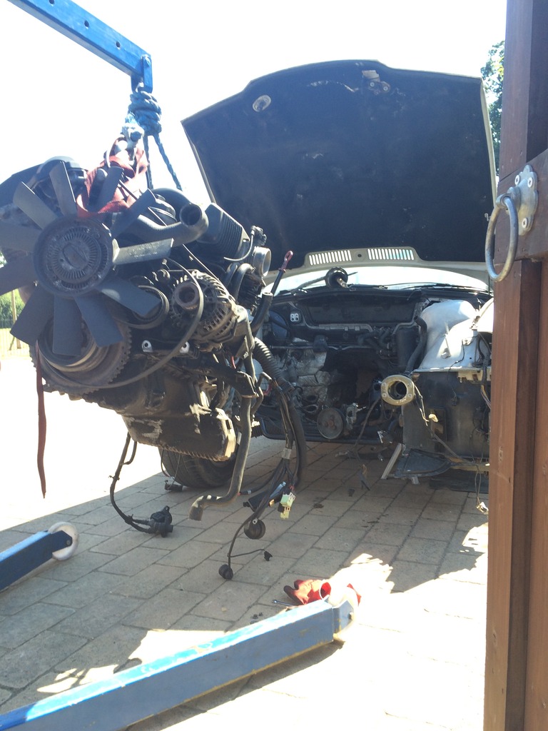

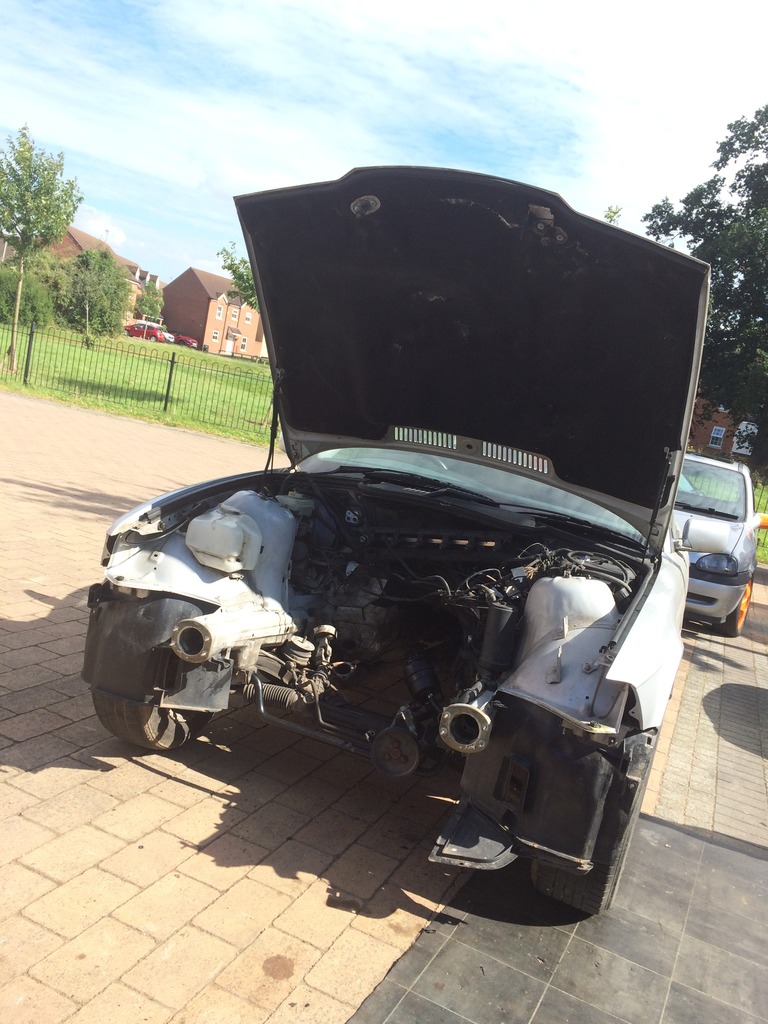

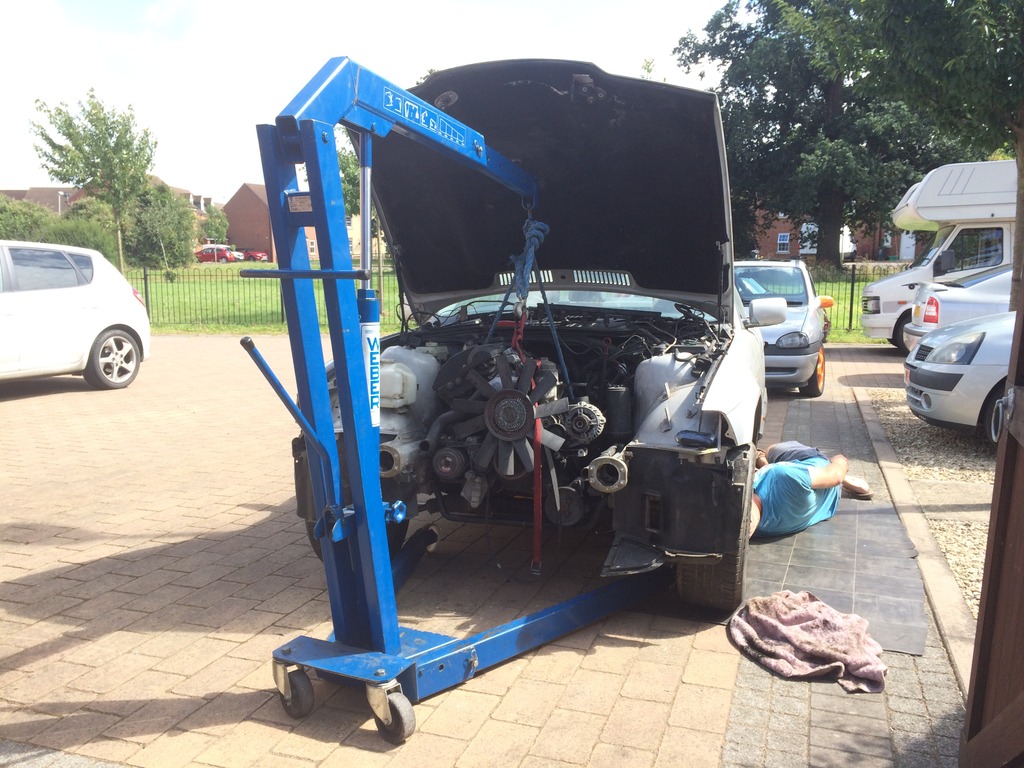

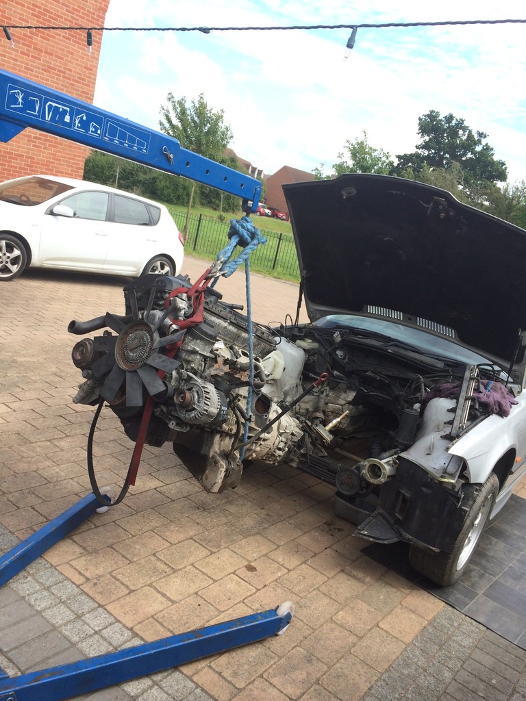

As I don't live at home in the week we have to sort of plan the larger jobs out as my step dad can tinker mid-week on his own. First job - remove the old engine. Did that this Saturday. Very easy and little effort to remove. Really simple as the whole front of the car can be removed so you don't have to lift it over the slam pannel.

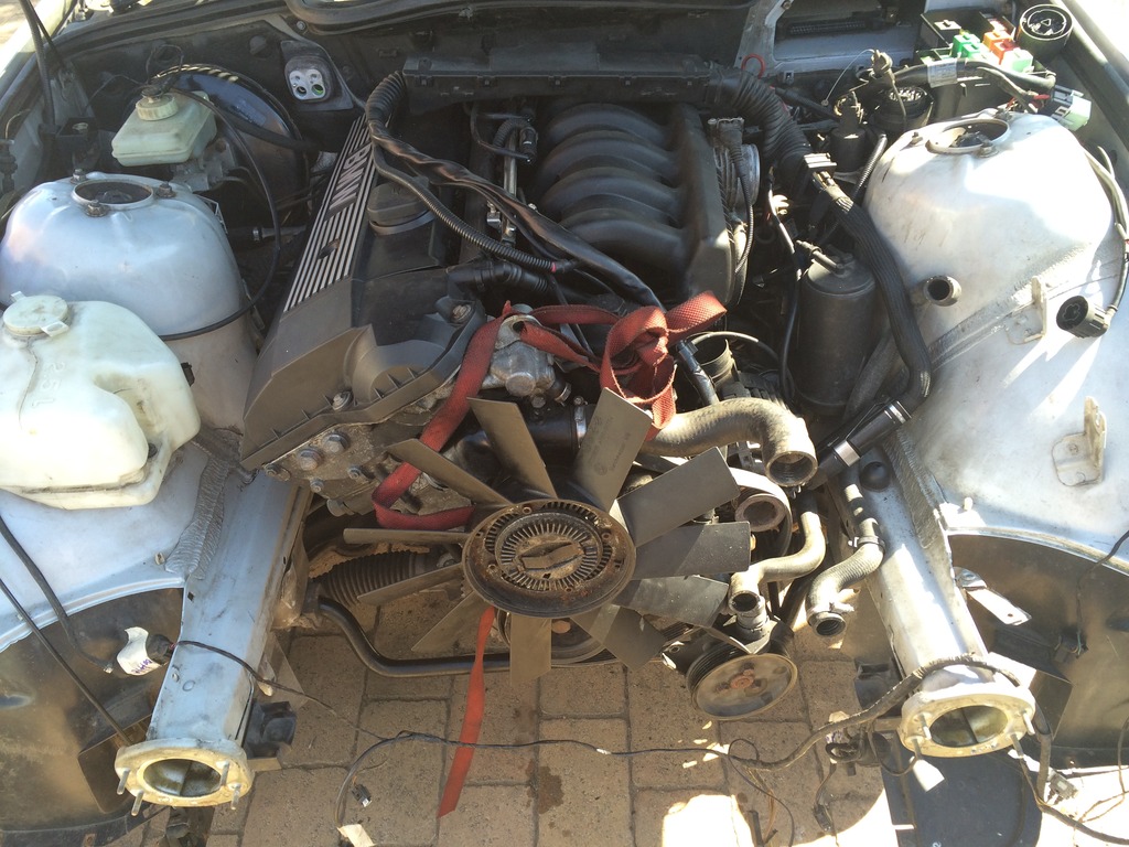

So bit more progress on this. New engine is in. Was really easy to do once we got our heads around the starter motor as the loom on the engine and car were slightly different but did the same thing - just joined up differently half way down the loom.

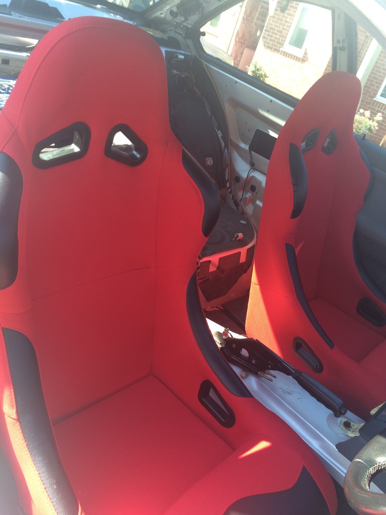

Other things have been done like the seats. Red this time! Rest of the interior is out, just need to sort the front foot wells out as they are not level and there is like plastic tray which is only going to get broken when stood on - the carpet protected it before.

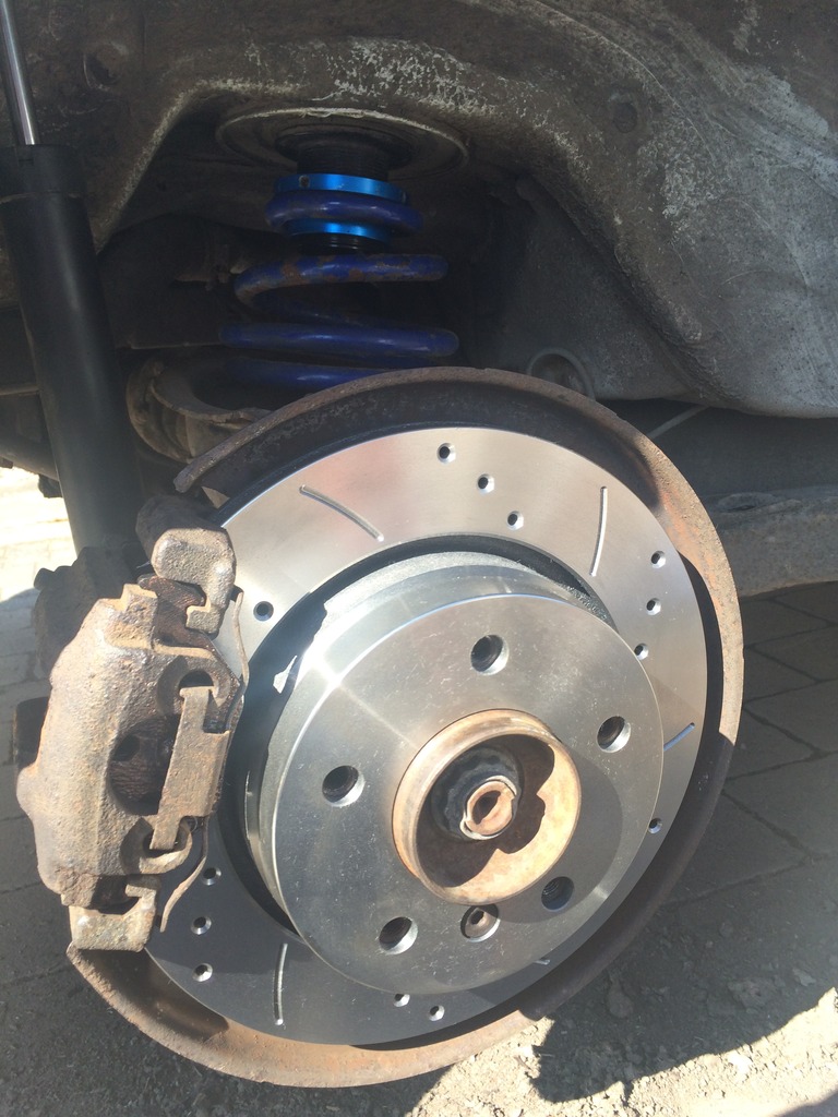

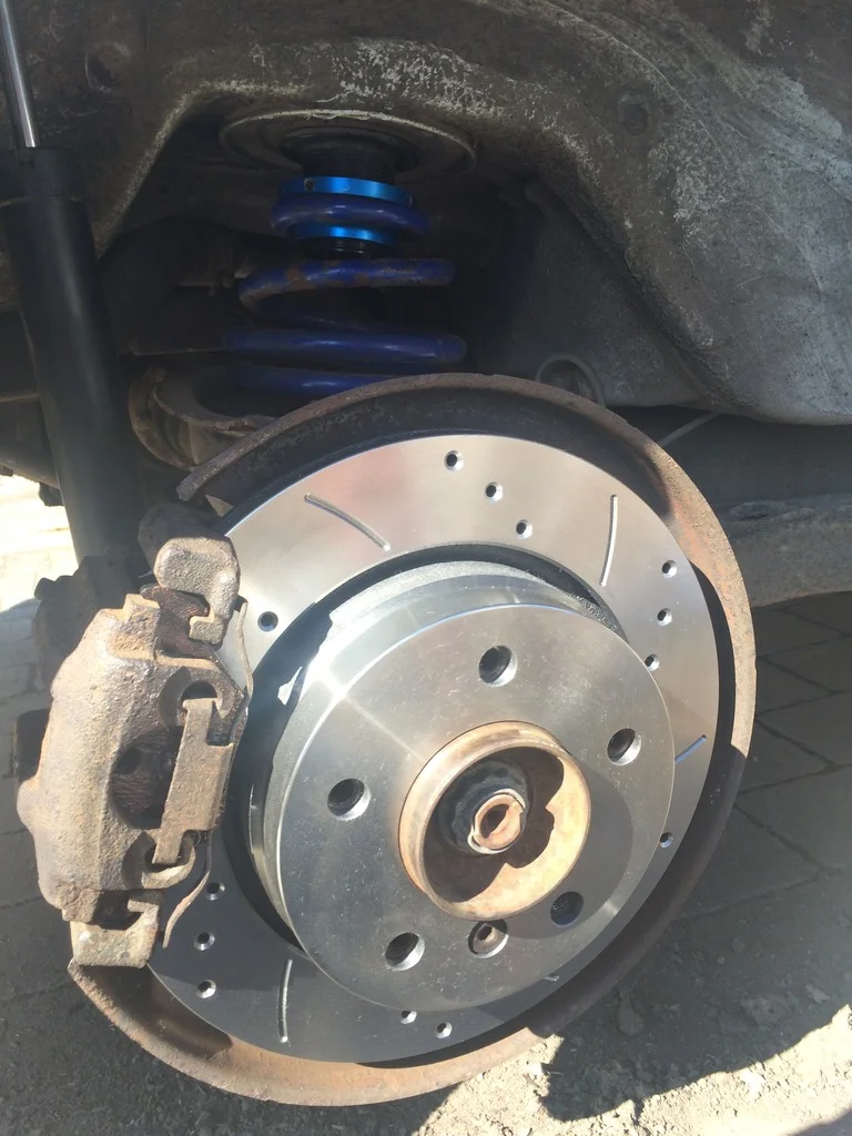

Car came with some AP coil overs and rear dampers. Helped to put the rears on today and my step dad did a front corner the other day, so it sits slightly funny atm! But while the wheels were off the brakes were changed, hence why he only did one corner as he had a bit of a fight with one bolt that would come undone. First time ever my step dad has seen disc and drum brakes on the rear of a car - it looks like the hand brake operates brake shoes and not the calipers.

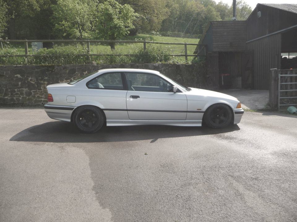

Engine in. Seats and harnesses in. Brakes fitted. Suspension on, just needs tracking, Team Dynamics Imola wheels fitted. All looks smart.

Car currently sits a little higher than that first picture now, wanted it a little more practical than just slammed.

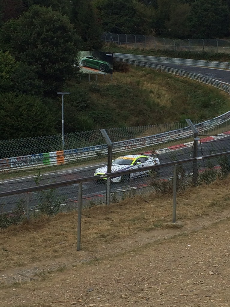

Watch some endurance racing today. Everything was proper smooth around the track and there was no "racing", probably because they didn't want to risk a crash!
Weirdest thing I saw was the Jeep Cherokee safety/recovery car towing a TT at speed on the racing line while other cars were racing around it. DAFUQ??!! Mental
Track was open 5:30 to 7 this evening for the public. When it opened it was carnage! I though Combe action days were mad, but this was unreal. However, the track was open about 45mins and some Brit binned it. Not sure what happened but his Supra had damage to the near side wing, rear bumper and front head lamp. And they shut it for the rest of the evening. So no track action today. Tomorrow it is open all day so hopefully get two laps in each.

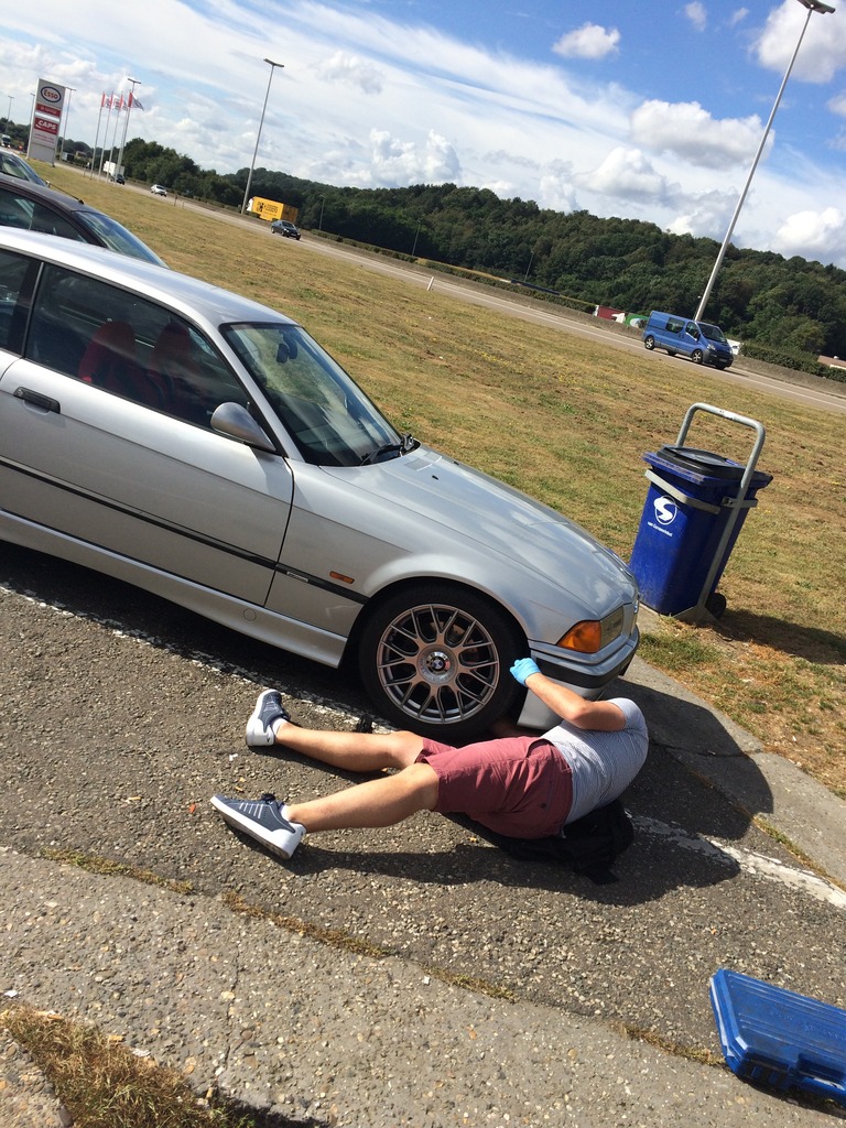

Making some tracking adjustment in Belgium on the side of the road. The only thing to go "wrong" on the whole trip. Car was faultless

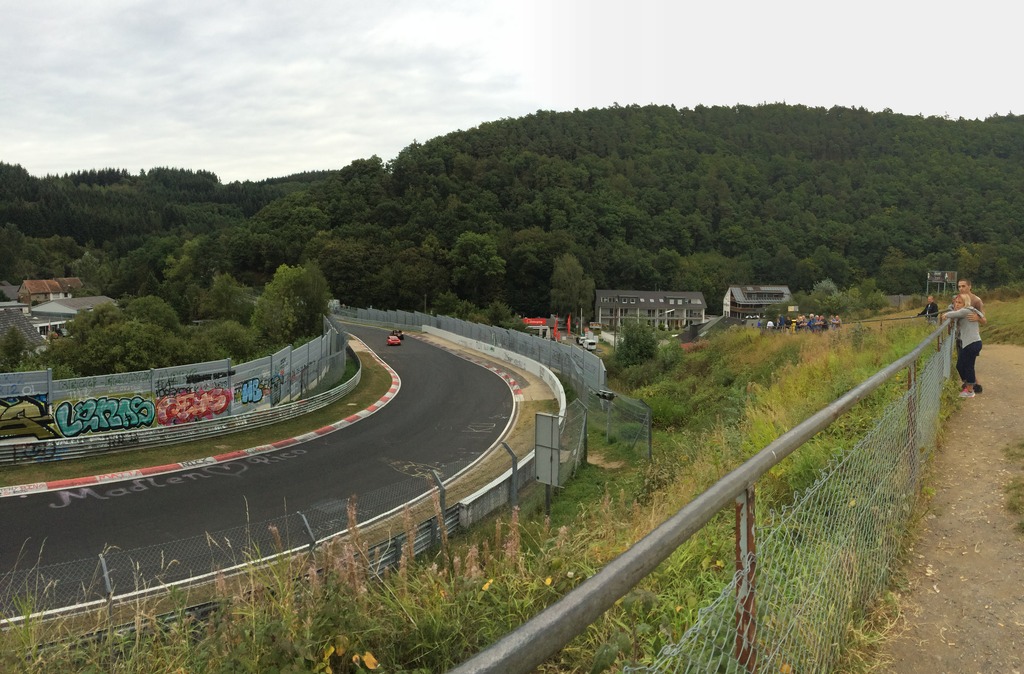

First thing I saw at the side of the track....
Stayed at the Hotel De Nordschlief, which is in the background of the picture. The cars woke me up on the Saturday morning!!
Just a few Lamboghinis.....

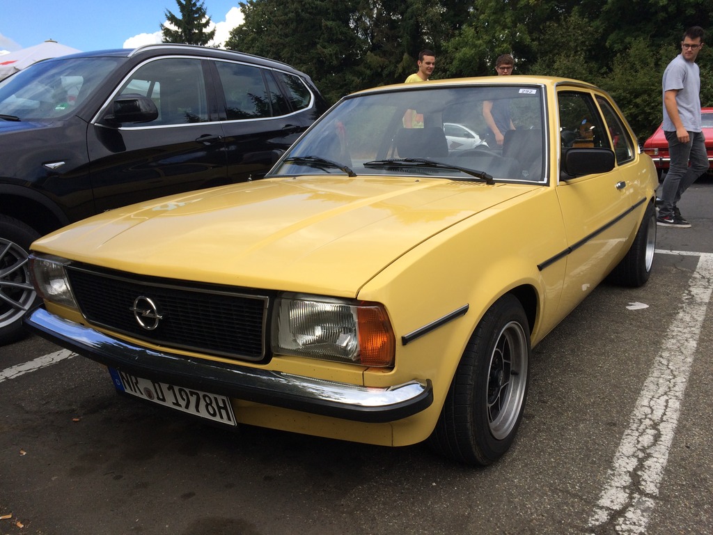

Some other cars kicking about
Some track shots

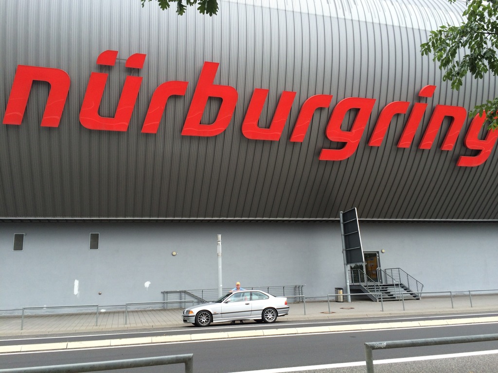

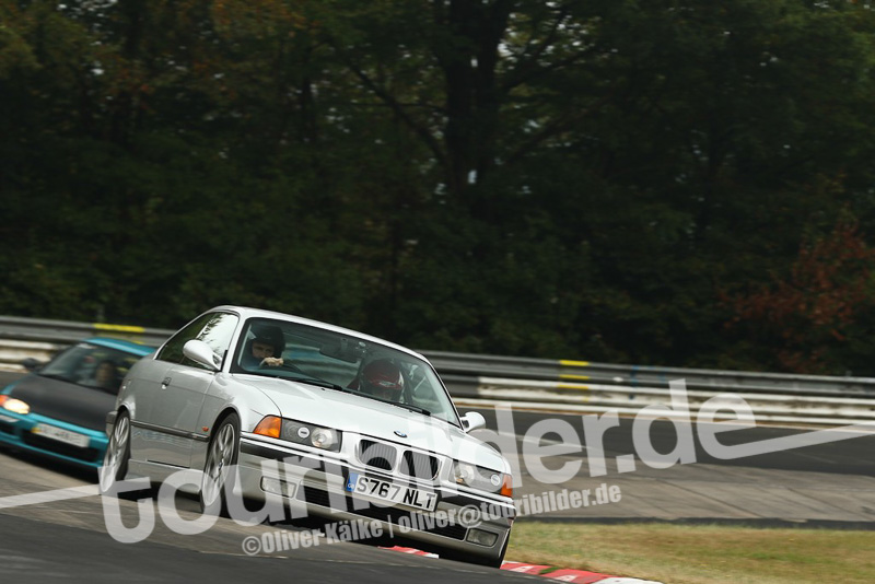

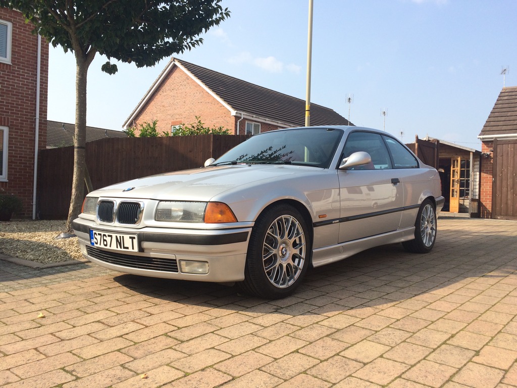

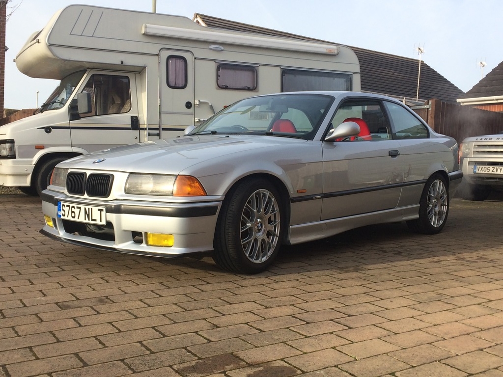

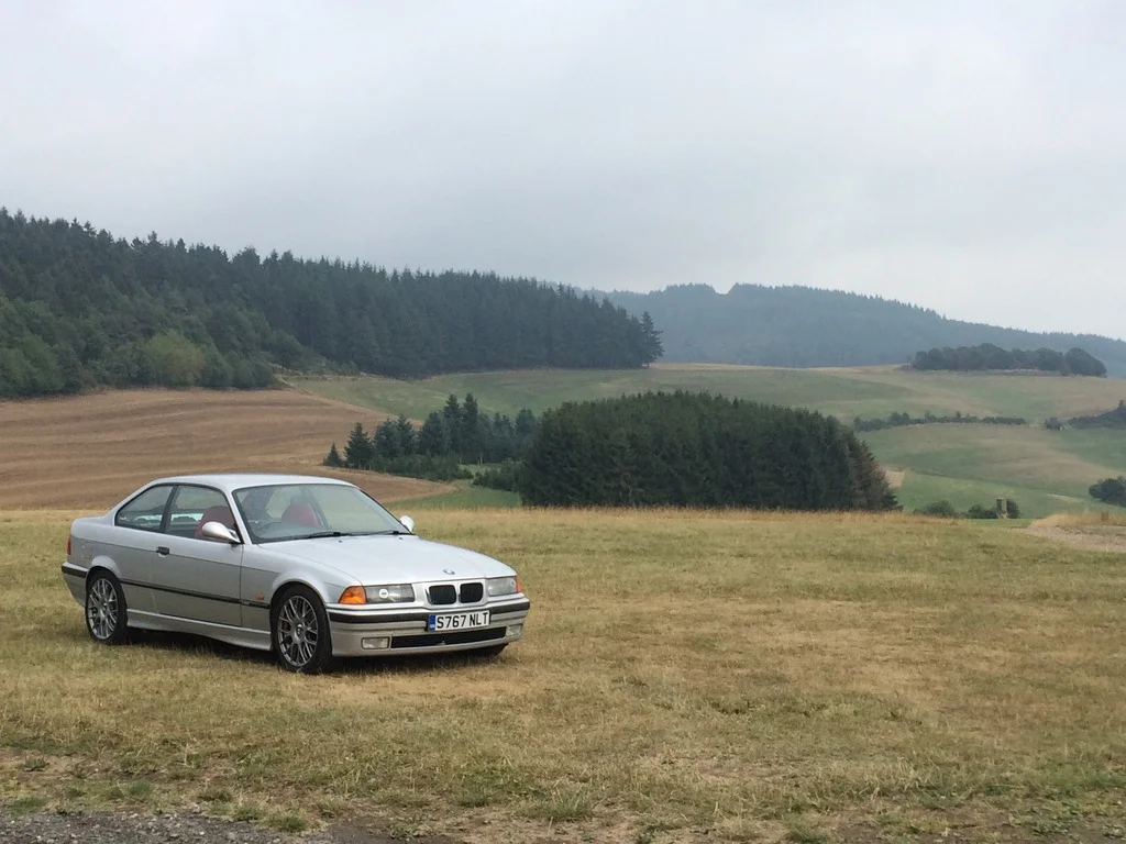

Then the standard pictures of our BMW
The car was really good, so easy to drive! I wasn't sure what I was expecting (probably some tail happy drift car!) but it was perfect. Got some ideas for what to do with it next. Then take it on another track day, most likely I'll take my Clio and step dad this. All in a good weekend.
Driving around the track was the hardest drive I have ever done! So much concentration, not knowing where I am going, not sure if I hit an apex. Blind crests, avoiding bikes and cars. Would like to do it again though, next year.......

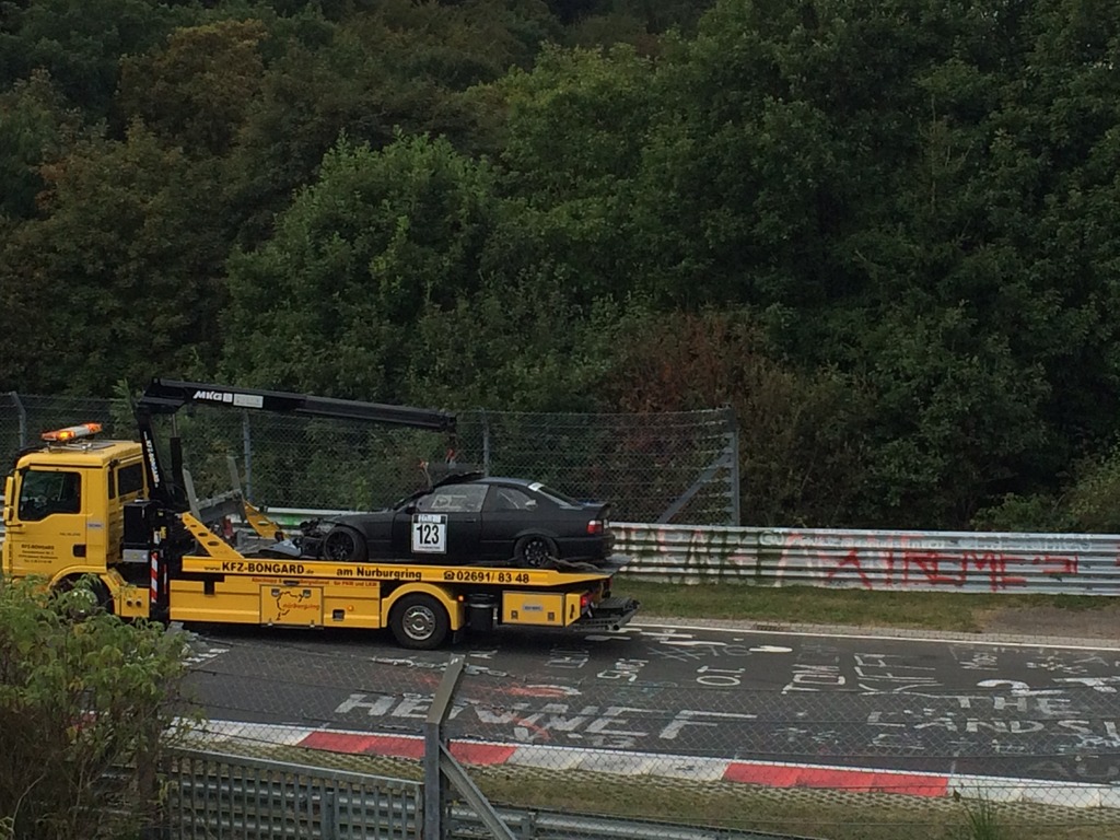

Oh and the "best" crash was when I was driving I had a section under yellows as the Ring Taxi was in the barrier! Literally no idea, and the car must have been snuck off the track as we didn't see it on the back of a truck, but did see a recovery lorry with a box on the back and not the usual flat bed.... All passengers were out of the car and no one looked injured.

Now with M-Sport front bumper (minus a mesh bit in the lower grill)
