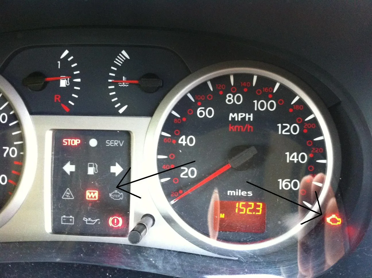

Hi guys was just driving along when my engine management light and electric fault light came on, my car suddenly started to drive sluggish and wouldnt rev much, was as if it went into get home mode? anyone know what is wrong or what to do to sort it ive attatched a pic of the fault light
