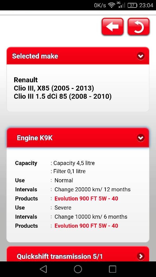

Can't find this type of oil, specific one, does anyone seen that sort ever?

Is it possible that this has replaced it in the last 10 years?
Certainly myself and hundred of others use it for daily and track use with no ill effects. My 120k engine was in remarkably decent nick when I opened it up.

Yep, looks like it have been changed something, rebranding... Would you recon FT and RN tech oil have a similar specifications?

Yeah, it's not gonna be worse anyway. It's what renault specify for tons of their cars now, with stupidly long service intervals too. Much longer than they used to be and the biggest reason for that increase is oil technology advances.
