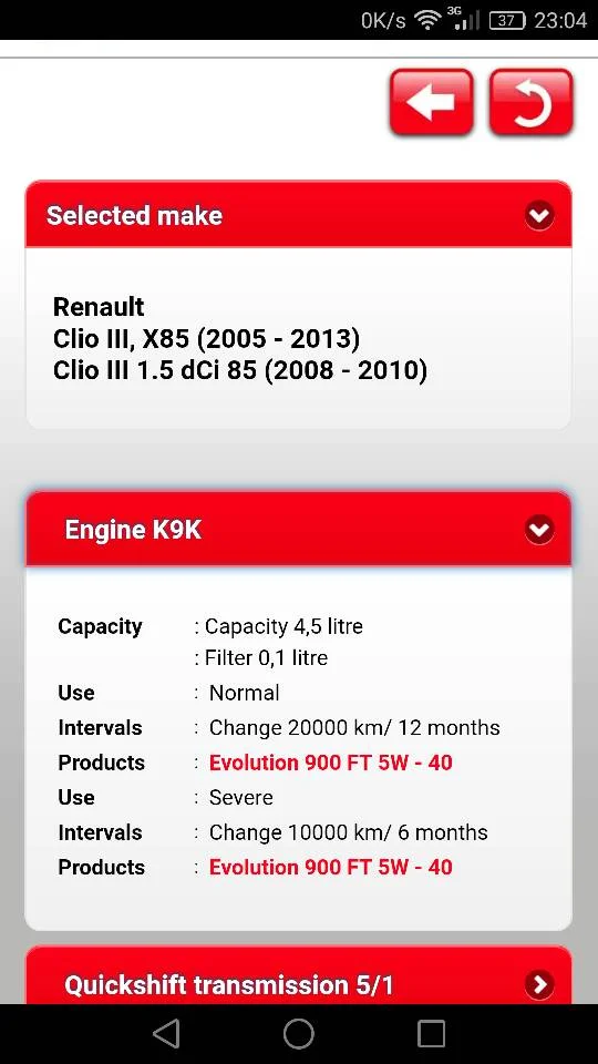

Anyone know where that kind of elf oil available, lads? It's not on ebay, gumtree or amazon. The Total company not sell that FT spec oil (recommended for k9k 766 59reg). Awful. Thanks in advance.

Thanks, hipwell. I m in doubt a bit, have ordered oil filter on autodoc, but still not sure what oil to use. Rn tech, nf, sxr or ft. Just have a car a few weeks only. Discovering Renault )

RN tech is SXR, its just revised. It's the same stuff with a different name.
That's for the sport models though. Having a look online, the DCI does use 5w/40 fully synthetic as well though.
