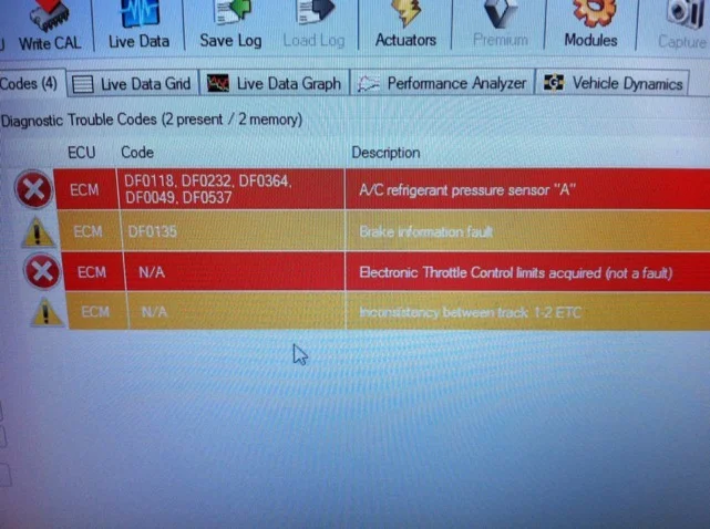

Stuck the RS Tuner on and no fault came up related to it only "Inconsistency between track 1-2 ETC" and "Electronic Throttle Control limits acquired (not a fault)"
Cleared the light off anyhow, but what the hell are those two ^ lol
Cheers Henk.
This is what I got when I plugged in a few months ago.

Just plugged the RS Tuner back in to see if it fires up a fault relating to the car idling at about 2500 and revs wont drop unless the clutch is at biting point :S
Still have that "Inconsistency between track 1-2 ETC" and "Electronic Throttle Control limits acquired (not a fault)"
As shown in pic :rolleyes:
Haven't got round to cleaning the throttle body yet but in the meantime is there anything else I can plan to get checked out while I'm at it?
What the hell are those two ^ lol
Still get these on my RS tuner when I plug it in, even no no lights on dash - won't go away :S
